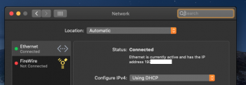

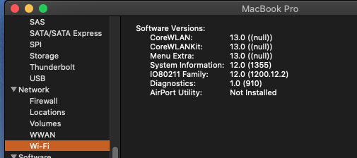

WiFi Issues on Catalina Dev Beta 5
I just installed Catalina Dev Beta 5 on an Unsupported MacBookPro5,3.
My current issue is that on my System Preferences | Network, my wifi option does not show, so I can't select it.
Used @dosdude1's macOS Catalina Patcher 1.0.6 to install and patch.
Appreciate any help and/or response.
Reactions: TimothyR734

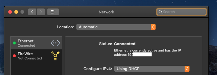

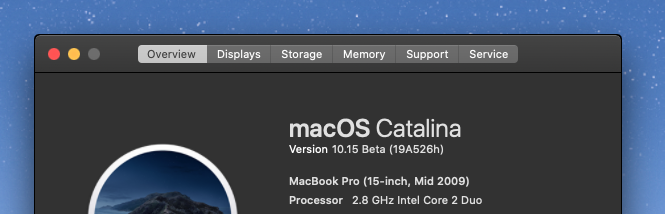

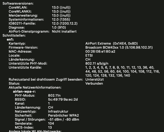

WIFI is working well here (MBP5,2, 10.15.0 DP5 installed "To This Machine" with patcher 1.0.6).

I have the same problem as you and i also like Some help with it, i went back to Mojave and it works again
Was the Legacy WiFi patch applied? That should take care of it.
Yes iT was also in catalina and again in usb programma iT is rare because in the installer from Mojave the WiFi icon is visible but not in the catalina installer i have iMac 8,1 Mojave works great so i do not get it

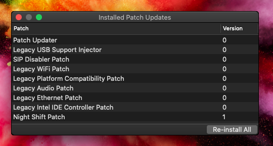

I sure did apply the "Legacy WiFi patch".
These are the patches I applied to on this MacBookPro5,3.
Not showing but I also applied the "APFS Patch" which I believe is required to boot.
Also ran the "force Cache Rebuild" before rebooting.
Thank You @dosdude1 for your apps/tools and overall help.
