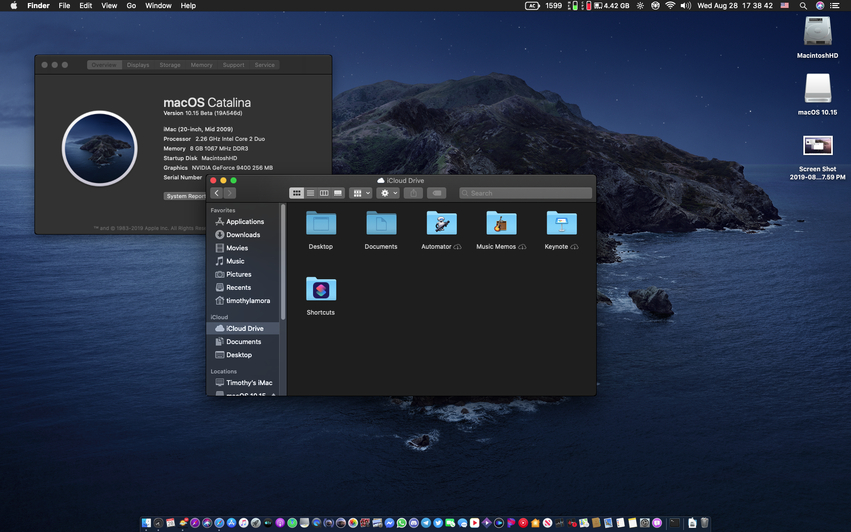

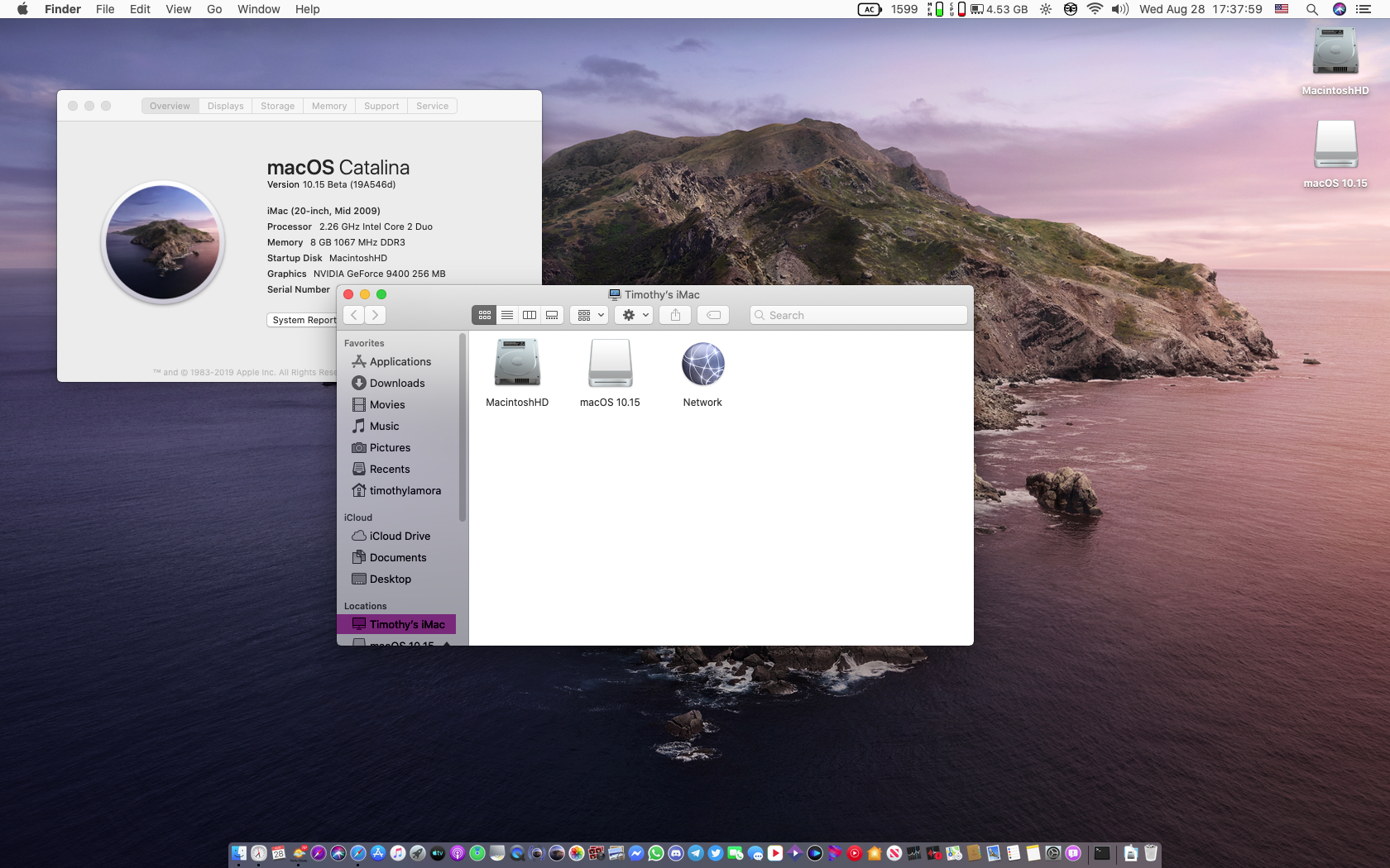

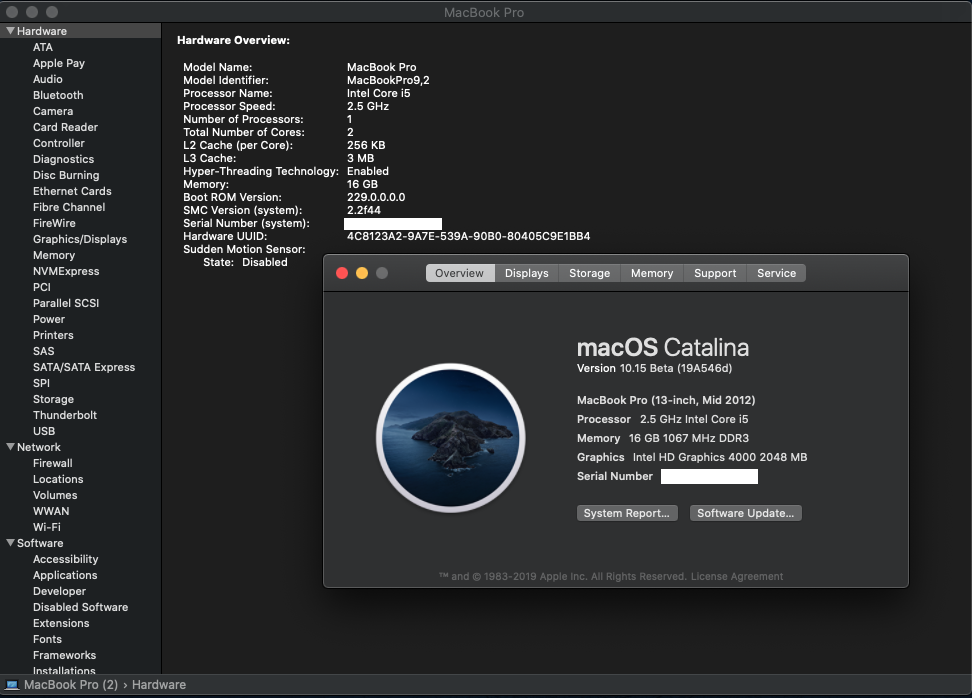

Successfully installed macOS Catalina Dev Beta 7 only issue lost my pictures and documents on the iCloud Drive :( Bluesky patches 1.2 are working as well. I got distracted before the second reboot to apply the post install patches but booted into my desktop after signing into iCloud then got prompted to the night shift patch :)

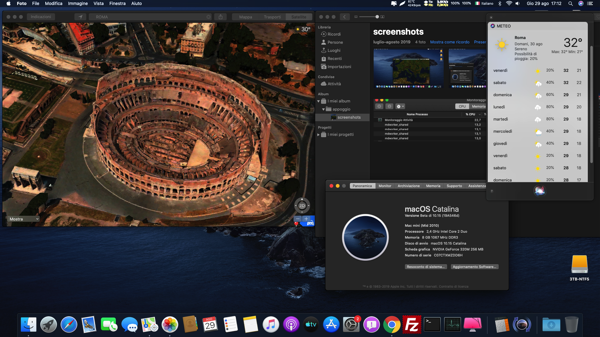

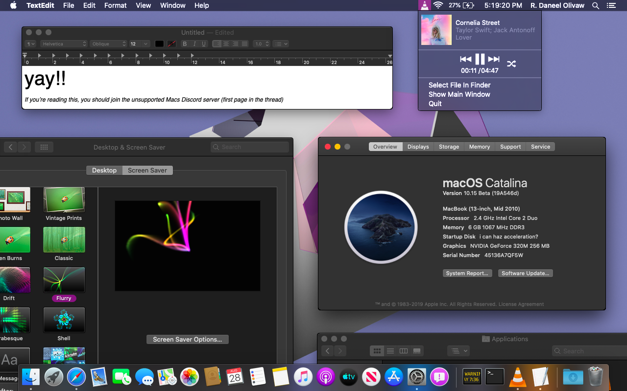

Non-Metal acceleration fixed (again) on Developer Beta 7.
I added two stub functions to the SkyLight wrapper. That's all it took this time.
Notes:
- I've only tested this for about ten minutes, so use with caution.
- The user picture glitch is fixed!
- Sidecar preference pane shows up by default for me; I don't have an iOS 13 device to test but I imagine it's still non-functional without Metal.
- I am shocked that this is still working.
Enjoy! :)

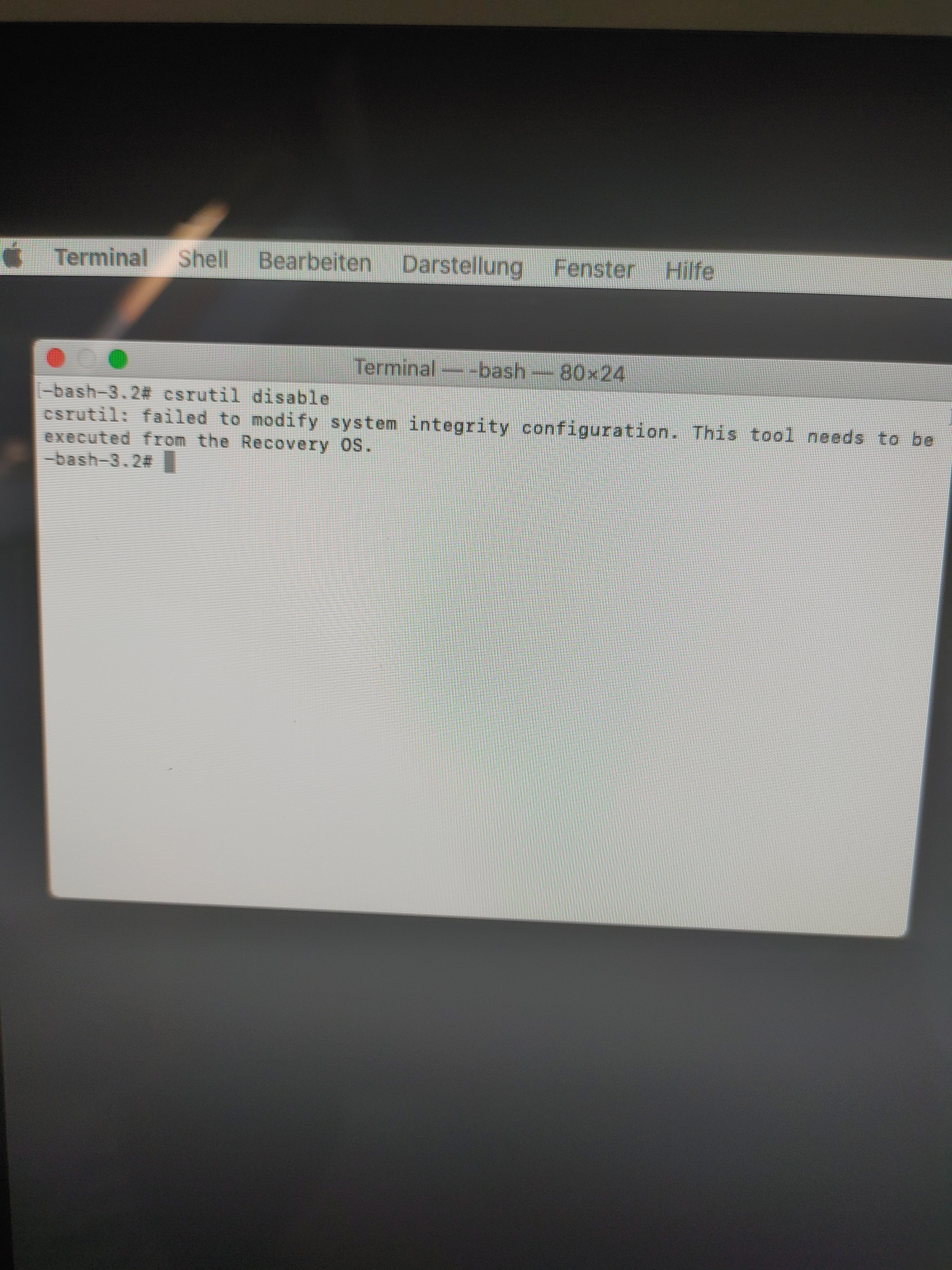

now i have a little problem... i have an imac 2011 with an GTX 860 card... catalina working perfectly but i cant`t boot to my recovery....to disable sip ... can @dosdude1 integrate the sip disable patch to his patcher?? or ist it and i can see it? thank you
Reactions: TimothyR734
You shouldn't need to disable SIP as there is a kernel extension installed to do that automatically on each boot. In any case, you could also try the executing...
csrutil disable
from the Terminal application when booted off of the patched usb Catalina installer.

Terminal say need recovery partition...i must type the command in recovery hrrrrr

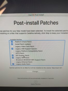

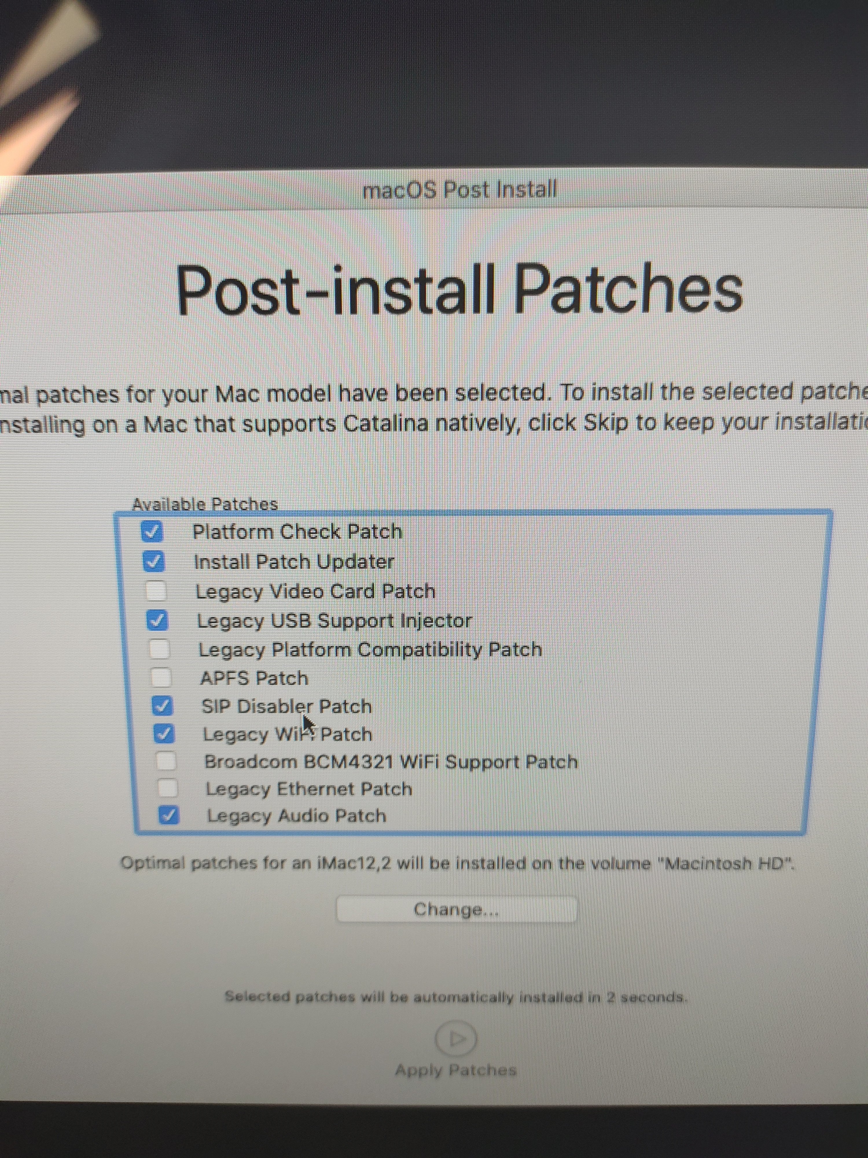

I have it my friend ... I make an pic in 10 min after install dev 7...
...done...
See that SIP disabler patch ..m wauw thank you
