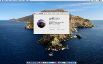

Successful installation (not a clean install but a DP8 update) to DP9 (19A573a)
Little Snitch 4.4.2 finally works again !!!

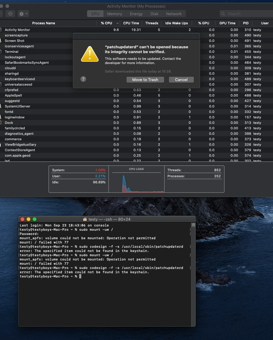

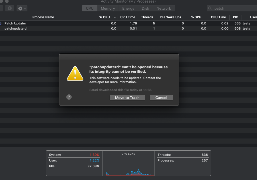

Made a clean install om MP 3.1 using new patcher and getting this over and over.
How to remove?
WTF? Apple requiring sigs on binaries now too? Try running the following in Terminal:
Code:
sudo mount -uw /
sudo codesign -f -s - /usr/local/sbin/patchupdaterd
Also, is SIP enabled? (It NEVER should be on an unsupported system)
No AFAIK, SIP is not enabled. I will check again.
Here is the result of ther commands.

Just checked and it is enabled. I though the patcher automatically disabled?
Is there anyway I can convert my internal Hdd to APFS without having to reformat and lose everything
Booted to USB installer again and disabled SIP manually in Terminal and now seems OK. patchupdaterd message gone. Very odd. I have done nothing to re-enable SIP between beta 8 and beta 9 today.
Thanks for help.

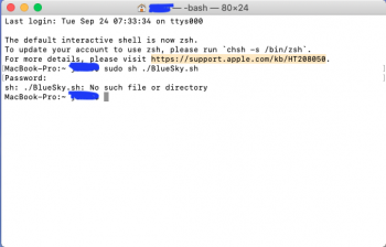

Hello everyone..
I managed to install MacOS Catalina on my Macbook Pro 5.3 (2009) with MacOS Catalina Patcher from Dosdude (Thanks a lot for your excellent work 🙏😄..) I am currently trying to install the BlueSky 1.4 patches to update the problem of darkish interface menu bar & windows..so I looked in this thread the simplest and best way to do it, the message of LuisN seemed correct to try..but the terminal seems to have a problem with the command: "sudo sh ./BlueSky.sh" to link the file and to activate the mod?.. I tested with only the source code file & with the full resource file it can not find the path to the file BlueSky.sh..I certainly miss something in the process, so thank you by advance for your help ..
In Catalina, they apparently changed the shell abbreviation to zsh..it may be one of the possible causes of the problem? ..

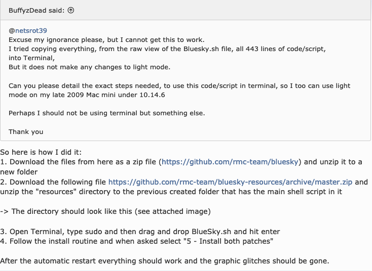

Just to clarify (and I apologize if this has been asked several times already) but with Catalina can I update normally through software update and it’ll automatically patch it for me, or is it similar to the Mojave one and I have to make another USB with the installer and new update to make it upgrade(?)
Tested this method of BlueSky Patch installation as well ..but didn't work either, Terminal still doesn't manage to link to the BlueSky.sh file..I wonder if it would not be a problem of Catalina Beta version compatibility (Version 19A558d)?..by advance, thanks for the help..
Hello everyone..
Hello @Jehm83,
You're right, you have a message at the launch of the Terminal:
The default interactive shell is now zsh
To update your account to use zsh, please run 'chsh -s /bin/zsh'
Try to execute the requested code and restart the Terminal before executing your other commands
For me this line of code did not work I had to go in the preferences of the Terminal, in the General tab then in "Shells open with" select "Command (complete path)" and write below "/bin/zsh" instead of "/bin/bash"
Close preferences and restart Terminal
All future orders should work properly with Terminal ...
