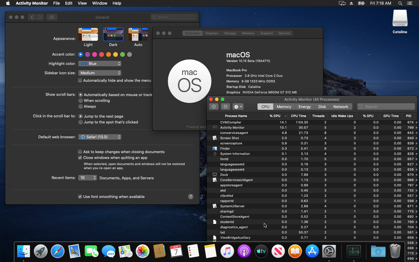

Barebones Catalina up and running on mbp 5,3 (dual nvidia gpu)
  • initial install on a supported Mac to an external USB stick formatted as APFS (GUID of course)
  • Only needed:
    • LegacyUSBInjector.kext in S/L/E -> regenerated a prelinkedkernel on a supported Catalina Mac with SIP disabled
    • removal of telemetry of course
    • nvram boot-args="-no_compat_check -v" (opted out of -x)
  • no other framework patches (yet)
  • no other kext patches (yet)
  • no acceleration (yet)
  • keyboard - mouse - bluetooth work (how I transferred the screenshot below)
  • sound - video - wifi - brightness control still inoperative since I haven't applied kexts that address those yet
  • takes a while to start to get to initial setup and login UI
  • Here's a screenshot

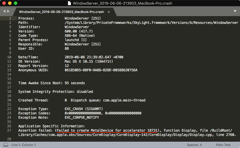

If you're interested, here's WindowServer crash logs on LoginUI (non-Metal Nvidia GT 520 / Fermi) using all untouched System files (Vanilla GeForce, NVDAGF100Hal, NVDAResman, Frameworks, etc..):
  • WindowServer_2019-06-06-213903_MacBook-Pro.zip
