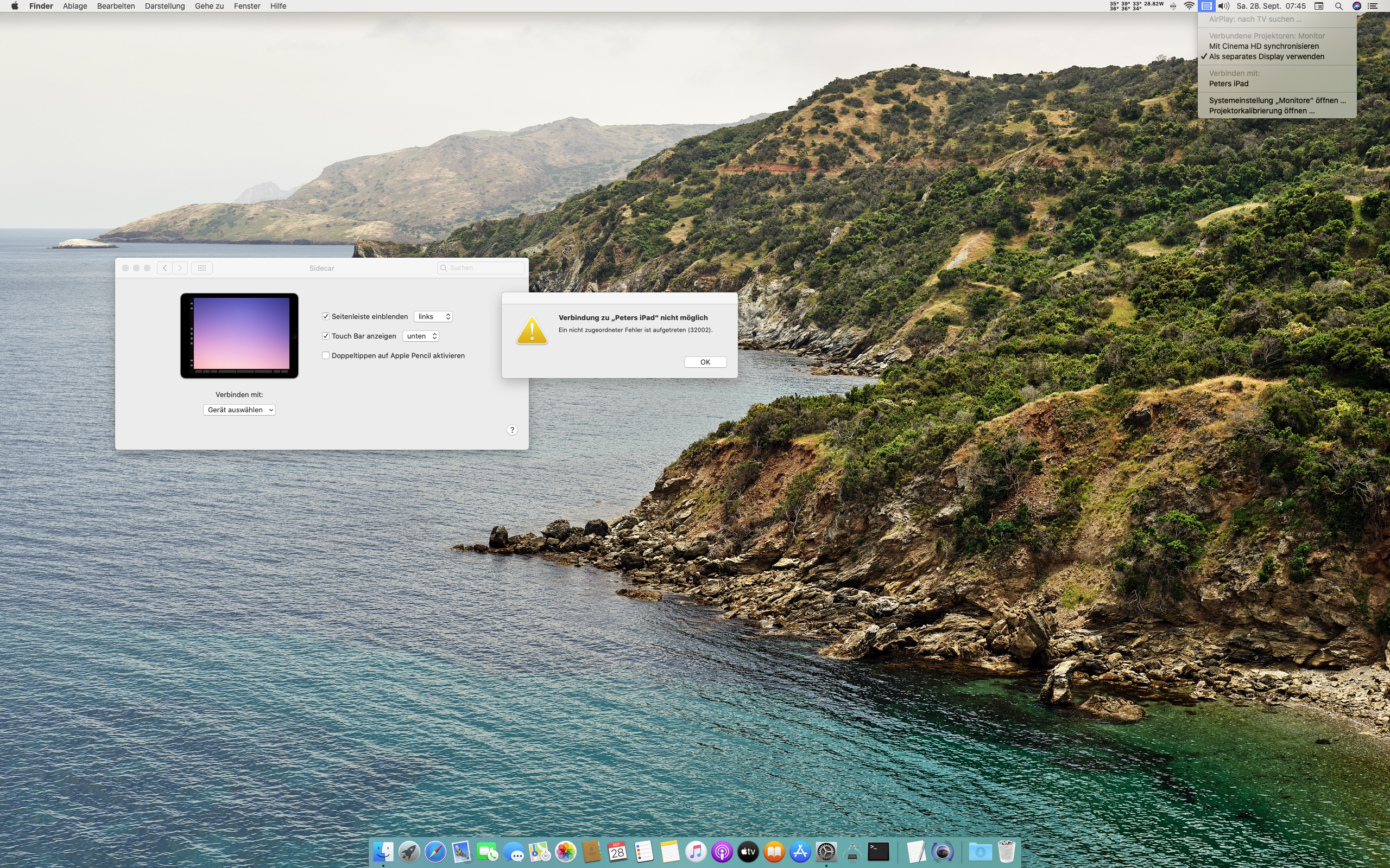

First thank you for the help.
Unfortunately, it did not help me.
The iPadPro9.7 "is now displayed with native SidecarCore.framework and patched SidecarCore.framework.
Same behavior with both variants.
On the iPad is Sidecar App to see and opens with black screen. Catalina reports error.
Same behavior also via Wifi or USB.
I suspect the HD5770 obstructs the function. This does not work and is only for the boot menu.
The "Sidecar App" from the iPadOS side is totally hidden (by apple), it appears only when there is an AirPlay Catalina connection established, maybe the non-metal HD5770 could inhibit especially if seen by system profiler as primary GPU.
However try this: plugging an iPadOS "usb type-c" to an "usb 2.0 type A" cable into an embedded Mac port, then open Catalina Finder, select your iPadOS device and click Trust right after from the iPadOS tap Authorize
Otherwise through using an "usb type-C (aka thunderbolt 3)" cable to an usb 3.0 (Mac port possibly using a pci-express internal hub with another usb type-C input available), because on modern iPad Pro there is a subcheck for a usb-type-c to "usb 3.0" data streaming.
And then you should be able to use Sidecar in wired mode on an unsupported but Metal GPU Mac, unless there are some legacy USB patches that produced conflicts in this.

Hi Jackluke, great work although it did not work with my cMP5.1 with RX580. Thought I would give it a try with Catalina Beta 9 and IOS 13.1.1on an iPad Pro (9.7). I do have Air Display mirroring and after your patch the Sidecar preferences panel appears and all seem to connect properly (USB and wireless - both tried). No error messages. However iPad screen just remains blank. Probably pushing the boundaries with USB2/BT 4.0 but if you have any ideas I will give a go.
The main fact is that my patch is for supported Catalina Mac where many Mac models from 2012 to 2015 and iPad produced from 2014 to 2017 have been escluded by apple for video streaming quality reasons (HEVC GPU with encoder/decoder capable).
However try to check in wired mode if from Catalina Finder you have Trusted the iPad, and be sure to use the same iCloud account on both the devices.
Moreover as I just wrote, you should try to use an internal USB 3.0 pci-express hub, if your iPad has an usb-type-C input port, establishing a "usb-type-c to usb-type-c" direct connection, or at least to an usb 3.0 (blue port).
Or maybe on next iPadOS update and Catalina final release something will be improved.

Yes I followed your instructions and all seems to work properly - sidecar in preferences, sidecar icon in menu bar etc. Just think my present system does not have the "bandwidth" to send the info to the ipad. Maybe USB3 card will help but for me Sidecar is not critical. Patch looks sound though for those with better hardware. Many thanks for all your work.
Almost surely it's an embedded Mac USB (2.0) bandwidth limitation issue (same for @MacPeet), because you have a Full Metal GPU and a modern iPad with ipencil support, and the minimum Catalina supported Mac (2012) have at least an "USB 3.0 XHCI host", also the older iPad "lightning cable" carries up to a "USB 3.0 bandwitch".
Newer Mac and ipad with "usb-type-c" are "USB 3.1 Gen1 / Gen 2" compliant as explained also here: https://support.apple.com/en-us/HT201163
That's not all, since you have an "HEVC capable Metal GPU" and "HEVC iPad" (with ipencil support), you can only stream very high quality video (4k or even 8k), so it's mandatory at least an USB 3.0 bandwitch.
However I find agree, Sidecar is more fitted for Macbook laptops.

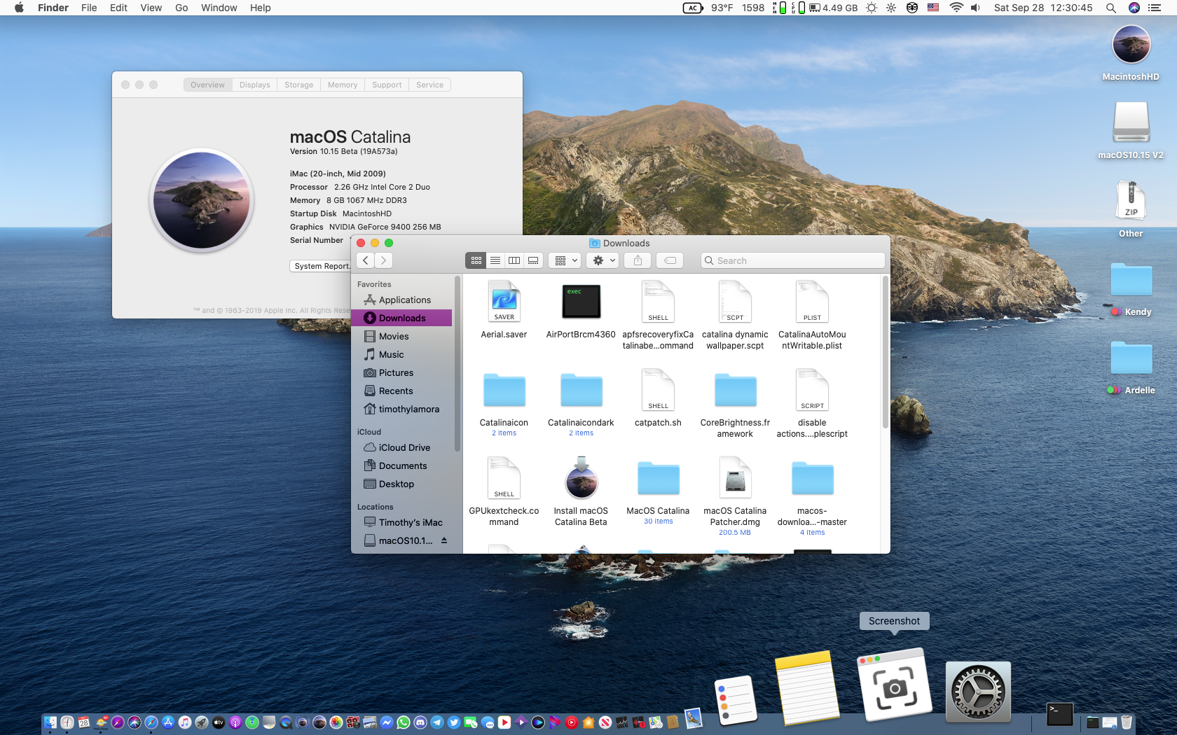

I add another observation after my many experiments, I suppose that, even if apple haven't officially declared this, to estabilish a working-stable "wireless Sidecar" are required Mac and iPad hardware with a Bluetooth 5.0 and Airport 802.11ac card (also known as WiFi 5).

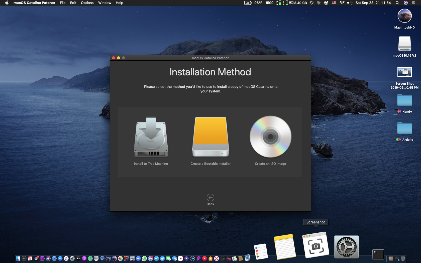

@dosdude1, is there an issues with the patcher? I've tried to create an installer on both my Mac Pro (Catalina) and my MacBook Pro 2016 (Mojave) and both produce this:
Mounting BaseSystem.dmg...
/dev/disk4 GUID_partition_scheme
/dev/disk4s1 Apple_HFS /private/tmp/basesystem
Patching BaseSystem.dmg...
"disk4" ejected.
Preparing imaging engine…
Reading Protective Master Boot Record (MBR : 0)…
(CRC32 $19CF5867: Protective Master Boot Record (MBR : 0))
Reading GPT Header (Primary GPT Header : 1)…
(CRC32 $1A6E5D70: GPT Header (Primary GPT Header : 1))
Reading GPT Partition Data (Primary GPT Table : 2)…
(CRC32 $F9779FDF: GPT Partition Data (Primary GPT Table : 2))
Reading (Apple_Free : 3)…
(CRC32 $00000000: (Apple_Free : 3))
Reading disk image (Apple_HFS : 4)…
(CRC32 $9F59202F: disk image (Apple_HFS : 4))
Reading (Apple_Free : 5)…
(CRC32 $00000000: (Apple_Free : 5))
Reading GPT Partition Data (Backup GPT Table : 6)…
(CRC32 $F9779FDF: GPT Partition Data (Backup GPT Table : 6))
Reading GPT Header (Backup GPT Header : 7)…
(CRC32 $2CC3C4A0: GPT Header (Backup GPT Header : 7))
Adding resources…
Elapsed Time: 14.717s
File size: 692650256 bytes, Checksum: CRC32 $03D201DA
Sectors processed: 4187760, 3552436 compressed
Speed: 117.9Mbytes/sec
Savings: 67.7%
created: /private/tmp/BaseSystem.dmg
Restoring BaseSystem.dmg...
Validating target...done
Validating source...done
Retrieving scan information...done
Validating sizes...done
Restoring ....10....20....30....40....50....60....70...newfs_hfs: cannot create filesystem on /dev/rdisk2s3: Resource busy
/sbin/newfs_hfs failed with error 256
Could not restore - Device not configured
