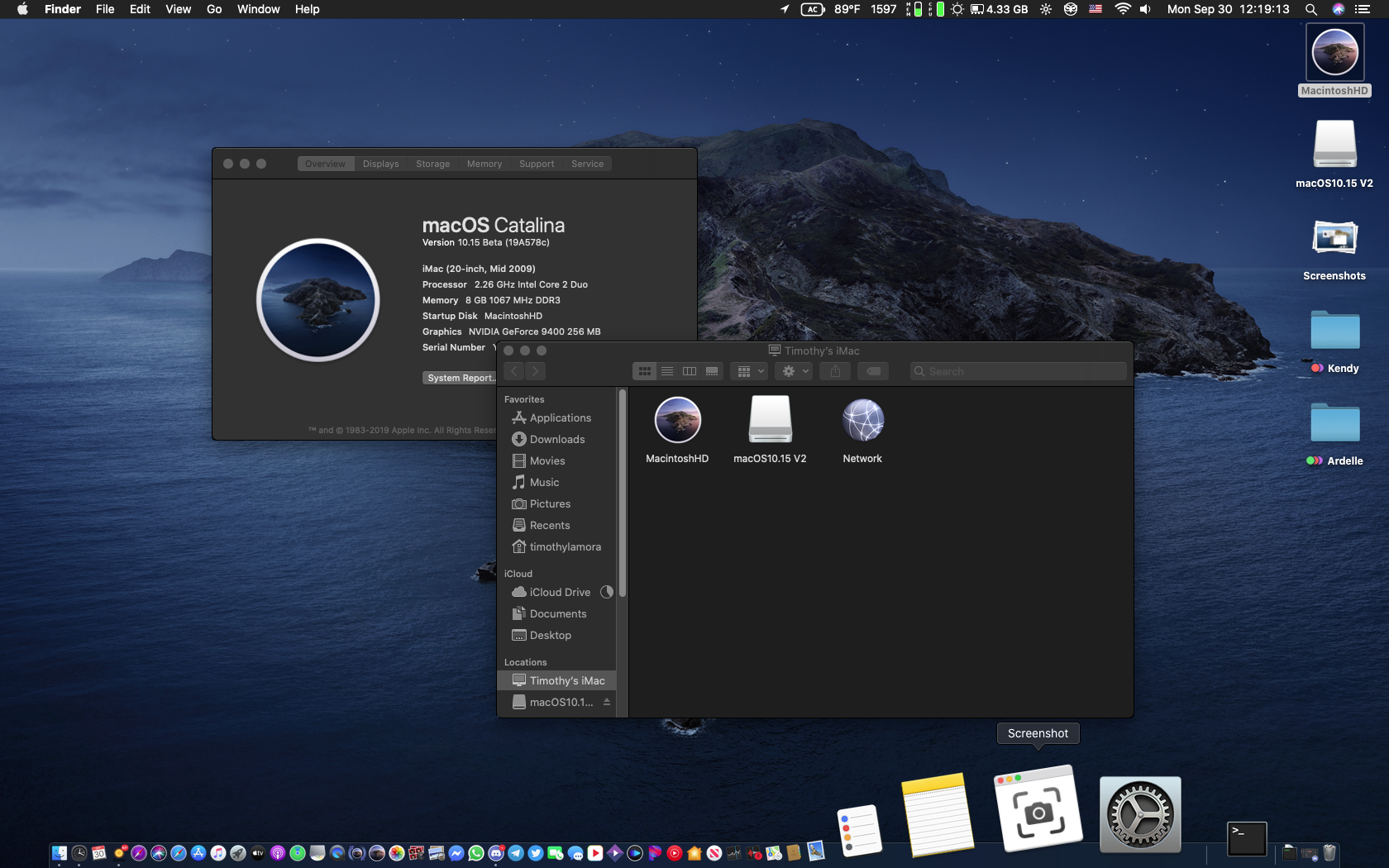

screen-shot-2019-09-30-at-12-18-53-pm-png.865230
Succesfully installed Cat dev 10 using the install to this machine method using cat patcher 1.1.5 :)

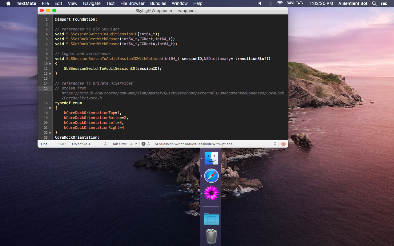

Julian's HIToolbox patch from his last version of BlueSky and Jackluke's Skylight patch to View attachment 865244fix grey sidebars from Cat Dev 8 still works on Cat Dev 10
To clarify the original SkyLight patched from @ASentientBot that I used is this:
then hybrid binary patched using the @testheit method that wrote the offsets to replace in a message, that from 10.14.6 SkyLight have a bit shifted, but consider that this file is hybrid patched over this @ASentientBot release so is not updated to his latest one.

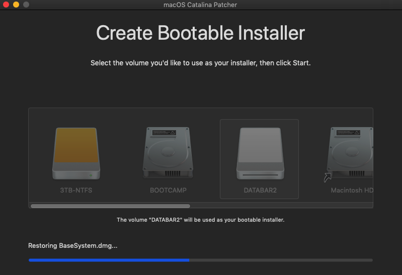

@dosdude1 for the second time my everytime succesfully used usb 2.0 16 gb pendrive is stuck after downloading B10 & patching, restoring BaseSystem.dmg with patcher 1.1.5, no error shown.
EDIT Using a Samsung USB 3.0 pendrive on differenti Port solved kg issue. 😃 Strange, the old pendrive filler with 9 GB works fine.
