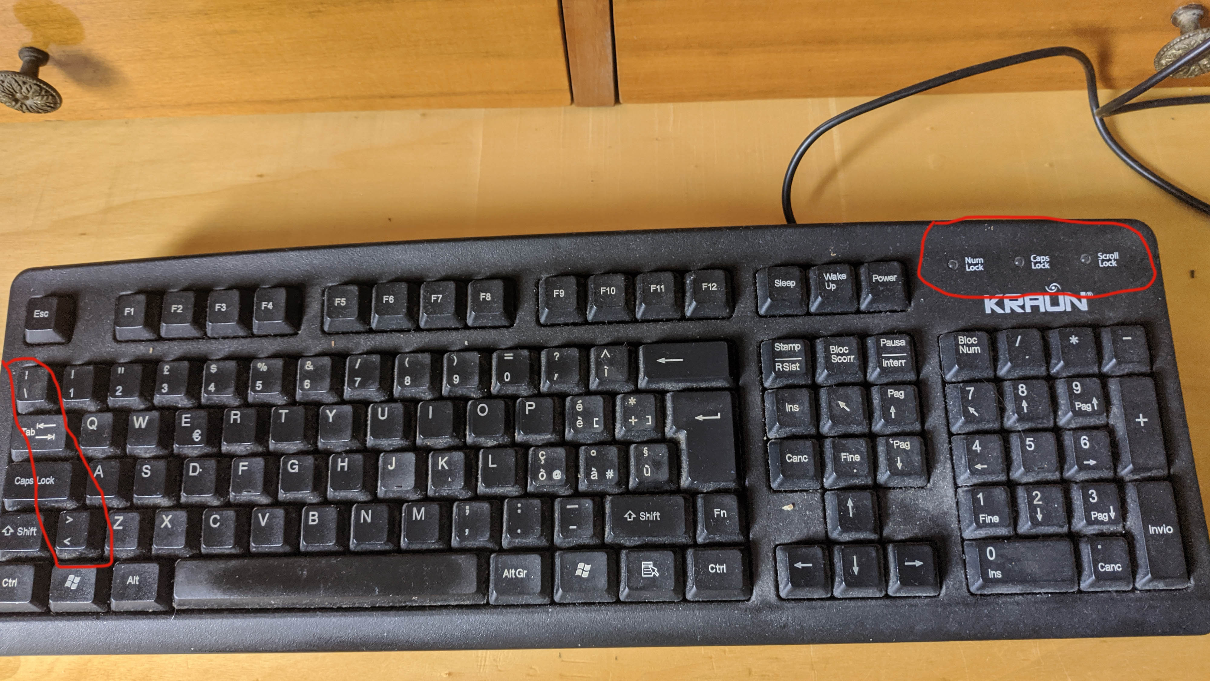

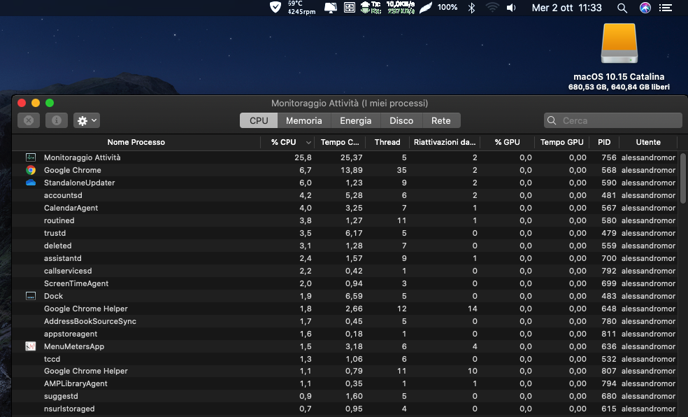

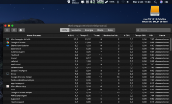

@dosdude1 @ASentientBot Some remaining macOS Catalina B10 minor glitches to fix (on Macmini late 2010 Core 2 Duo Penryn 2.4 Ghz, 8 GB RAM, EXT usb 3.0 harddisk, Samsung S24D300 connected via HDMI (Macmini4.1) . (On 1.3.3 patched Mojave 10.4.6 Supplemental Update 2 all four above features work fine)
1) Inverted \| -> <> keys on 2 different usb wired PC Italian keyboard (fixed with karabiner-elements util).
2) Num Lock\Caps Lock\Scroll Lock leds OFF on PC keyboard (functions work) Workaround: Captin mac app
3) Wifi menu icon greyed (as disabled, shown normal after clicking on it) but wifi function working & stable.
4) CPU uses 100% after boot, without heavy processes shown. After about 30 min it go down to 15/40%

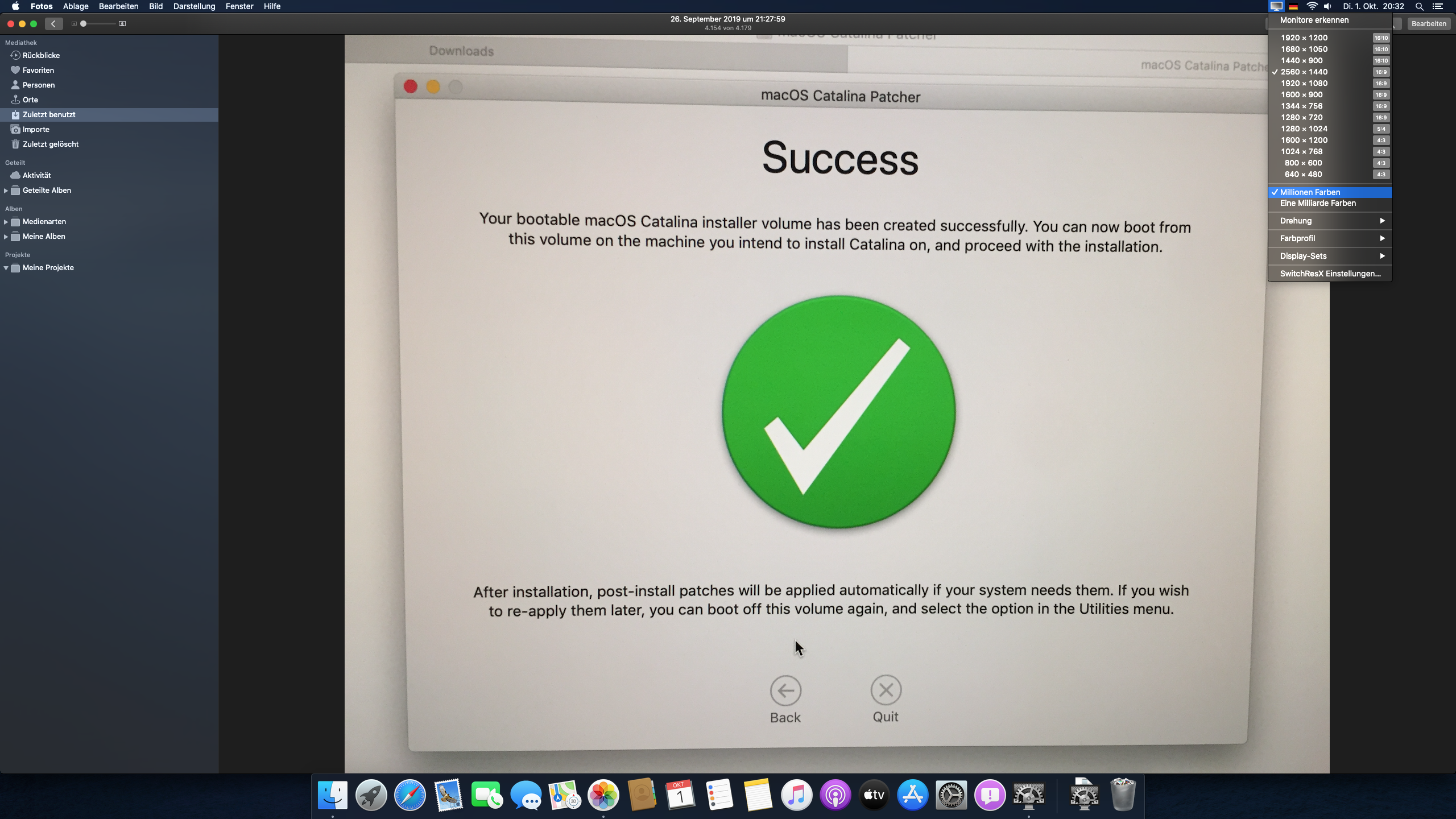

I already had the issue with the beta 9.
I have now installed the SwitchResX app (Version 4.9.0), disabled SIP and changed the colors from 1 billion to millions, which has fixed the issue:
Currently, 3 people have reported the issue: @iMac-Oldschool probably has a AMD Radeon HD 2400 or 2600, @antony34 has a AMD Radeon HD 4670 and I have a AMD Radeon HD 4850.
3 persons could not reproduce the issue: You (@ASentientBot) have a GeForce 320M, @TimothyR734 has a GeForce 9400M and @vince22 has a metal-compatible video card.
So it's very obvious that the issue only occurs with metal-incompatible AMD video cards.
Maybe others who can reproduce the issue can say which video card they have.
Incidentally, videos that are double-clicked in the Photos app are played correctly (with 1 billion colors).
I noticed something else: If you look at the system info, on High Sierra (the last official macOS for my iMac) the „Framebuffer Depth" is "24-Bit Color (ARGB8888)" (= about 1.67 million colors or 8 bit per channel/sample) and with the Mojave and Catalina patch the „Framebuffer Depth" is "30-Bit Color (ARGB2101010)" (= about 1 billion colors or 10 bit per channel/sample).
Therefore, I think that the affected AMD video cards do not support 30-bit color (see also). Or what do you think? @ll
Maybe the above fix/workaround that @ASentientBot has suggested will help some users and developers.
Edit: Because the SwitchResX app is only free for 10 days, I looked for a permanently free alternative and found the ResXtreme app (Version 1.0.1 (6)), which also works well for me (you have to choose your resolution with 8 instead of 10 bit/sample).
Just tested to install SwitchResX and changed to millions color, its work again!! thank you for your information!

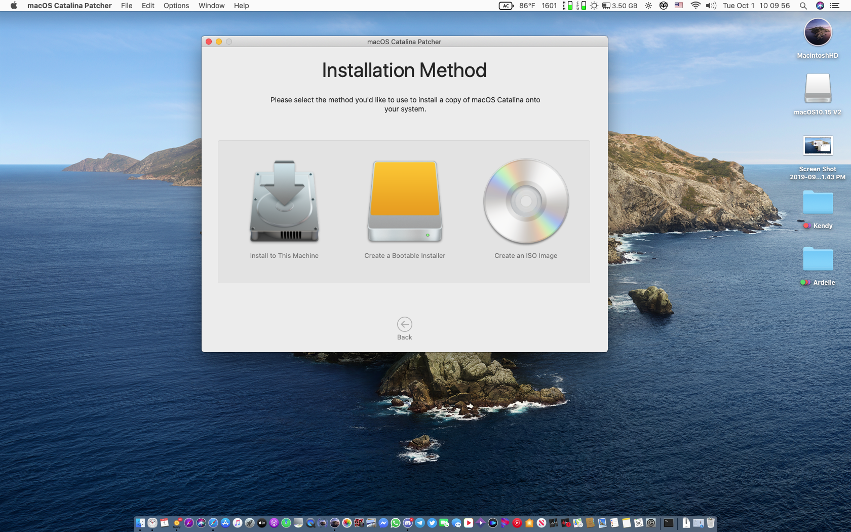

MBP4,1 17" ...Am stuck with DP8, wasn't able to make the USB installer with DP9 and DP10, due to some specific error, wasn't able to get the terminal hack to work... the resulting "macOS Base System" however is bootable, although only 1.75GB in size.
How can I proceeed, anyone of the fellow boardmembers willing to help me out, please? Thanks alot in advance
Use the "Install to This Machine" option instead to update from DP8 to DP10.

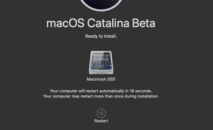

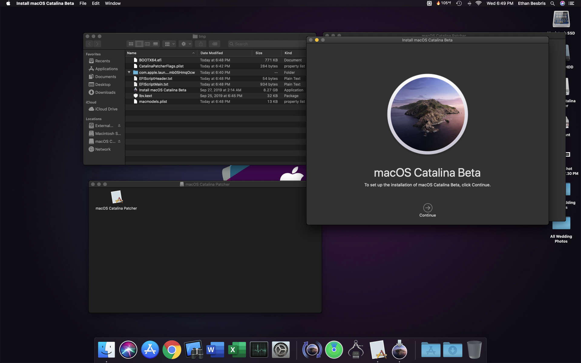

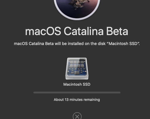

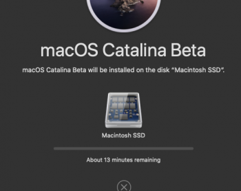

I cannot get my iMac 9,1 to update to Dev Beta 10. I've tried a few times using the "in-place" method, verified everything is getting copied to /tmp, and gone through all the prompts. Each time, the machine jus reboots to Beta 9. No errors of any kind. I'm not sure if I'm doing something wrong, or there's something that I need to hit during the install process?
I'm building a Catalina USB now to try and do it that way. I have not yet tried updating my 5,1 Mac Pro, but the Metal compatible card in it does not show the boot options, so I'm hoping an "in-place" upgrade will work since I can't select the USB device. Attached are some screenshots that I took during the install process on my 9,1.
UPDATE: My Mac Pro 5,1 updated fine with the "in-place" method. My iMac is still installing via USB. Seems to be working. Another 20ish minutes, maybe?
Is you SSD formatted APFS and your Usb Catalina Patcher formatted HFS-Extended Journaled
Everything updated correctly on my Mac Pro 5,1 using the "in-place" upgrade method. My iMac I had to do manually by creating a USB installer. Everything is good. As far as how things are formatted, both SSDs (the one in my 9,1 iMac and 5,1 Mac Pro) are APFS. The USB is formatted however the Patcher tool formatted it.
