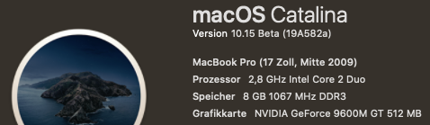

DP11 (15.0.32, 19A582a) installed on MBP5,2 via USB installer made with patcher 1.1.5.
Also re-installed the night shift patch with patch updater.
Running with the 9600M GT GPU this time.
Everything fine, including Photos (excpet the "all photos" item which can be worked-around) and Maps.
Great thanks, ASentientBot and Dosdude!
(MBP5,2 17" mid 2009, 2.8GHz T9600, 8GB, APFS ROM patch applied, Samsung SSD 840 EVO with APFS on USB.)

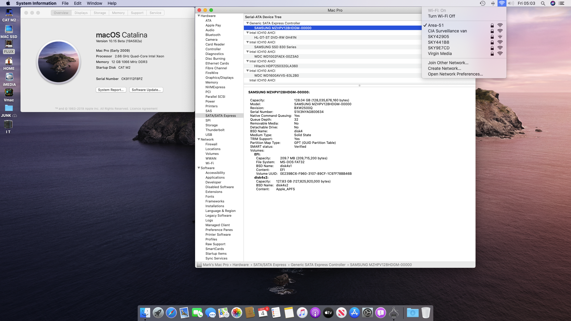

Installing DP11 as I type with zero patches will post results later
(Mac pro 4.1/5.1)
UPDATE: all sorted no patches, I have HDMI sound, all USB port are working and I've used the hackintool too install the wifi kext I copied from Mojave. lilu,innie and appleALC provide HDMI sound and innie fixes wrongly displayed external pci, now shown correctly as internal

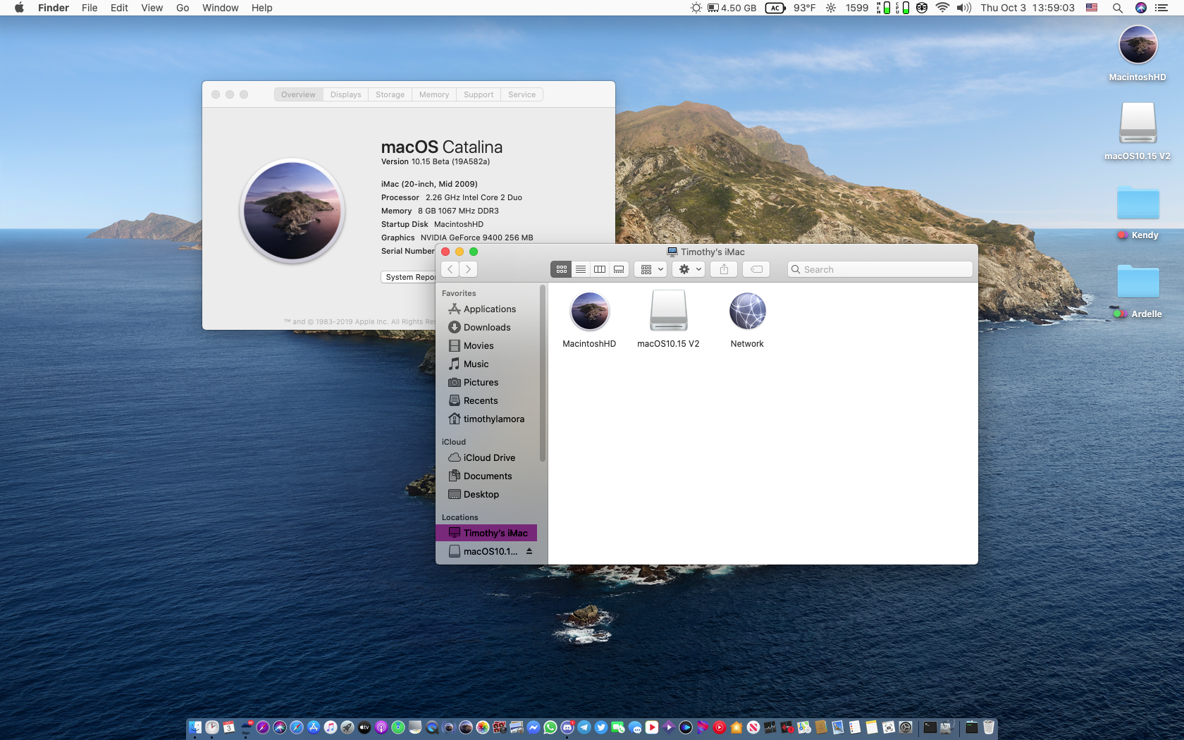

The gray in your screenshot is far too dark, you can barely read the writing. that is so bad with me too!
It's probably due to the HiToolbox framework and / or the Skylight framework. Can not you change that to make the gray in the transience brighter?
[automerge]1570204642[/automerge]
BlueSky does work and I think this looks just as well as Mojave :)
