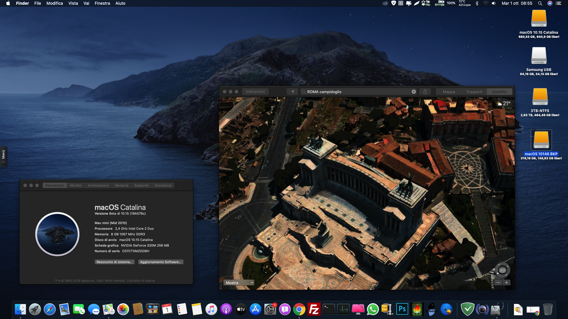

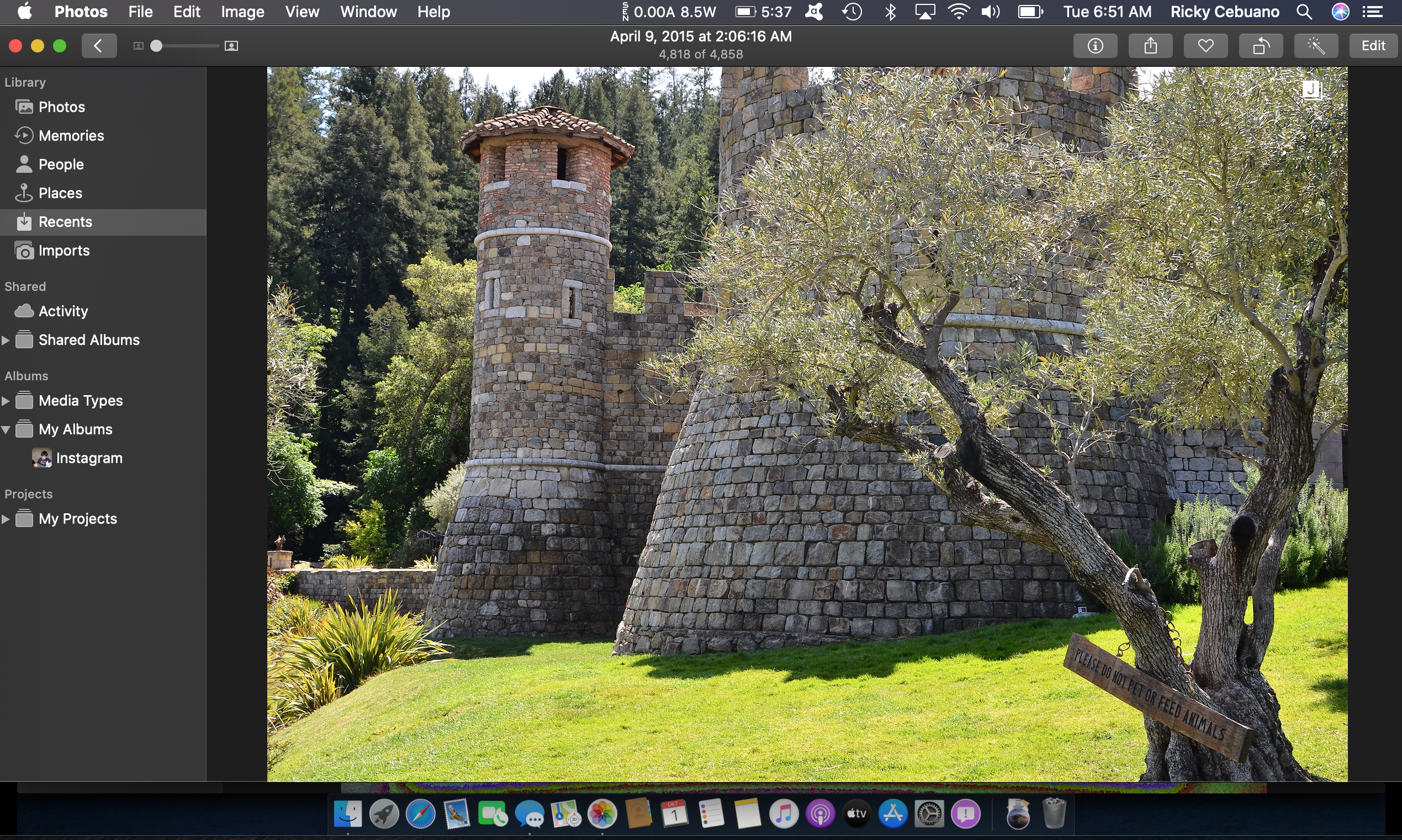

Installed Beta 10 (19A578c) on an iMac8,1 without problems.
Maps is now stable, as well as the Places Library in Photos.
One problem in Photos.
Pictures, such as this, that appear perfectly when viewed in an album,
disintegrate completely when double clicked to enlarge.

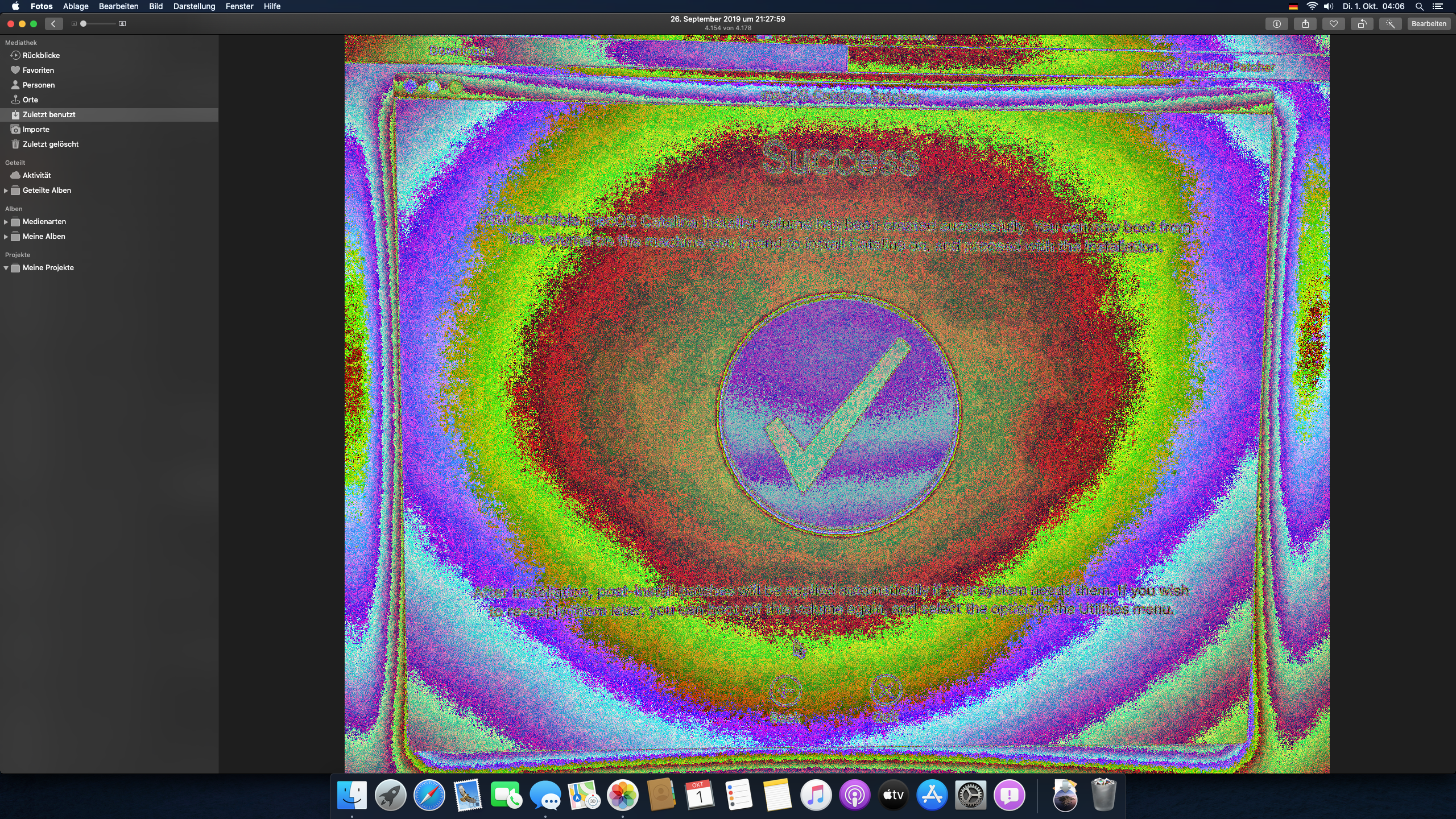

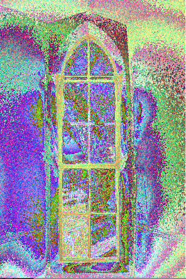

Hey,
I can reproduce this issue.
I have used macOS Catalina Patcher (Version 1.1.5). I first installed macOS Catalina 10.15 beta 9 (19A573a) from the usb-stick (clean install). Later I installed macOS Catalina 10.15 beta 10 (19A578c) over it ("Install to this Machine").
If I enlarge a photo (no matter which one) in the Photos app Version 5.0 (beta 9: 101.15.12 or beta 10: 101.15.190) by double-clicking, then it will - as already shown above and in my appendix - pretty pixelated and colorful :D
However, the thumbnails are displayed correctly in the Photos app. When I open the photos in the Preview app, they will also display correctly.

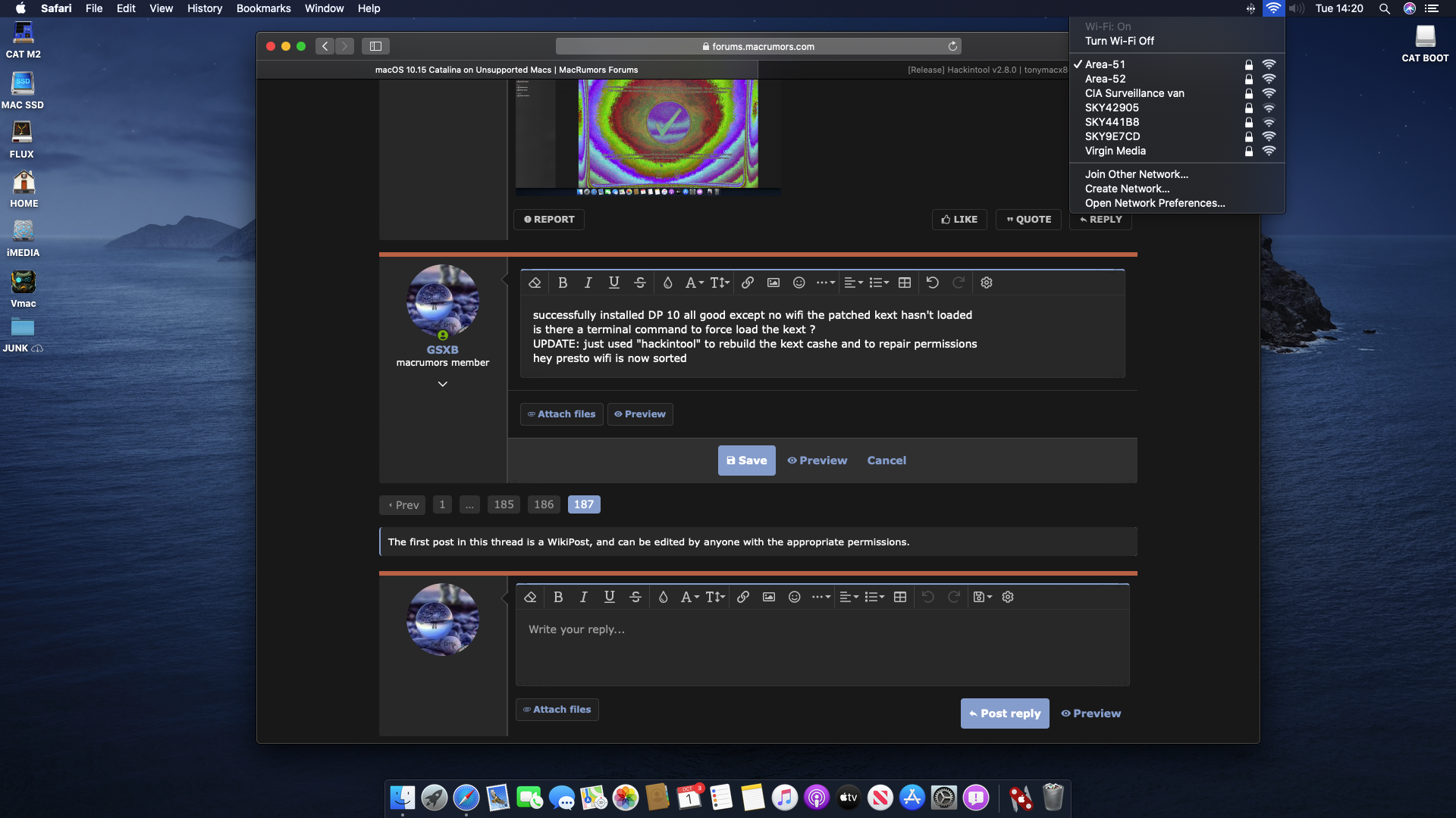

successfully installed DP 10 all good except no wifi the patched kext hasn't loaded
is there a terminal command to force load the kext ?
UPDATE: just used "hackintool" to rebuild the kext cashe and to repair permissions
hey presto wifi is now sorted

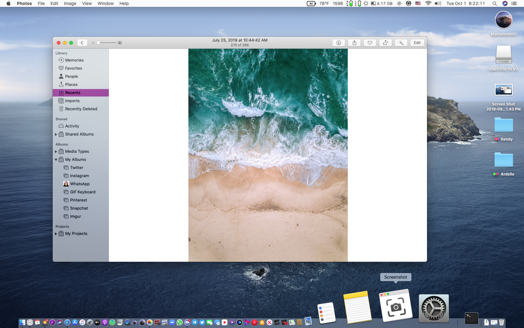

This doesn't happen to me with a MacBook7,1 (GeForce 320M) on DP9. I'll install DP10 this afternoon and see if it starts happening on my system. Otherwise, it might just be an issue with AMD cards rather than the non-Metal acceleration patches in general.
You could try using a third party app like SwitchResX to change the color bit depth and see if that fixes it. It looks like it might.
Weird...

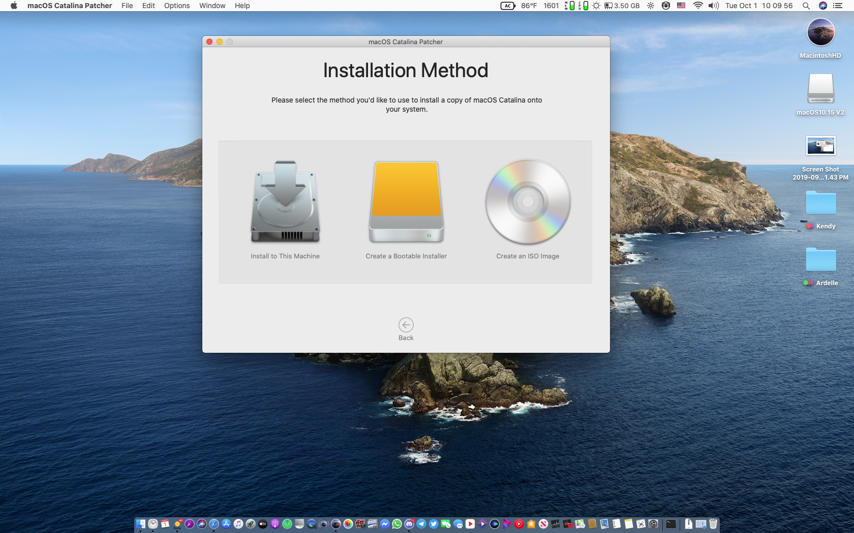

He's telling you to try using the "Install to This Machine" option of the Catalina Patcher, IE do NOT use a USB drive to install.

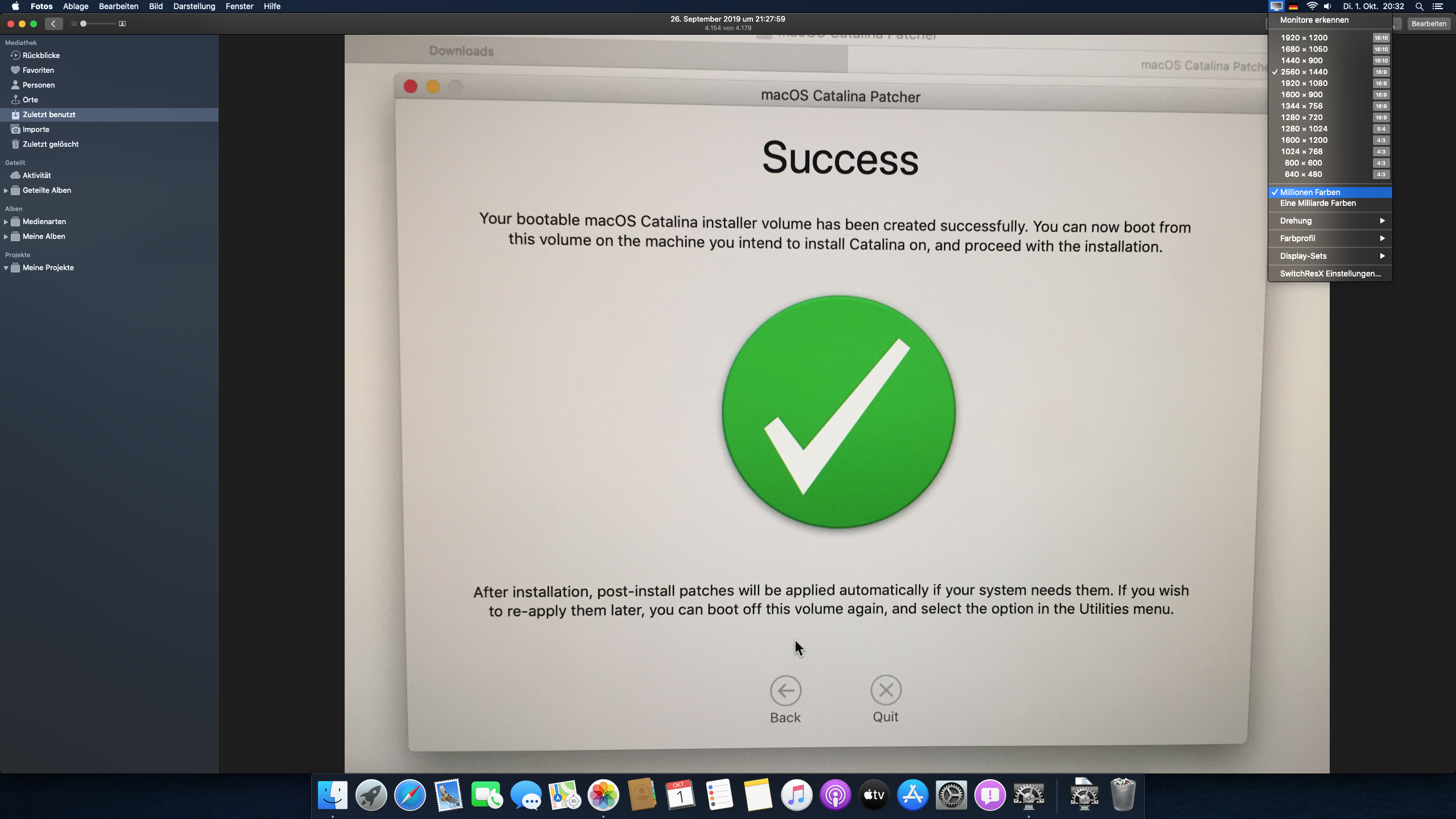

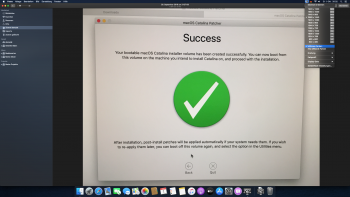

I already had the issue with the beta 9.
I have now installed the SwitchResX app (Version 4.9.0), disabled SIP and changed the colors from 1 billion to millions, which has fixed the issue:
Currently, 3 people have reported the issue: @iMac-Oldschool probably has a AMD Radeon HD 2400 or 2600, @antony34 has a AMD Radeon HD 4670 and I have a AMD Radeon HD 4850.
3 persons could not reproduce the issue: You (@ASentientBot) have a GeForce 320M, @TimothyR734 has a GeForce 9400M and @vince22 has a metal-compatible video card.
So it's very obvious that the issue only occurs with metal-incompatible AMD video cards.
Maybe others who can reproduce the issue can say which video card they have.
Incidentally, videos that are double-clicked in the Photos app are played correctly (with 1 billion colors).
I noticed something else: If you look at the system info, on High Sierra (the last official macOS for my iMac) the „Framebuffer Depth" is "24-Bit Color (ARGB8888)" (= about 1.67 million colors or 8 bit per channel/sample) and with the Mojave and Catalina patch the „Framebuffer Depth" is "30-Bit Color (ARGB2101010)" (= about 1 billion colors or 10 bit per channel/sample).
Therefore, I think that the affected AMD video cards do not support 30-bit color (see also). Or what do you think? @ll
Maybe the above fix/workaround that @ASentientBot has suggested will help some users and developers.

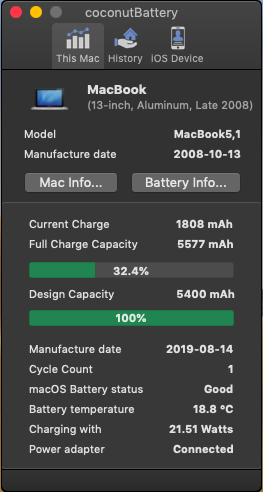

@avz
Hi, I see that your new battery is recently manufactured !
I am also looking to buy a new battery for my macbook7,1. On which site did you buy yours?
Thank you
One of the forum members suggested that I should buy a battery from the DuracellDirect.com, which I did(brand 2-POWER). I am very happy so far but of course with batteries only time will tell. I can get about 8 hours with light usage. It has 12 months warranty and I paid AU$99.00 for it(I am currently in Australia).
