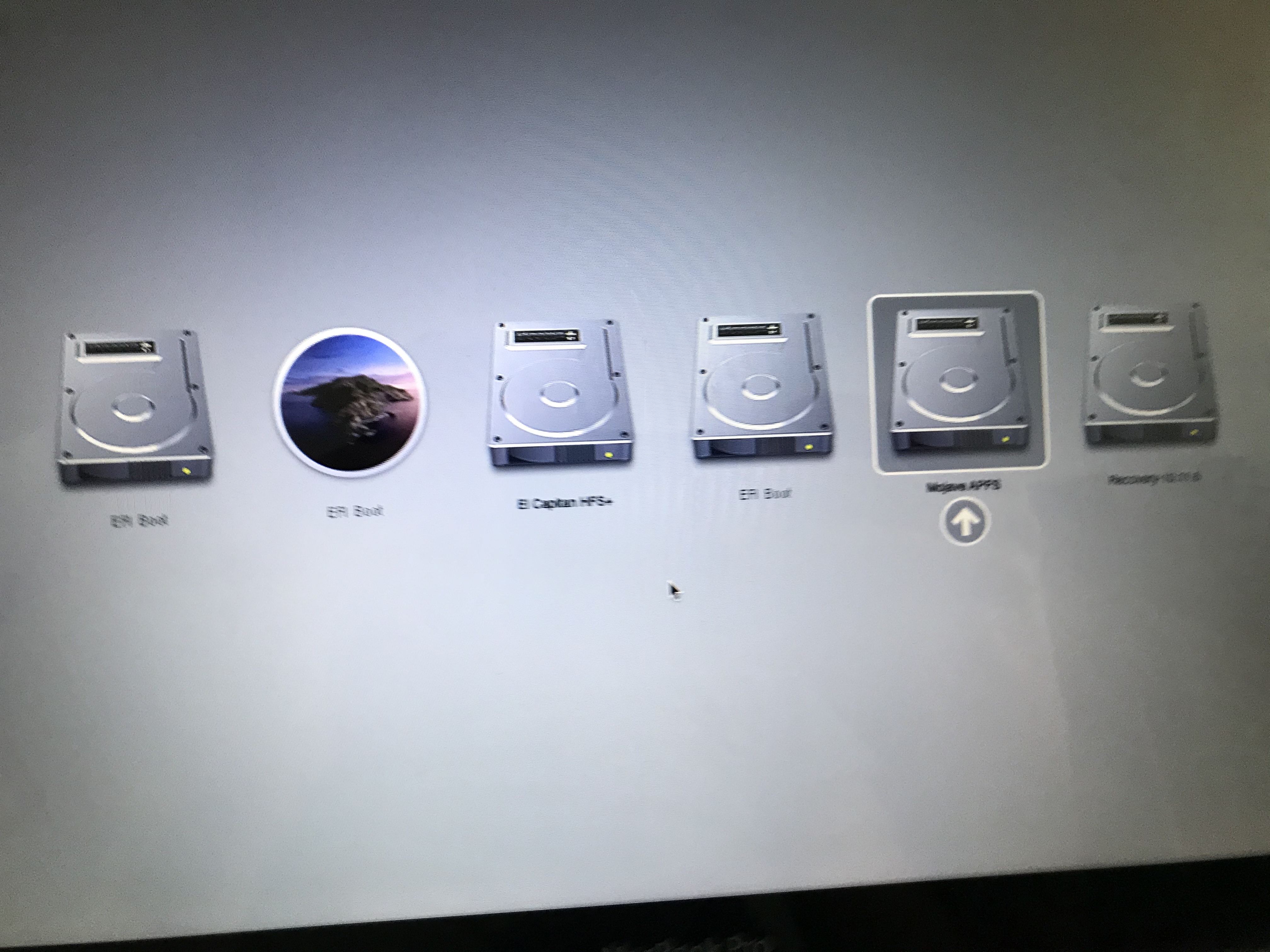

Hey everyone,
Something has gone whack with the installations. I seem to have 3 EFI Boots now. C1ACDA10-EF02-4BF8-91B3-1A6F76DCCF92.jpeg
One of them is my patched install Catalina partition, which I’m not worried about. However, the EFI Boot on the very left brings me straight into my Mojave partition (downgraded from Catalina after chrome wouldn’t work, couldn’t take care of work without chrome). The second EFI Boot partition brings me into what seems as the APFS patch, running the black and yellow code before booting into my Mojave partition.
My Boot ROM has been patched to natively boot APFS, so the patch is not necessary and thus the EFI Boot is not needed.
When I mount the EFI disk from terminal, there are three files in it:
apfs.efi
APPLE > EXTENSIONS > Firmware.scap
BOOT > BOOTX64.efi and startup.nsh
Which files do I delete to get rid of these EFI Boot options at startup? Thanks!

If you have the APFS ROM Patcher installed, you will see an "EFI Boot" partition for every APFS volume you have. This is just a side effect of the unofficial APFS support added to your BootROM. If you delete BOOTX64.efi from the ESP, that will get rid of one of them.

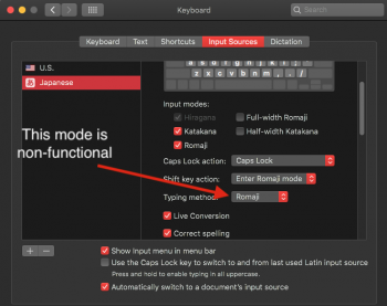

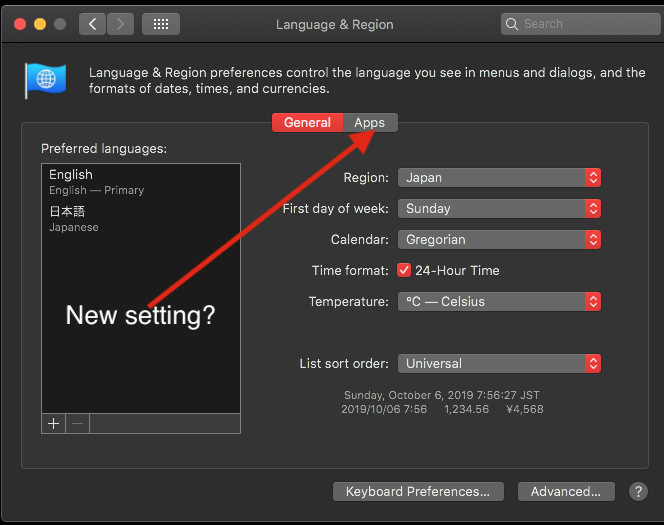

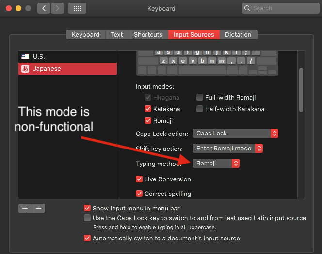

MAJOR ISSUE (for me) guys—the beta 11 DosDude version loses support for Japanese input. The Japanese keyboard can be selected but there is no Japanese character input!
This is a showstopper for me—seen it on two machines

The problem seems to be with so-called Romaji input which is where Japanese hiragana and katakana characters are input from a Roman alphabet keyboard. If the direct input is set then hiragana/katakana is OK. If Romaji input is set, then the Japanese character input fails and は appears as ha.
There is also a new setting (Apps) in the Language and Region Sys Pref tab that I wonder might be related to the issue.

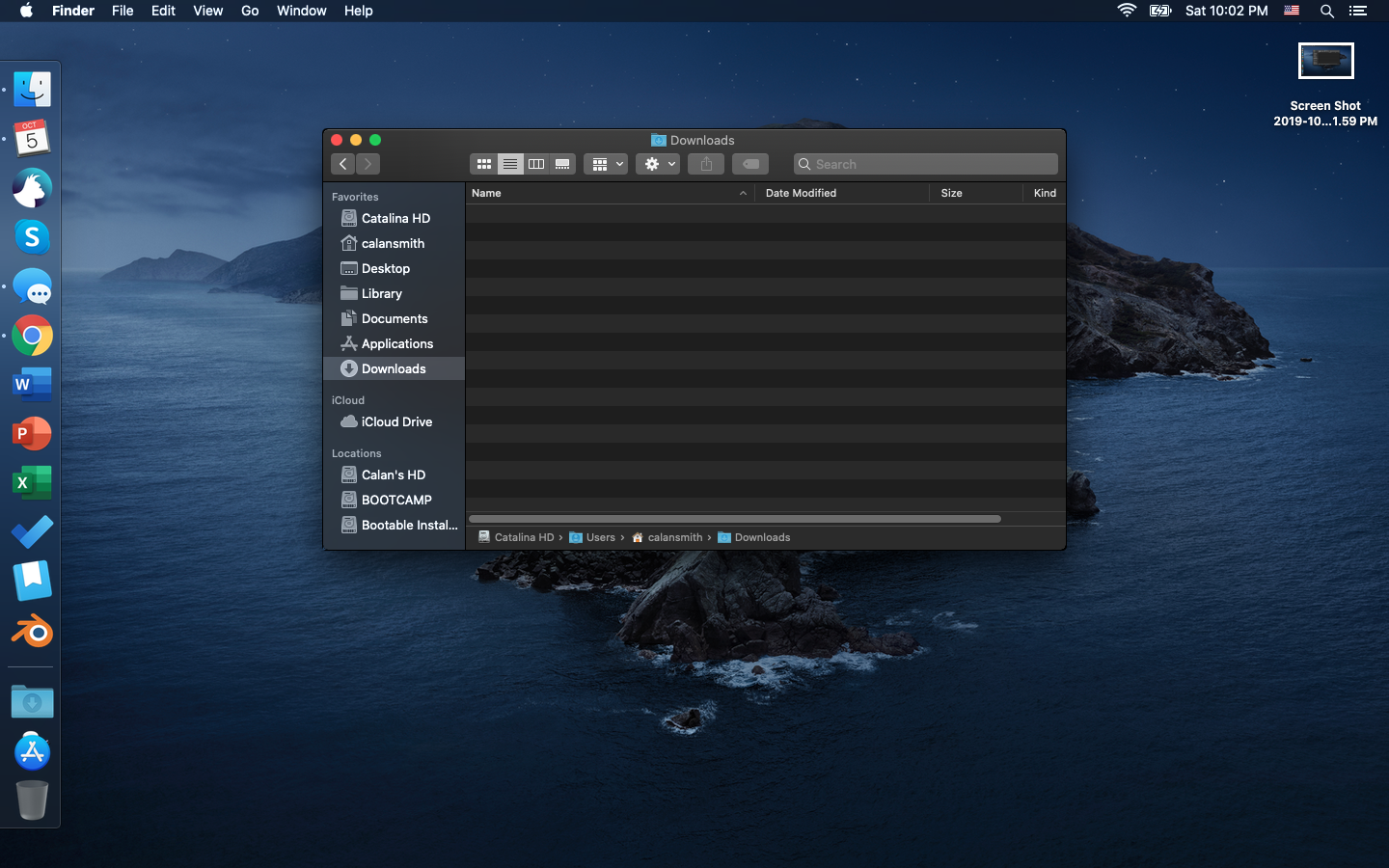

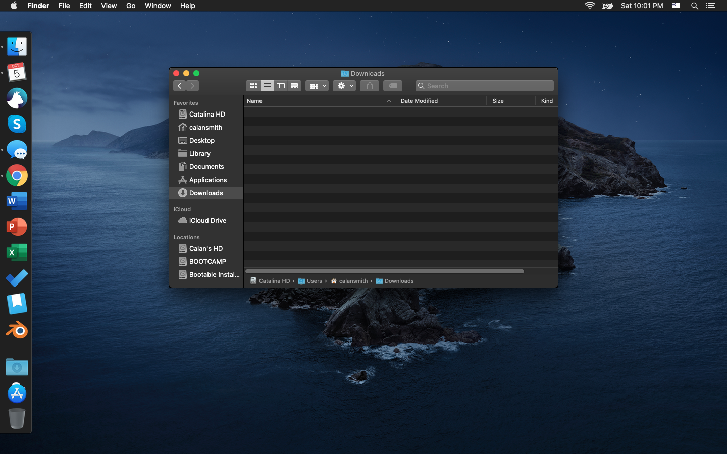

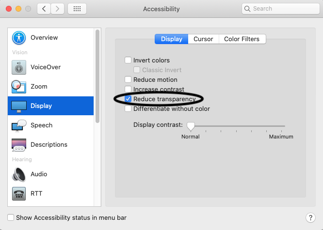

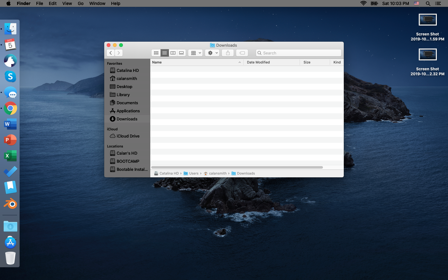

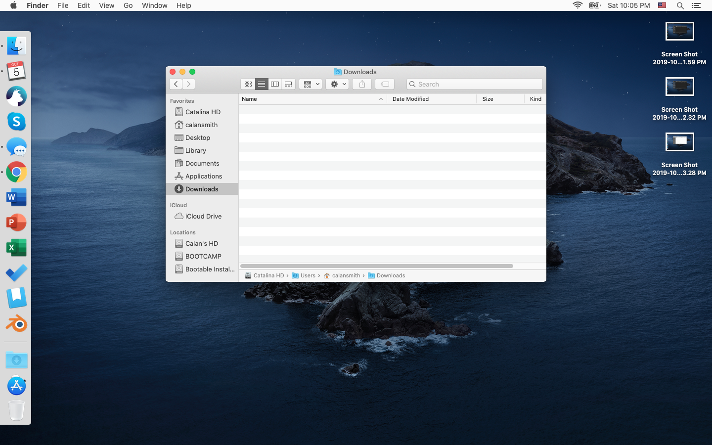

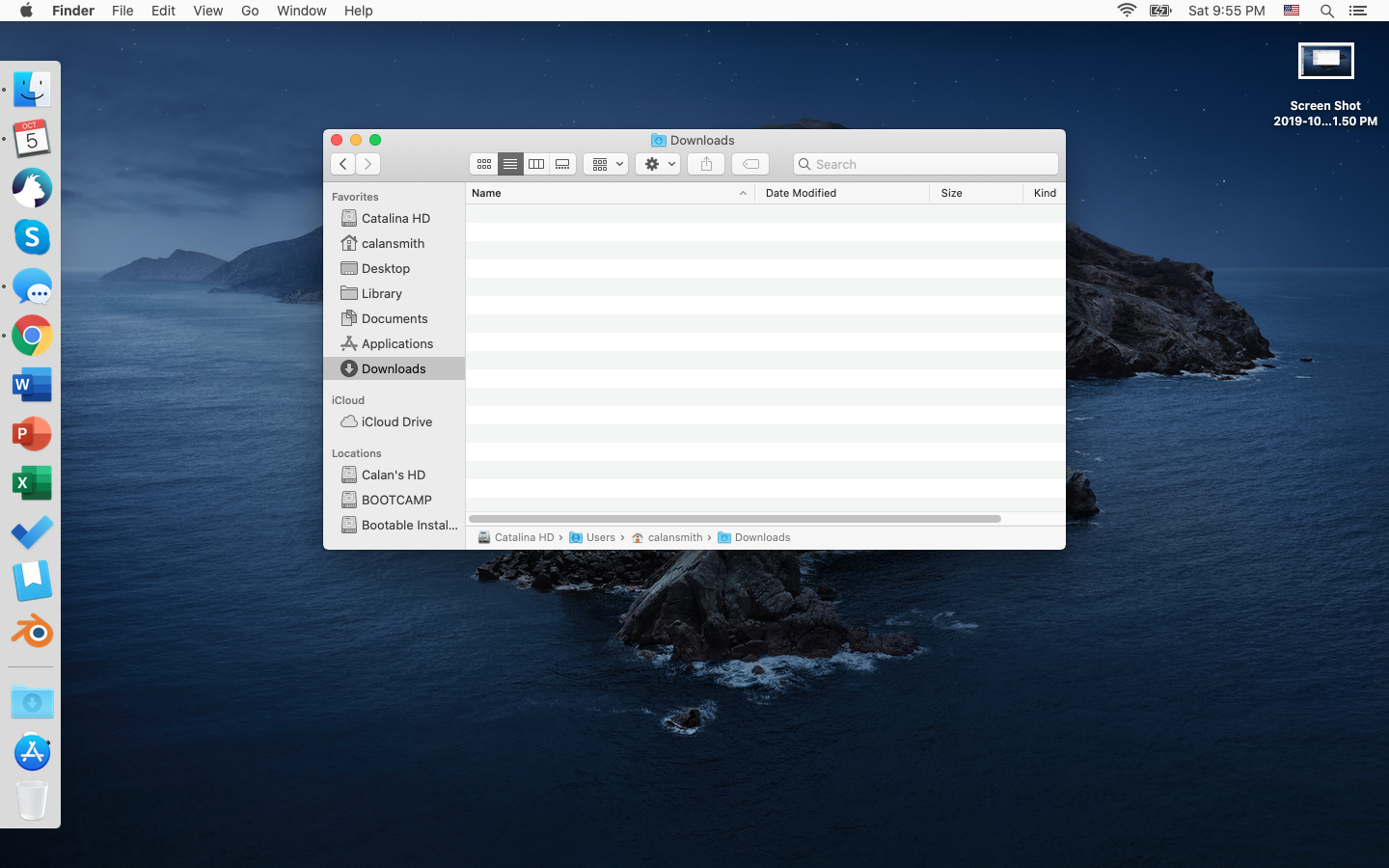

Also, I don't think this has been mentioned yet, but I found a workaround for the grayed-out menu bar and Finder Sidebar in light mode. If you go into System Preferences > Accessibility > Display, and check the box for 'Reduce Transparency'
After you do this, nothing in light mode should be weirdly grayed out.
Unfortunately, that makes the Dock no longer transparent, but that bothers me a lot less than either having to deal with a dark gray menu bar or stay in dark mode all the time.
I hope this helps!
Reactions: TimothyR734
I just realized, this affects dark mode too. A little downgrade on dark mode, but a huge improvement on the light mode in my opinion. I'm also curious if you could do something with the 'Color Filters' setting to get rid of this effect without reducing transparency. This at least proves that the transparency causes the incorrect grayness though.
Original Dark Mode:
Reduced Transparency Dark Mode:
Original (bugged) Light Mode:
Reduced Transparency Light Mode:
In both reduced transparency modes, the real downside to this solution is the dock. It makes it much worse. I usually have mine disappear automatically though, so this is a very viable solution.

The screenshots were taken on a Catalina-supported machine to show the relevant System Prefs settings locations.
I can take the same screenshots on the remaining affected machine if required but they add nothing and are in Japanese too!
It seems like the Romaji input setting is disabled in the patched Catalina—I think it is NOT related to the Legacy Video patch because one of the two affected machines is a MacPro 3,1 using a GTX680, so no Legacy Video patch. The other affected machine is the 2009 27" iMac 11,1, which I rolled back to Mojave and is now OK (and is using the Legacy Video patch).
