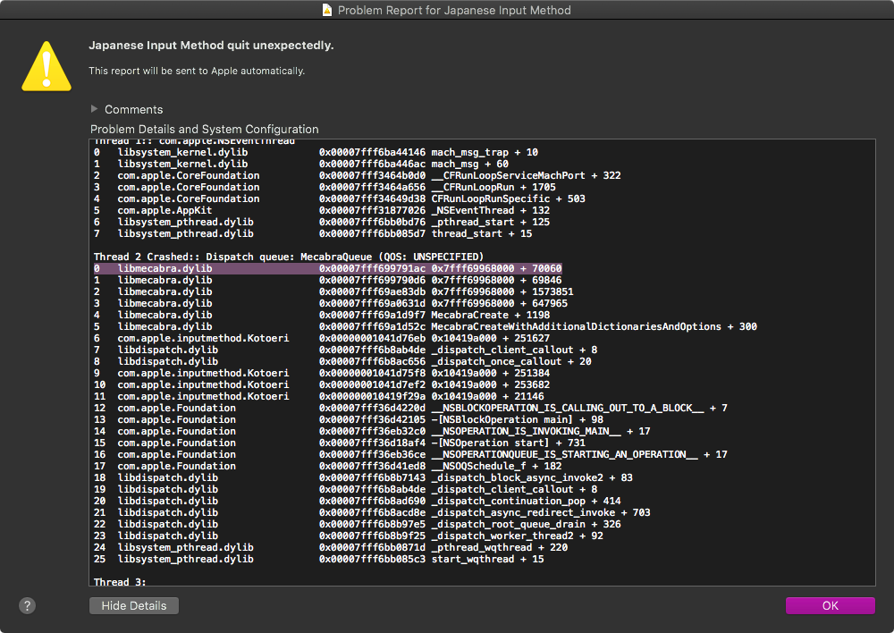

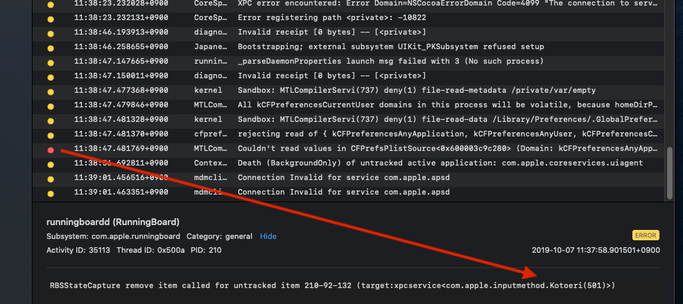

I'm stuck with the Japanese Romaji input giving roman phonetic equivalents of kana. The fact that selecting kana input at Japanese Keyboard Input Sources works (but using the awful kana key layout) to display the correct Japanese character, while selecting Romaji input does not work is weird.
Everybody, including Japanese natives, uses Romaji input and not kana input so this is a big issue for the few Japanese nerds using this patch.
Do you have any ideas dosdude1 (Colin)?

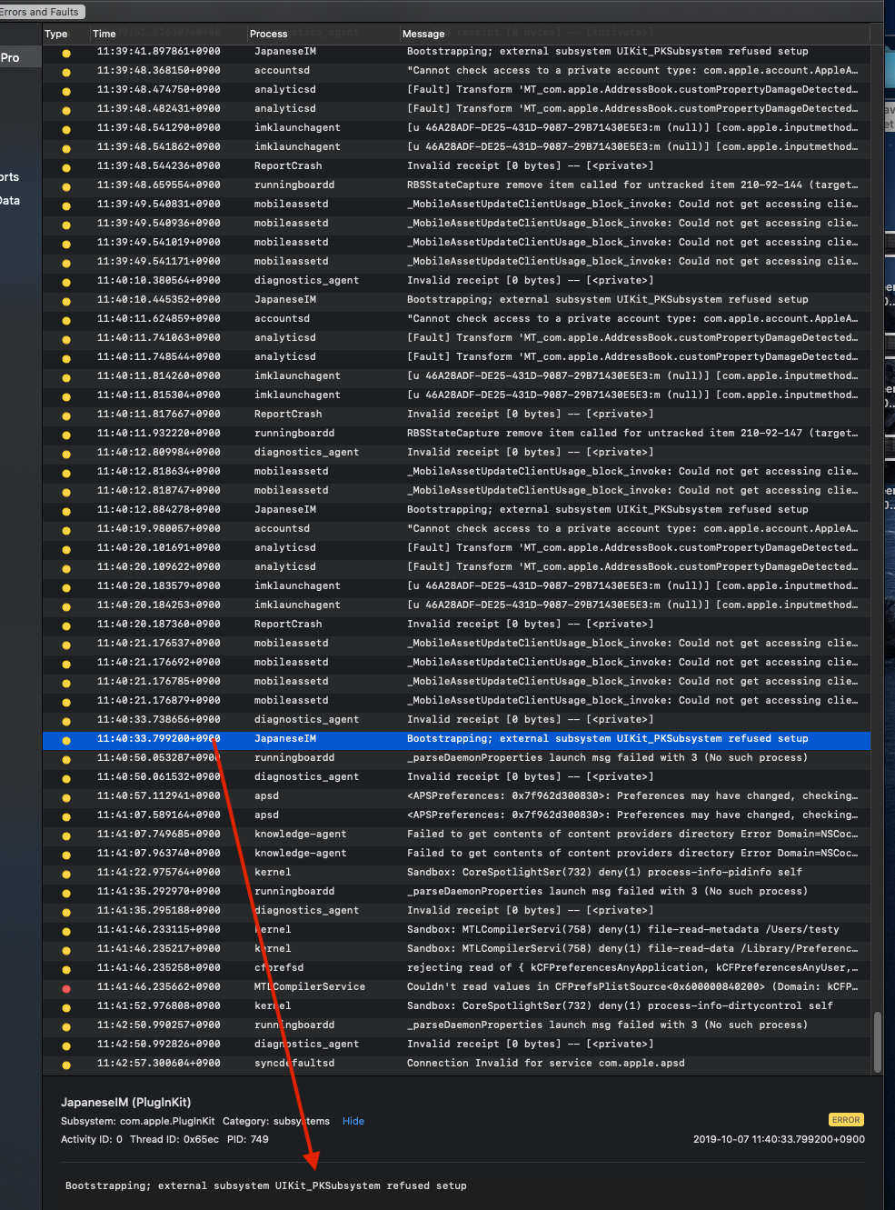

OK. Console is showing Japanese IM and Kotoeri errors, so this is where the problem originates.
I enclose some screenshots.
Do these help?

seems Japanese input was crashed? I also tried to key in some Japanese wording, but it showed English only.
@nekton1 same here. I can't type Japanese also..lol
I am also use Romaji input only.

Thanks for confirming Antony. Perhaps somebody like dosdude1 or JackLuke can figure out a fix for this.

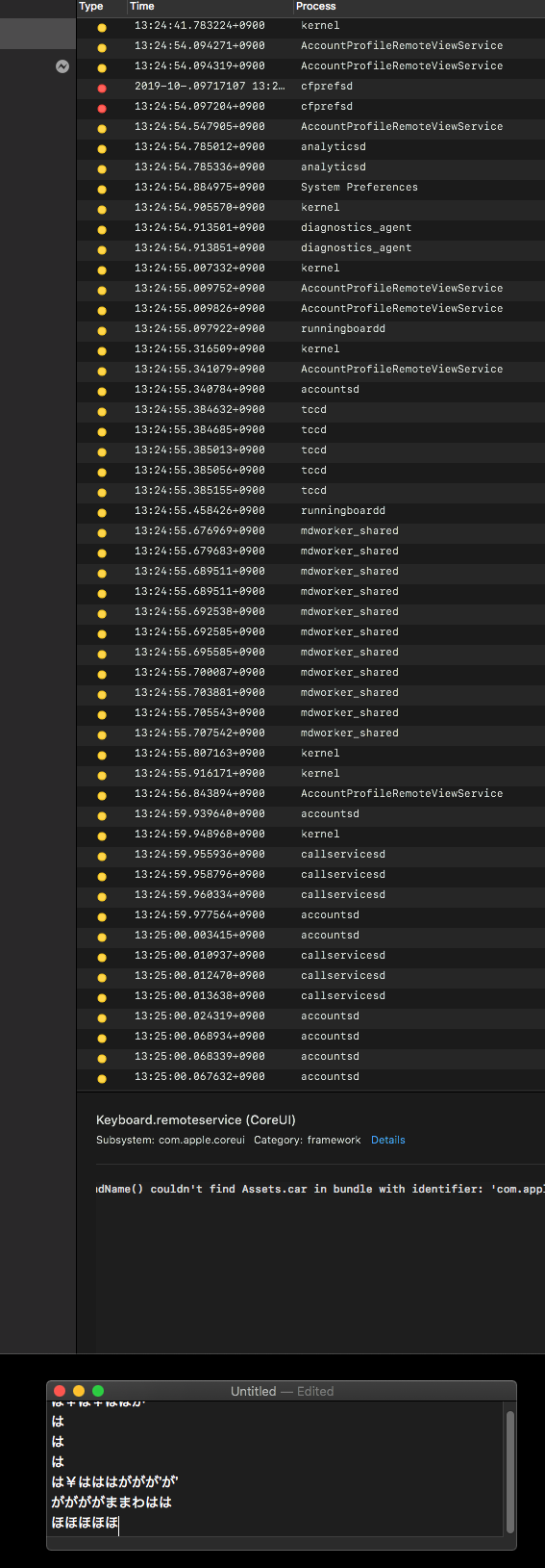

For reference, here is a console from a supported mac in which Romaji input is working and no Japanese IM or kotoeri errors.

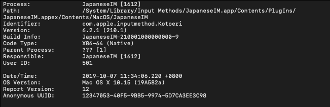

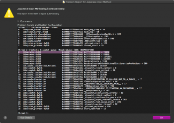

@nekton1 @antony34 I know absolutely nothing about Japanese, but I took a brief look into your issue and I was able to reproduce it.

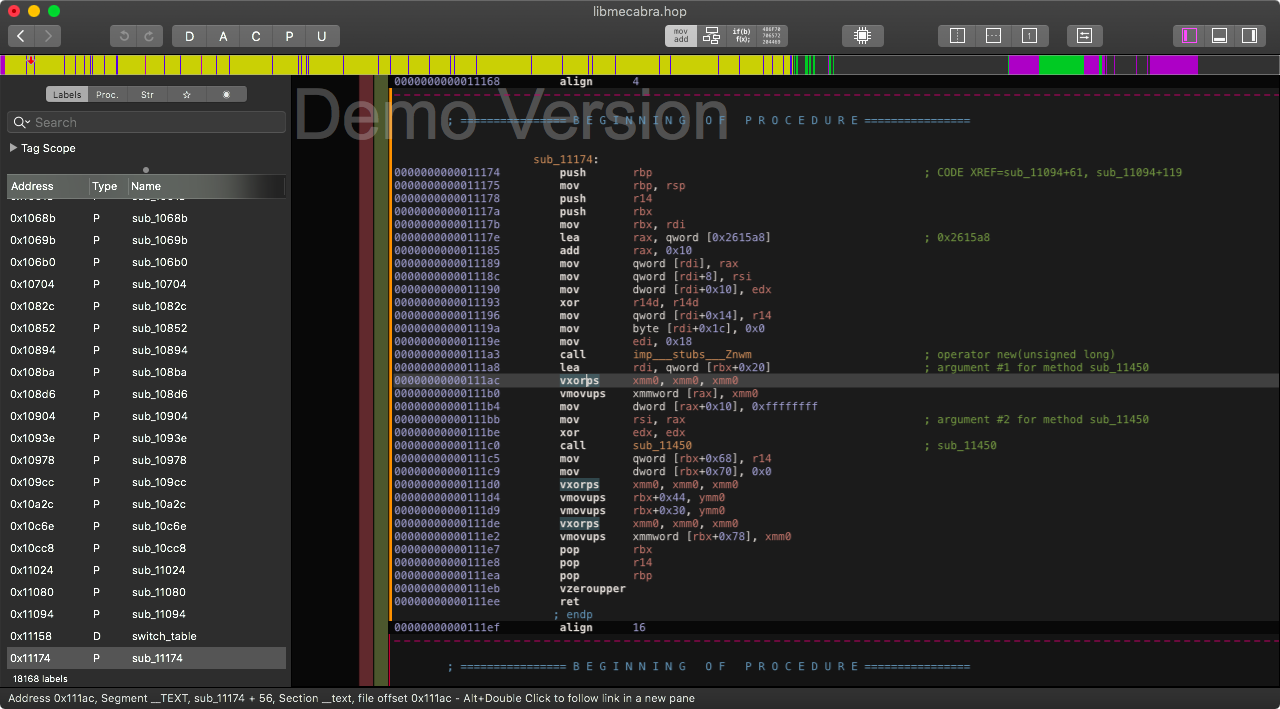

I think I know why this only happens on unsupported Macs, even if they have Metal GPUs: a dependency of the Japanese Input Method process requires AVX, which will obviously be a problem on a Penryn-based computer like a MacPro3,1 or my MacBook7,1.
Evidence
See the crash report:
When I find that address in the executable...
That instruction doesn't exist in our CPUs, hence the Illegal Instruction error.
Possible Fix?

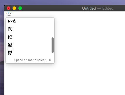

I tried replacing /usr/lib/libmecabra.dylib from Mojave, but this causes some missing symbol errors in /System/Library/Input Methods/JapaneseIM.app, so I had to replace that too.
This gets the plugin working well enough for a text box with Japanese characters to appear when I type (as I said, I know nothing about the language so I have no idea of any terminology here).
Unfortunately, it seems flaky and I still frequently see Japanese Input Method crash reports popping up.
Not quite sure where to go from here... it's progress though, right? :) At least we have a good idea of the root issue, if not a fix yet.
Perhaps someone else has some insight. I hope this helped!

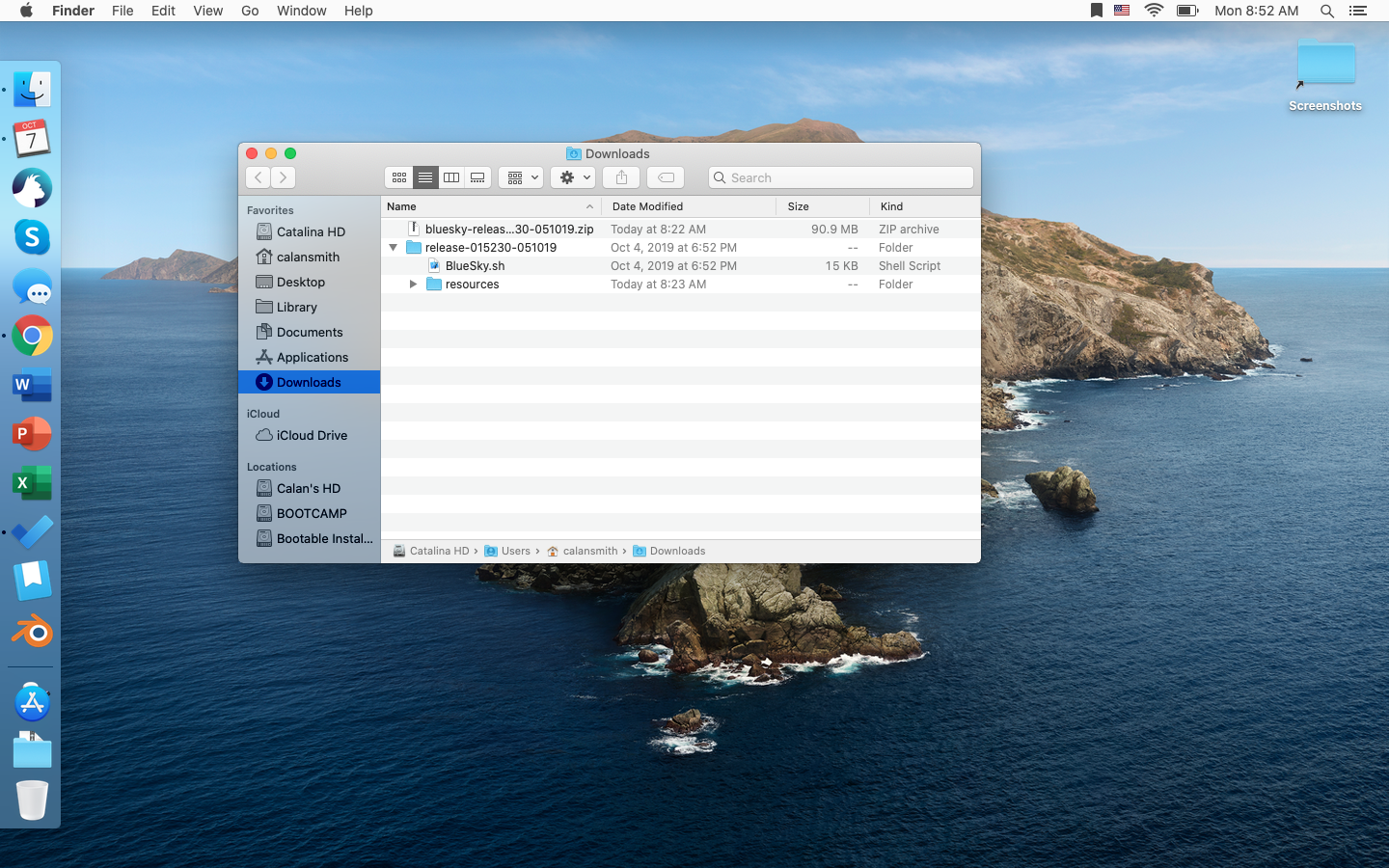

BlueSky Patch works great! Thanks for the help. One note: When I downloaded the file, I couldn't figure out how to run it. I would double click it, and it would open it in XCode. I eventually figured out that if you type "sh ~/Downloads/release-015230-051019/BlueSky.sh" (Assuming it is in your downloads folder) it will run it, and I had to install both SkyLight and HIToolbox for it to work. Installing just SkyLight did not work. It was giving me a root permissions error, so I ran it by adding "sudo" before the command. If someone could include clearer instructions for the install on the github, that would be great.
With BlueSky:
Original (Without BlueSky):

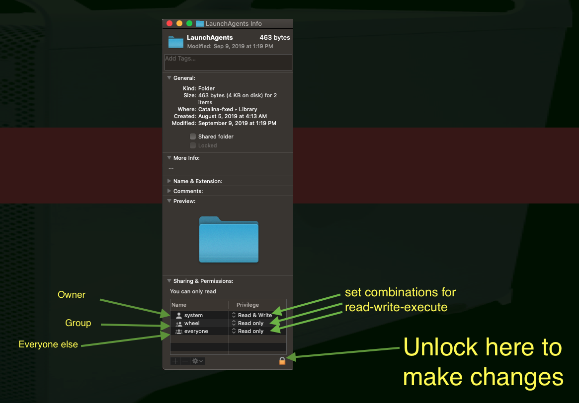

I do not have a direct answer, but I can offer some background that might help.
.. As you do this stuff, it is important to know it is possible make your system unbootable with small mistake. Specifically, if you put a file into /Library/LaunchAgents that is writable by any account except the root account, the system will not boot with the volume containing that condition.
.. It is easy to learn and use the simple commands associated with file ownership and permissions. every file and directory is assigned and owner and group. A group is set of accounts put into a group for managing permissions. Permissions are set as some combination of read-write-execute for the owner, the group, and everyone else. As an example, the permissions might be set as read-write-execute (abbreviated rwx) for the owner, and rx for the group and just r or everyone else. That shows up in file listings as

The d at the start of most of these means "directory" same as a folder. The owner of all these files is dan. The group on all these is staff. The file/directory names are at the right end of each line. The numbers before the dates are file sizes in bytes.I don't know the meaning of the numbers before owner.
There are one commands for controlling the owner/group assignments and one comnmand for setting permissions.
chown sets owner
chmod sets permissions.

to set permissions, you have to translate the rwx for owner, group, everyone else using this:
r=4
w=2
x=1
you add those up for owner, group, and everyone, to give all rights to everyone

drwxr-xr-x 5 dan admin 170 Sep 14 17:27 001_air_force_as_catalina_special_subscripts/
-rwxr-xr-x 1 dan admin 4904 Sep 9 17:54 001_air_force_as_catalina_specialscript*
-rwxr-xr-x 1 dan admin 5723 Sep 9 17:00 001_air_force_specialscript0*
-rwxr-xr-x 1 dan admin 439 Aug 13 03:17 002_first4tb_singlelock*
-rwxr-xr-x 1 dan admin 436 Aug 13 03:17 003_rocketboss01_singlelock*
I know that is a lot to take in, but it's not as bad as it looks and it is intuitive.
You can set these same permissions using finder by get info
Only one more thing more. To apply this stuff to subdirectories at the same time, add -R to the commands like this
chmod -R 755 *
And the other last things:
Those @ signs on some of the file listings means there are extended attributes which means Apple has done mysterious overrides on the ownership and/or permissions. Sometimes they block your ability to change ownership and permissions and you just have to work around that
Last but not least. A lot of times you have to run these commands with root permissions. This applies to a lot of commands not just these. To do this, you precede the command with sudo. Sorry for the prefix, sudo. It means super user do. The first time you use it in a session, you will be prompted for your password.
One of the reasons this is worth learning, these rules and commands change very little over time. They have been in place for decacdes. Another reason is when you understand these schemes for ownership and permissions, it is a big part of everything there is to know about the operating system.
I hope it helps someone.
Thank you for this simple, understandable explanaintion. I'm going to copy this and learn it so I can use it.
Evidence
{removed for brevity}
That's interesting - in your code snippet snapshot, they're effectively using AVX instructions to perform SSE operations (the code uses only xmm registers; they use ymm0 for two loads, but then zero out the high bits before return). If that's the case throughout (perhaps the compiler defaults to using AVX but there are no operands longer than 128 bits), there are at least two possible avenues of recourse: (1) patch the offending instructions in place with equivalent SSE instructions, or (2) add the offending instructions to my SSE emulator. #1 is workable if there aren't a huge number of instances (and could possibly even be automated to patch future versions with the same issue), while #2 becomes attractive if there aren't a huge number of instructions that need to be emulated (implementing the entire AVX instruction set is way beyond the scope of my little project).
(Obviously, if an earlier beta library fixes the problem, that's likely to be the best and easiest solution, assuming there are no bad side effects.)
If/when (mostly a big if) I can find some time, I'll look at this some more. If anyone else is slogging through disassemblies of /usr/lib/libmecabra.dylib, please try to note how many different AVX instructions you encounter.
