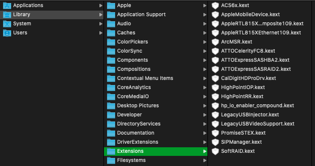

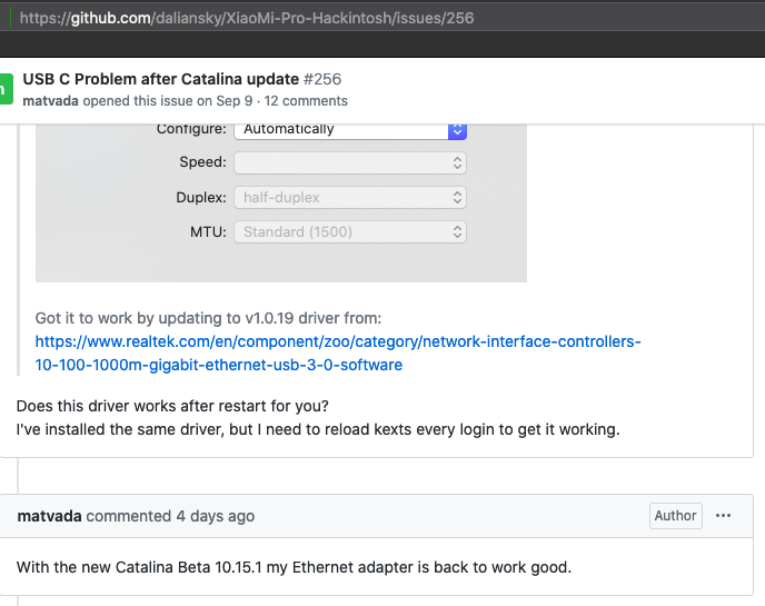

I found the following information:
After installing the driver v1.0.19 from Realtek I get the following:
- the adapter works until it is removed. Then, when I plug it back, it is not working.
- if I boot with the adapter plugged, then it works (until i remove it. then it won't work again).
- if I boot without the adapter, it won't work when I plug it in.
Apparently this affects unsupported macs (Catalina Patch) and hackintoshes, but not supported macs running Catalina (native support as usual)
Apparently, this might be solved in 10.15.1, at least on Hackintoshes
Any idea?
Note:
My unsupported mac running Catalina (upgrade from High Sierra):
both the AppleRTL815X kexts come from the Realtek driver v.1.0.19
my supported mac running Catalina (fresh install):
(the adapter works normally on this machine)
On both macs, AppleRTX815X.kext is absent from S/L/E/IONetworkingFamily.kext/Content/PlugIns
