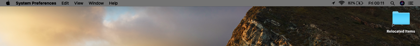

but now I have this problem,
the menu bar is too dark but I have light theme selected
any advice?

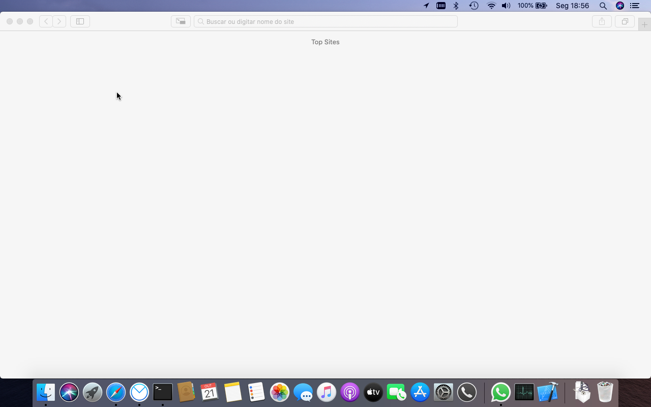

Updating about Metal for HD3000
Seems possible, not function but screen capture and transparency works, but any app load yet.
Still in progress...
Holy crap, you're making progress for sure! If you get this working fully, it will be probably the biggest advancement in this thread so far. Can't wait to see where this goes! 😁

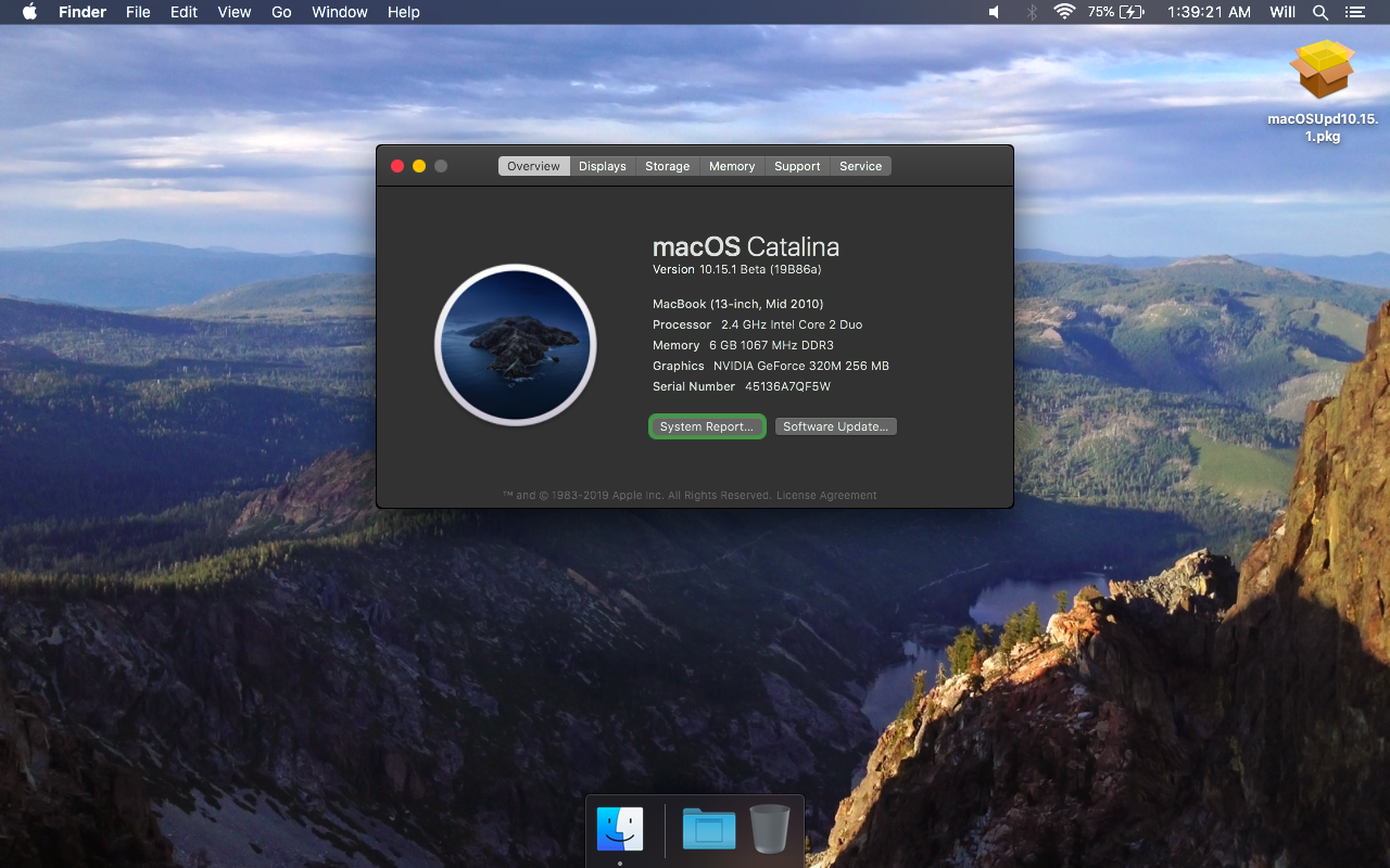

In other news, 10.15.1 DP3 is working on non-Metal systems with no issues (as expected).
Yay.
Edit: @oliveira131, you don't happen to have the legacy video patches installed, do you? If so, they will almost certainly interfere with your Metal project. I assume you know this, but just in case.
Again, great work!
Using your modified "IntelHD3000 Metal driver" Could you make a screen with "dark mode" selected?
Because seems you're in "light mode" but Finder top menu is not really transparent, rather is absent, I mean not loaded, so its upper-right icons take the background picture as "transparency effect", similar thing happens also with a non-Metal (OpenGL fallback) patch, but for few seconds after log-in in Catalina (or Mojave) just before the time Finder top menu being loaded.
I write this because having a Finder top menu transparent in "light mode" means that a Metal API is really loaded in a GPU driver.
