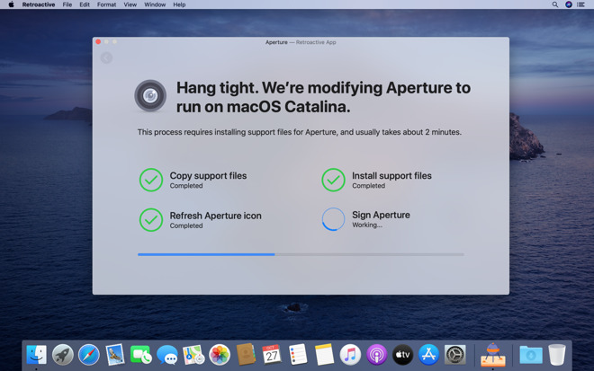

Great news about a patch tool to get the old Aperture, iTunes and iPhoto running on Catalina!
