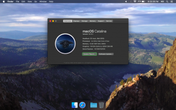

Update went smooth here on my cMP 4,1/5,1. Used Installer v15.1.03 with Patcher 1.2.1 and 'installed to this machine'. No problems creating an Installer volume either, took only a minute on an internal 16GB HFS+ volume.
Navi drivers, yay!

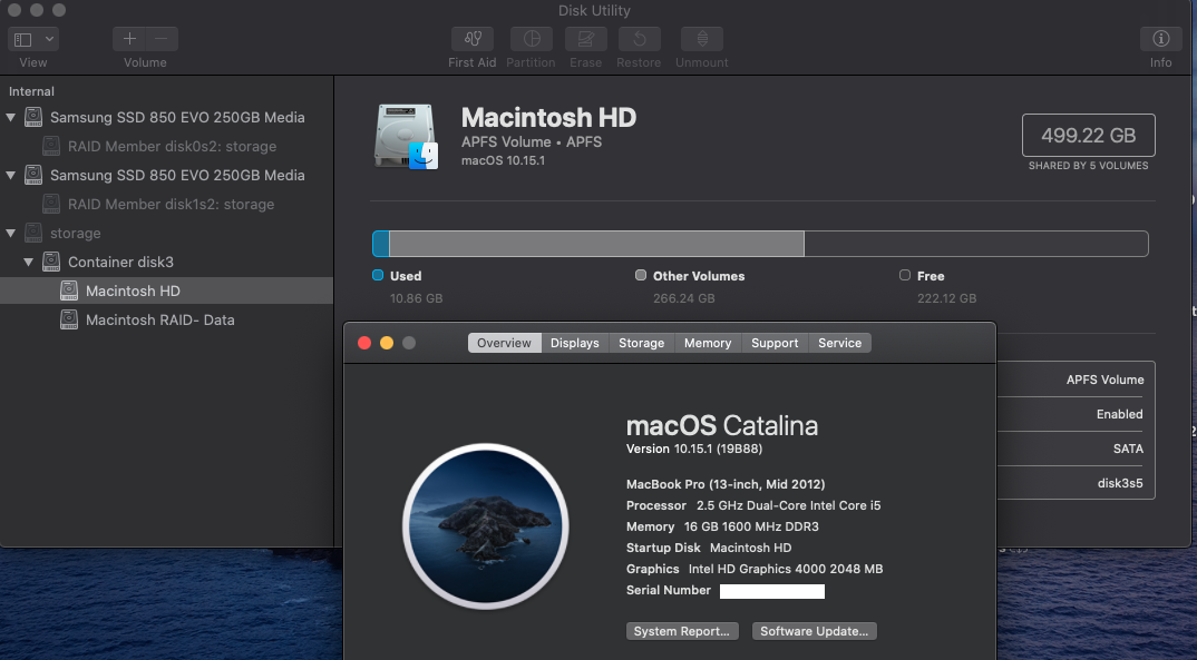

Hello,

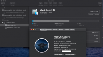

Can anyone confirm if this patch will support RAID 0 configured under APFS?
This member mentioned that it is supported but my RAID drive is greyed out when trying to install it.
Any help will be appreciated
I've followed that method with my supported 2012 Macbook Pro configured APFS RAID 0 with latest Macosx Catalina 10.15.1 release today and its working fine, just need to rename bootcaches near the end to complete installation.
