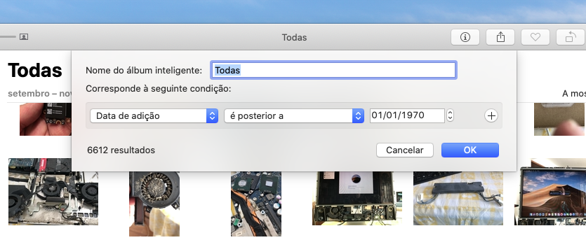

Thanks everyone for your advices. I was able to install Catalina on my Macbook Pro Mid 2009. iCloud Photos is working, however it's currently stuck on downloading a few originals (strange, because everything seems to be there and sync is working fine).
