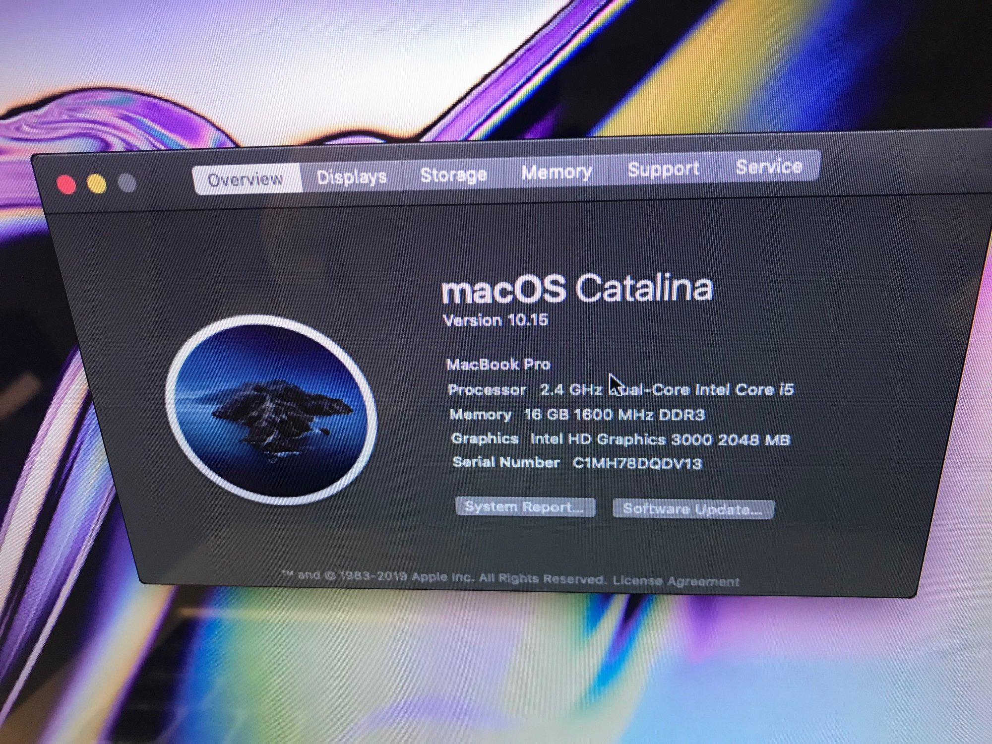

Could you please post up what you did to get it to work, I've tried a few times with no success.
I did the following
Code:
sudo mount -uw /
sudo cp -r AppleIntelHD3000Graphics.kext /System/Library/Extensions
sudo cp -r AppleIntelSNBGraphicsFB.kext /System/Library/Extensions
sudo chown -R 0:0 /System/Library/Extensions && sudo chmod -R 755 /System/Library/Extensions
sudo kextcache -i /
sudo reboot
and it still reports as 512mb not 2048mb
Yes, use the method outlined here : https://forums.macrumors.com/thread...unsupported-macs-thread.2121473/post-26343097
Make sure you use : mount -uw / before you begin any commands to allow writing to protected folders in Catalina.
Reactions: TimothyR734
I did the following
Code:
sudo mount -uw /
sudo kextcache -i /
sudo reboot
Check this thread (last post by jackluke):
https://forums.macrumors.com/thread...cs.1766384/page-9?post=28071534#post-28071534
Download the kext files here:
https://forums.macrumors.com/thread...ed-macs-thread.2121473/page-199#post-26343097
Choose the desired VRAM size.
But before replacing the kext files you downloaded, open terminal and paste this line: sudo mount -uw / ; killall Finder
Then, go to System / Library / Extensions and replace both files
After that, go back to terminal and copy this whole line (copy and paste all at once):
sudo kextcache -i /
sudo reboot
Wait until your mac reboot (it may take a while). DONE!!!
It worked for me (MacOS 10.15.2)
I did the following
Code:
sudo mount -uw /
sudo kextcache -i /
sudo reboot
Probably because the dosdude1 catalina patcher you used copied the Video patch kexts in /Library/Extensions/ rather than /System/Library/Extensions/ , so try to replace my patched kext there and they should work.
Hello Jowaju, (and Jackluke)
Is there an advantage/improvement to increase VRAM on a MBP 8,2 core i7 16GB RAM (w/ disabled dGPU) with Intel HD Graphics 3000 512 MB switch to 1GB? Not running any games or intensive graphic use apart from sometimes large PShop 2020 files and rare basic video editing? Thanks
