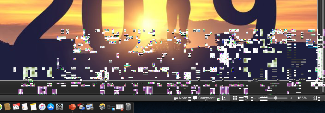

Ehi, guys could you please help me?
I am using a Mac Pro 3.1 with 15.1 and a GTX 660 card. OK, I know that 660 is not supported and, as suggested by *******, I bought on eBay a GTX 680, mac version. But they will deliver it only in 15 days...
So I ask for your help. The board runs rather well, but from time to time it begins to clobber the screen (see below the image) and I have to shut down and restart. I did the same test with patched High Sierra, Mojave, and 15.2: same problem (by the way: the patcher is very good and I can install with no problem and repeatedly all those patched OSs). The board has no problem with El Capitan.
Any idea? Mille grazie...
I´m glad you could find a GTX-680. You´ll see, everything will work like a charm.

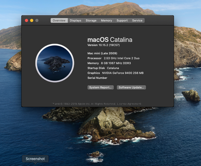

Sixth try was a charm.🥴 The patcher v1.3.0 which finally made an "un-damaged" USB installer had a generic icon. Dot 2 now runs fine on this barefoot late 09 Mini3,1 as did dot 1. The successful patcher ran from the D/L ƒ and the installer resided on a HFS+ partition with no OS installed. Also, I quit the patcher and ejected the USB installer prior to reboot>option. YMMV and don't give up.
