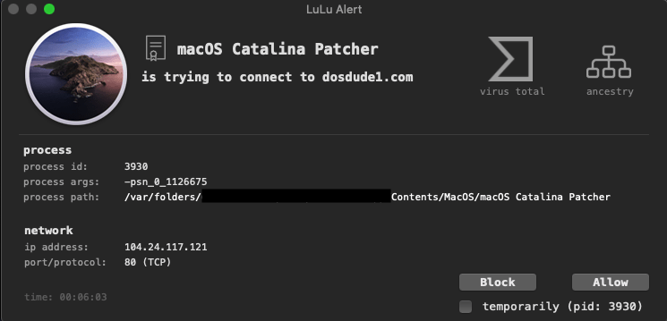

Anyone know why the patcher needs to "Call home" after finishing the creation of a boot drive?
Do you have any 3rd party app installed. I see lulu alert on the image you posted. So far we never faced any of such issue .

It's for the success/failure tally I keep track of with the tool. It helps me a lot in catching and rectifying issues/bugs with the program.

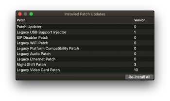

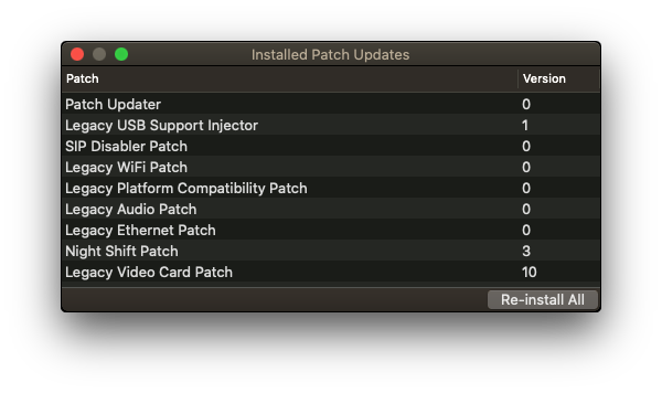

So can you see if it is a common problem that the install of the NightShift patch doesn't work (forbidden sign) on Catalina 10.15.2 or is it just me (Mac 11,1 - late 2009 i7)?! ;) I'd love to get a fix...
MBP5,2 running 10.15.2. I have no problems with NightShift. Installed it with Patch Updater after installation of 10.15.2 with dosdude's bootable USB installer made with patcher 1.3.0. These are the present patches on my system reported by Patch Updater.

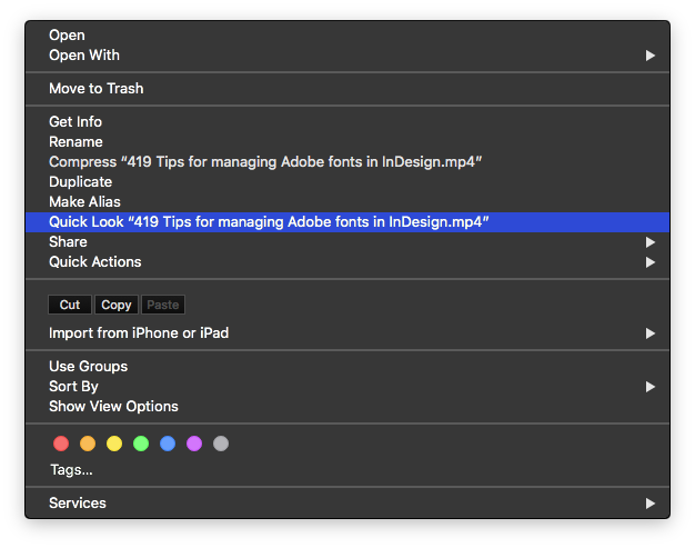

@dosdude1 my right-click many stretching I don't get it why? sometimes it is stretching edge to edge. do you have any idea why this happening? Restart fix this but afte for a while its stretching again.
It's just because of the length of the file name.
Don’t think so cause I tried with short file length. It’s probably will happened again edge to edge this night I will add a new picture then you will see what it’s exactly happened.
BTW this is not happening with just files. It’s happening also Drive, folder, file, it’s all on right click action.
