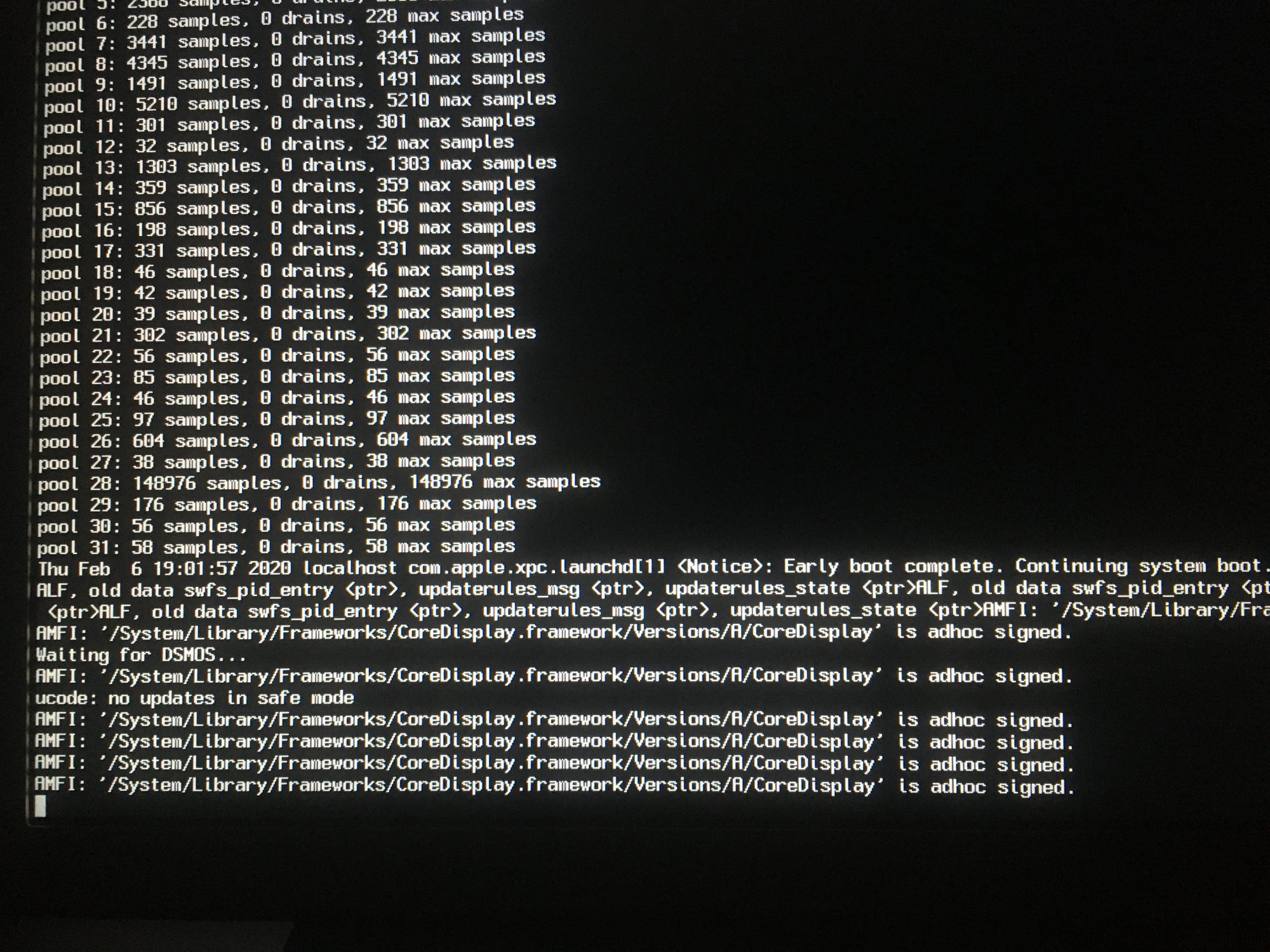

Yes, on my MBP5,2 I also get the ad-hoc-signed messages, regarding CoreDisplay only.
I already happens right after OTA and post-install patch with 1.3.0, including the legacy video card patch, see post #8203.
Then I replaced the CoreDisplay+CoreDisplayOriginal in
/System/Library/Frameworks/CoreDisplay.framework/Versions/A/
and SkyLight+SkyLightOriginal in
/System/Library/PrivateFrameworks/SkyLight.framework/Versions/A/
with the versions provided in your post #8213.
No change, the boot process still hangs at the same place.

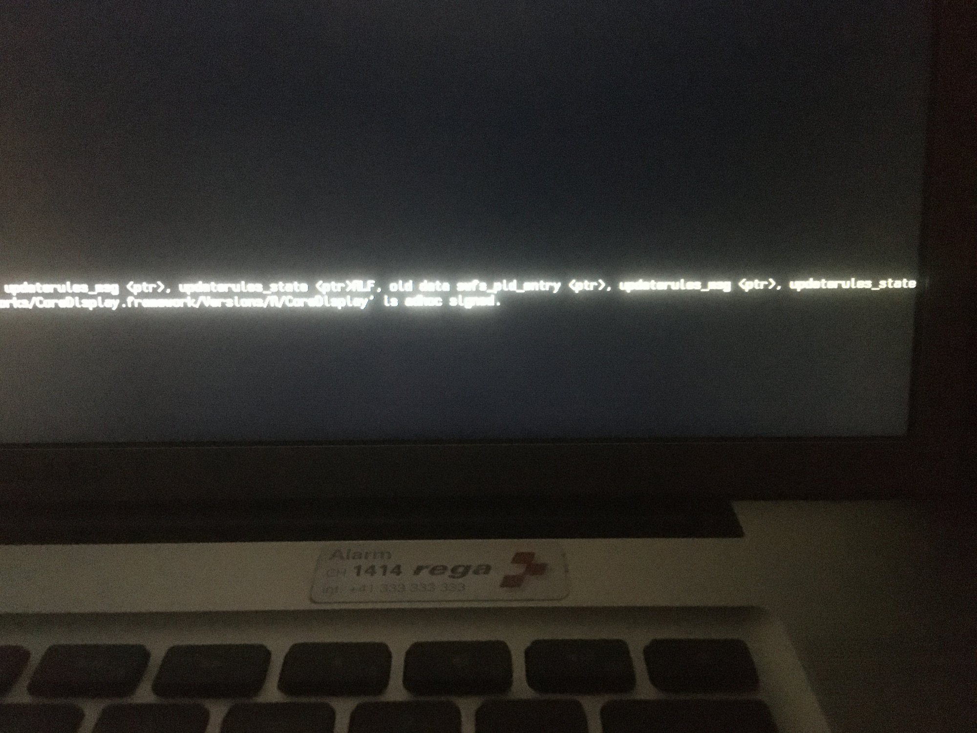

Photos taken at the time when the boot stalls are attached (left and right part of screen). Looks the same when using safe mode.
Looks like a change in 10.15.4 causes this as it happens already with the versions used in patcher 1.3.0 ?

Apparently apple have enforced their AMFI signature security checks, I'd exclude that OTA swu script has done something wrong for a simple reason, if you use only these stock untouched from Catalina 10.15.3 or 10.15.4 :
CoreDisplay.framework , OpenGL.framework, SkyLight.framework, GPUSupport.framework, the 10.15.4 system will still boot correctly to the GUI mode (without video acceleration) from an unsupported mac.
Meanwhile you could try this from a recovery or installer terminal:
nvram boot-args="-no_compat_check -v amfi_get_out_of_my_way=0x1"

I just set the boot-args as you said.
The boot process still hangs with the same adhoc-signed message for CoreDisplay...
There may be more AMFI options ?

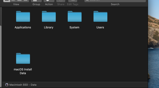

Anyone know how to get v.1.3.0 "Install to this machine" installations to complete? When attempting to install 10.15.3 onto a Mini3,1 APFS SSD which has 10.15.1 running great, the first '6 minutes remaining' ran but after the mandated auto-reboot, the installer fails and leaves a 8.5GB ƒ "macOS Install Data" on top of the target "Data" drive upon rebooting. Only since v.1.3.0 have installer issues cropped-up. v.1.2.3 was perfect as were all the Mojave patchers. High Sierra was fine, too.
Screen Shot 2020-02-07 at 9.36.20 AM.pngScreen Shot 2020-02-07 at 9.37.49 AM.png
View attachment 893019View attachment 893020
From the the Catalina Patcher I would set the macsOS Install Data as the startup disk to finish install Catalina or pressing the option key on your keyboard while booting and selecting that one
The "macOS Install Data" if I don't get wrong is only a mount point on the "APFS Data Volume" contained as a simple stage2 installer folder, that apple creates to install the APFS system update (otherwise they can't overwrite system core files) , from Catalina this mode is a similar concept as OTA updates perfom.

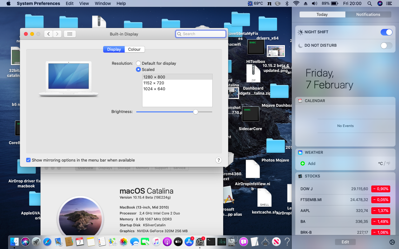

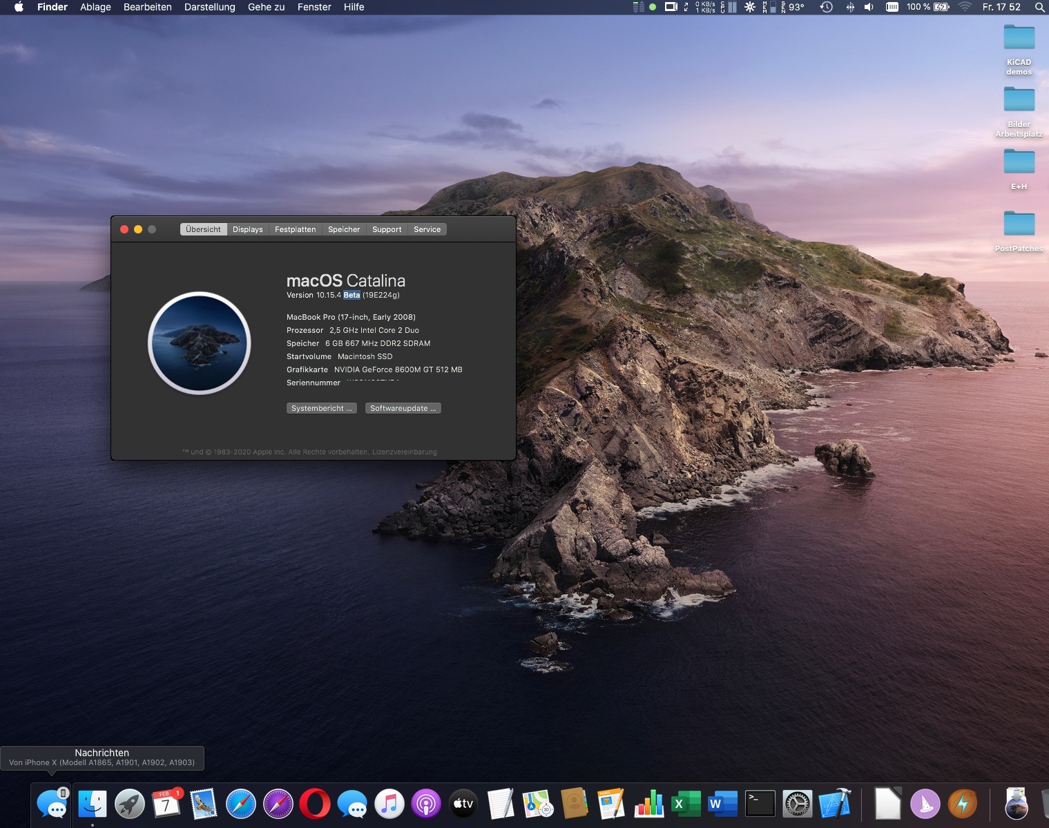

Great news (for my old MBP4,1 anyway) - got the 10.15.4 beta 1 up and running with NVidia GT full acceleration! And discovered that Handoff actually works better than ever, displaying running active Apps on the iPhone in the leftmost section of the dock. Never had that on my old machines yet ;-)
Here´s what I did (thanks to the previous findings @jackluke @ASentientBot et al !):
- changed to the correct SWupdatecatalog to get the 10.15.4 beta 1
- downloaded it via system settings panel
- used the catalinaswufix.command (still v2, I admit ;-) / newer editions should work fine as well)
- installed the 10.5.4 beta 1 by rebooting
- after installer reboot, booted USB patch stick (v1.3.0 of dosdude1´s installer), did all 4,1 specific patches
- booted into single user mode, set amfi_get_out_of_my_way=0x1 in nvram boot-args
- /sbin/mount -uw / to get write access to the S/L/E folder
- delete NVDAstartup.kext
- exit-boot to login
- use kext utility to install DisableLibraryValidation.kext
- rebuild caches & reboot
At this point I reached the login to Finder, but of course still without acceletion due to missing NVDAstartup.
- re-installed NVDAstartup.kext and again after cache rebuild did a reboot
Voilá -> all running fine with accel again!
(Somehow, the patcher cannot bring accel back in one go, instead window service seems to crash before login then - that´s why I did the detour above).

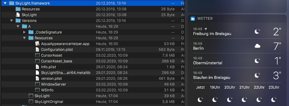

That said, just one question, your current SkyLight.framework/Versions/A/Resources/ path of Date modified files match with this I posted (I mean especially the WindowServer exec) ?
https://forums.macrumors.com/thread...ge-330?post=28200653#lg=post-28199827&slide=0
Reactions: TimothyR734

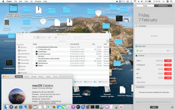

Seems to be the same mod date, see screenshot:
And yes, there is some additional install stage that you noticed. But my impression was that I´ve seen this since some 10.15.3 (or a bit earlier) beta back then..!?

Dyld Error Message:
dependent dylib '@executable_path/../Frameworks/libgnsdk_dsp.3.06.1.dylib' not found for '/System/Applications/Music.app/Contents/MacOS/Music', tried but didn't find: '@executable_path/../Frameworks/libgnsdk_dsp.3.06.1.dylib' '/usr/lib/libgnsdk_dsp.3.06.1.dylib'
Tested more programs, ahem, "Apps":
These work without hickups: Mail, Pages, Numbers, Calendar, Stocks, TV, Messages, Safari, M$Office 2019, Preview, ...
Yes, they match, infact the 3 February 2020 is when apple developers compiled their exec before packaging for 4beta1 release.
This confirm that I have a different issue and ASentientBot wrappers worked correctly.
Thanks @ASentientBot for your 10.15.4 beta1 wrappers, my issue was due to some mismatched replacement or permissions, FYI the Display.prefpane is correctly showed. Only night shift tab not shown after patched CoreBrightness with pikeralpha method, but the NotificationCenter button worked and warm colours are night-shifted properly.
@Larsvonhier I used the catalinaswufix3.command so I'd say that Pinarek OTA update method is still valid, thanks for your tips.
TimothyR734 and jackluke -
• Just now, made a fresh v.1.3.0 USB 10.15.3 installer. Came back "damaged."
• The macsOS Install Data ƒ does not appear in any start-up manager under any circumstances.
But thanks for the suggestions.
Reactions: jackluke
Because if the stage2 installer failed, the "macOS Install Data" is automatically deleted at next auto-reboot, so I guess you should retry a new usb thumb drive or this "damaged" is due to some AMFI check.
In case it's some kind of security check, try this before install the next Catalina major build:
