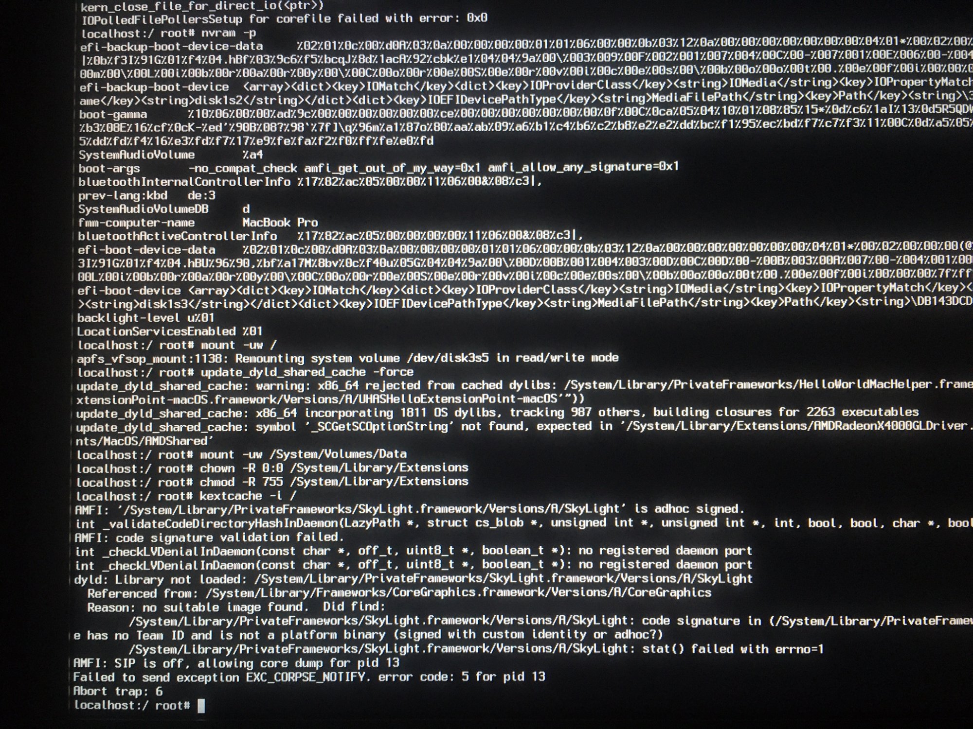

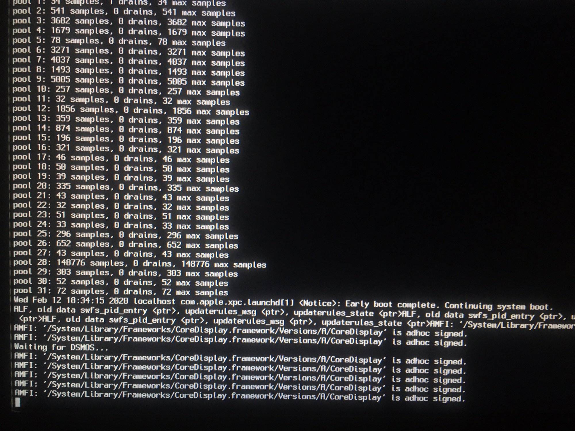

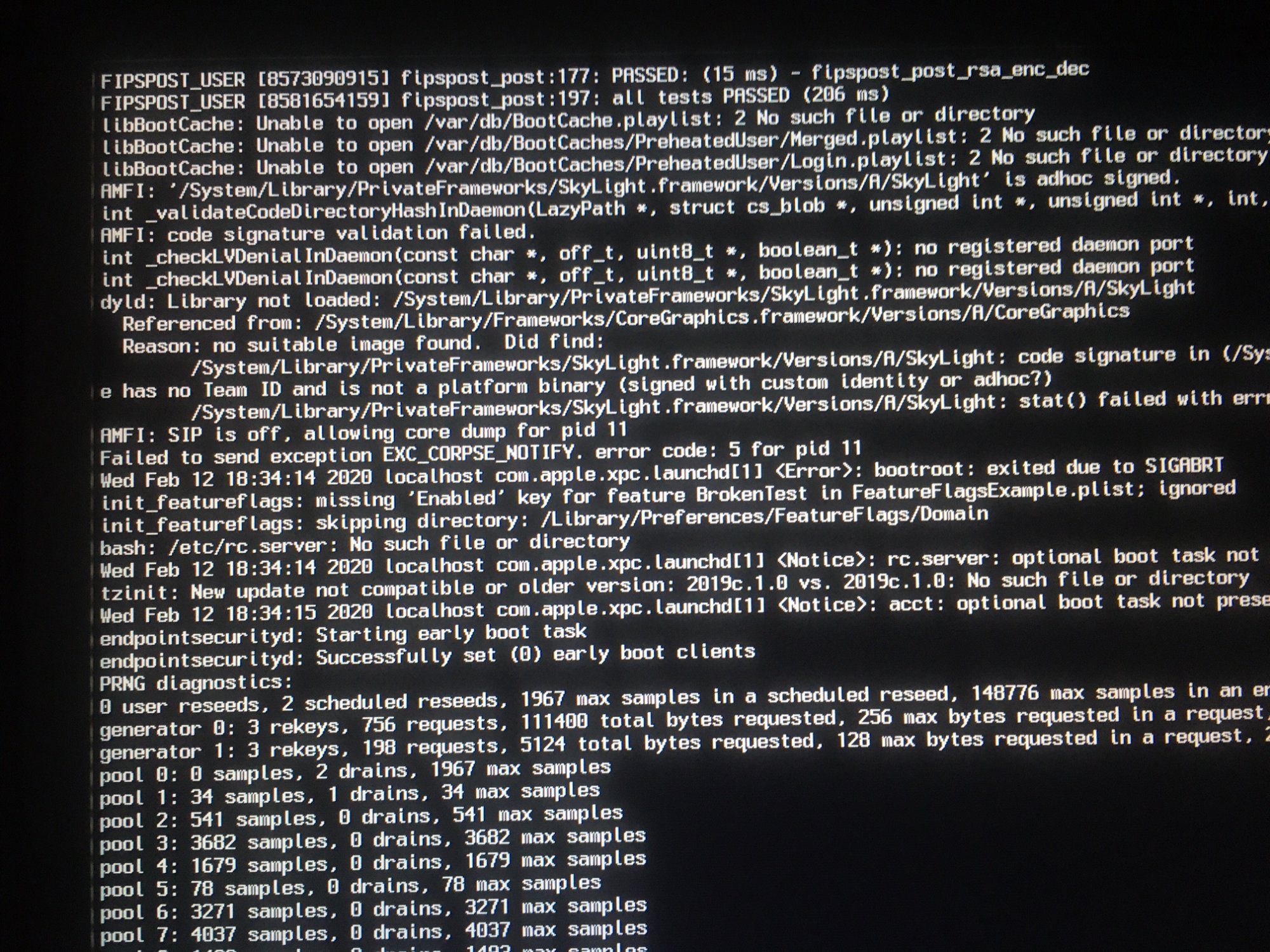

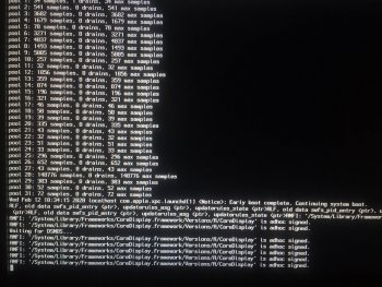

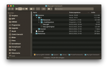

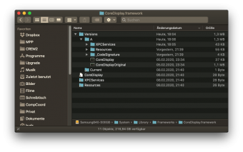

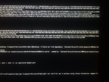

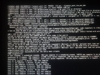

Thank you jackluke. But no success, can't overcome AMFI yet.

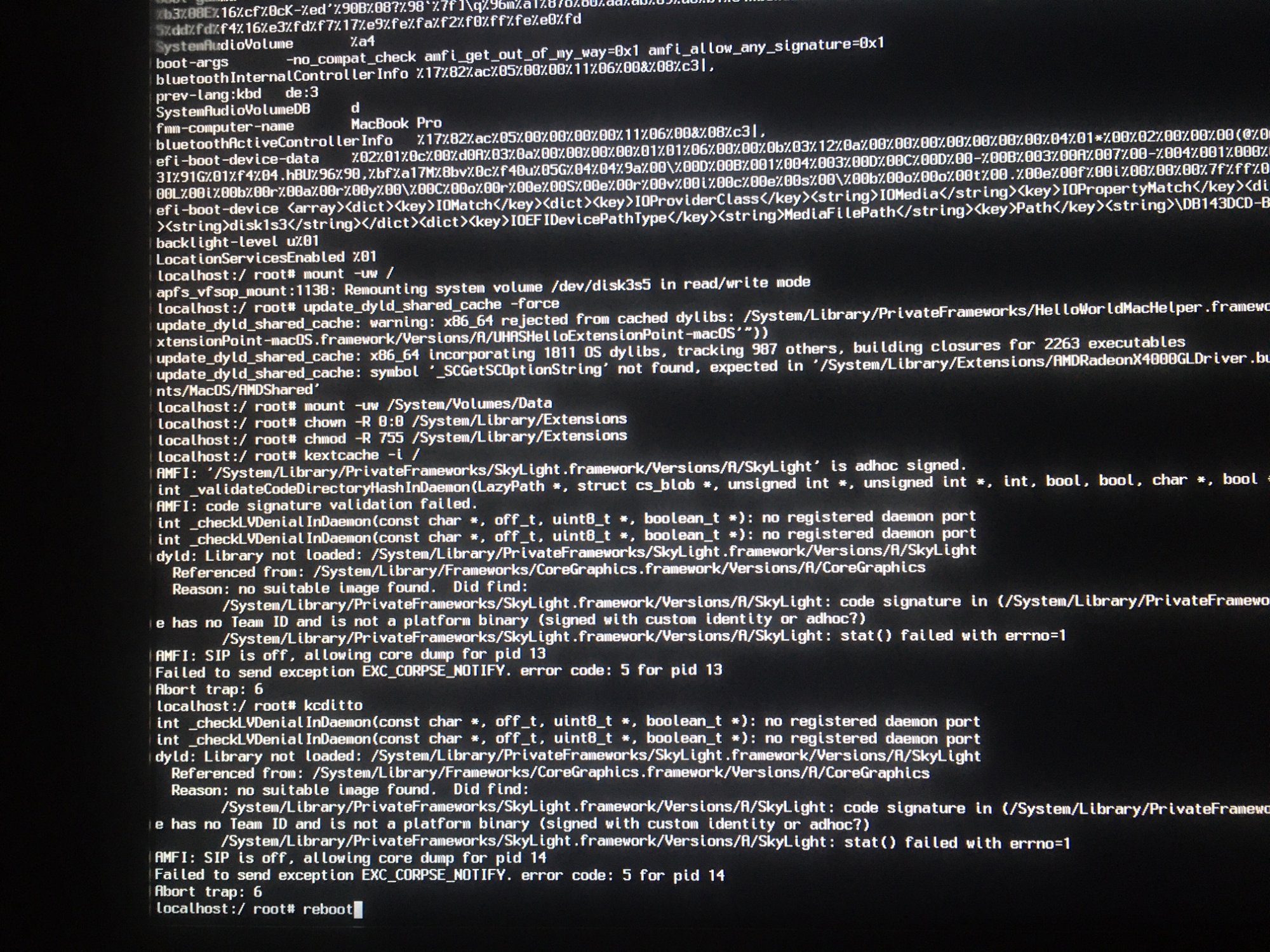

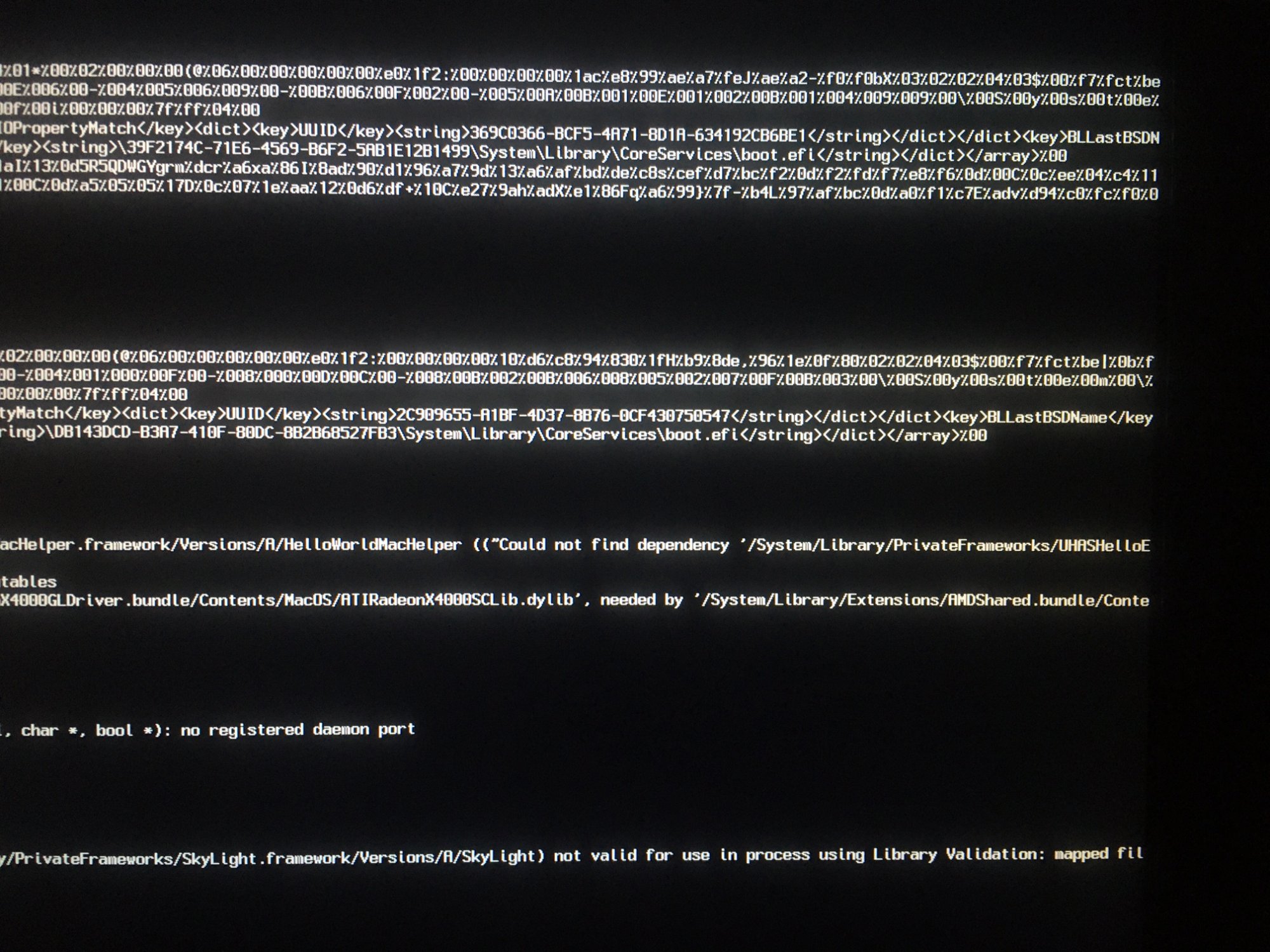

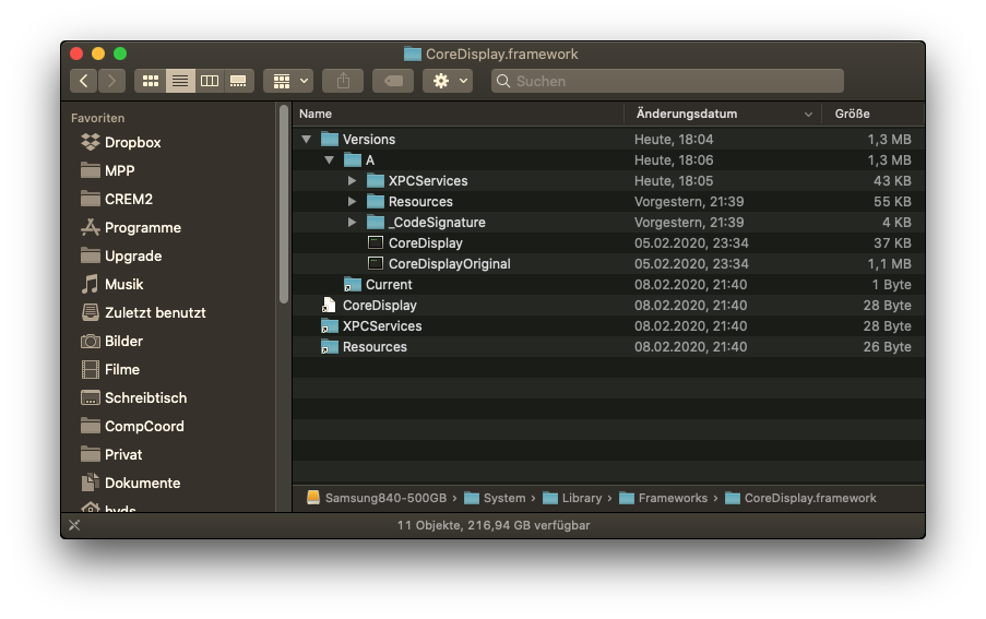

From running 10.15.3 on the internal disk:
- disk utility reveals no errors in the external .4b1 disk
- replaced on the .4b1 disk CoreDisplay+CoreDisplayOriginal and SkyLight+SkyLightOriginal from ASentientBot's attachment (see photo 1+2)
- removed the -v from boot-args in nvram.
Booted into .4b1 in single user mode:
- verified that boot_args are as desired
- did your proposed steps, see photos 3+4 (adjacent parts of screen).
There are some (probably harmless?) warnings in the update_dyld_shard_cache step.
But then in the kextcache step, AMFI complains about SkyLight signature.
Similar in step kcditto (photo 5)
- then after reboot, the AMFI errors for SkyLight and CoreDisplay happen and boot stalls.
I could still try the DisableLibraryValidation.kext, or else try the .4b1 full installer that Pinarek has found.
Anyway, thanks a lot and sorry for the trouble.
You done all correct steps, I had same your verbose messages about AMFI, but after I set those "amfi strings" in nvram it worked without those warning messages, so for now can't explain why on your machine AMFI can't be disabled (maybe a PRAM reset could refresh this).
If you want to try DisableLibraryValidation.kext (this will break Music.app and some other apps) you need to put it in .4 beta1 SLE or LE and rebuild a kextcache with it but seems from single user mode AMFI prevents it too, because during prelinking there is some frameworks integrity verification.
I guess there is no .4b1 full installer (or any dp beta full installer) available.
So another attempt is from the other Catalina volume, copy the DisableLibraryValidation.kext on .4 beta1 SLE (you should chown/chmod that kext or the entire SLE path) and then you should rebuild the kextcache from the Catalina patcher (Force rebuild cache), maybe re-apply all the post-patches for your machine but de-select the "Video Patch" in order to keep the right ASentientBot wrappers that you already replaced.
You might try using this patch when replacing the wrappers this goes in /Library/LaunchDaemons folder this is helpful if you forget to killallfinder in the terminal as the allow for changes but I would reboot after using this so it does take effect

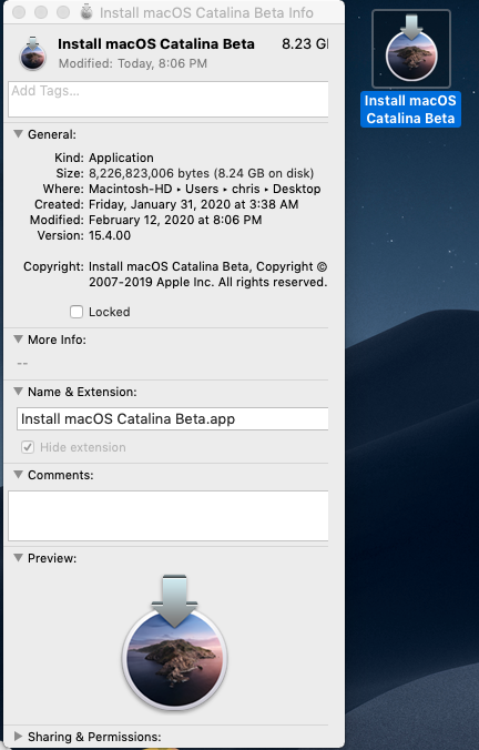

So to all doubters (Mr. *******) who think that my posted file is not a full installer, I want to tell them that it is a full installer of the Developer Beta 10.15.4 DP1, just like the paying developers download from Apple.
Unfortunately, it cannot be installed on an unsupported Mac; this requires a new Catalina patcher version from Mr. dosdude1.
When I try to install it on an unsupported Mac, I get the error message that a Catalina at least 10.15 is supposed to be installed. Such nonsense, I have the 10.15.4 DP1 on a partition, which is supposedly not the one Apple wants it to be.
Then I just have it on my Hacki PC-2 (see my Sig.)
successfully installed as a clean installation on an extra empty 512 GB SSD. There were no problems.

@chris1111 you probably made a mistake, you probably mean Catalina 10.15.4 DP1 not 10.14.6 (Mojave)
did you download the build from my link and installed it? then you see that it is the 10.15.4 DP1!
ok @chris1111 when you have finished downloading and installing, please let me know.
If it's not Build 19E224g, then I'll eat a broom.
Above all, why do you doubt it? do you think the paid developers get an update from 10.15.3 or what? The developers also want to install Clean this 10.15.4 DP1 and this version is intended for that.

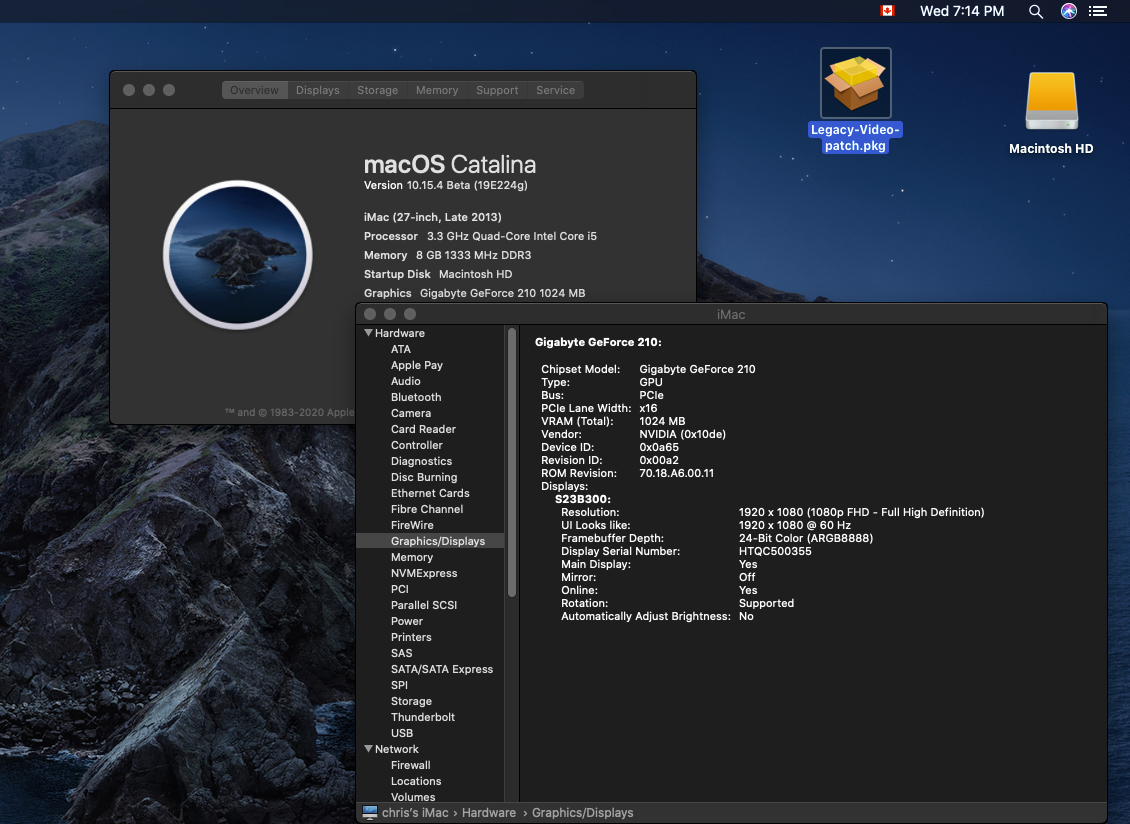

This is Fresh install testing is
DONE :) Thanks to you @Pinarek
Thanks to @ASentientBot for the Video patch
For those who have a mid 2009 macbook 5,2 I can confirm this patch works in macView attachment 890967OS Catalina it goes in /System/Library/PreferencePanes but first you unzip and right click to rename it and edit out theMB52 part then delete the one in your /System/Library/PreferencePanes and replace it with the new one

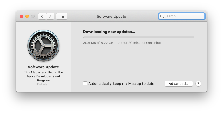

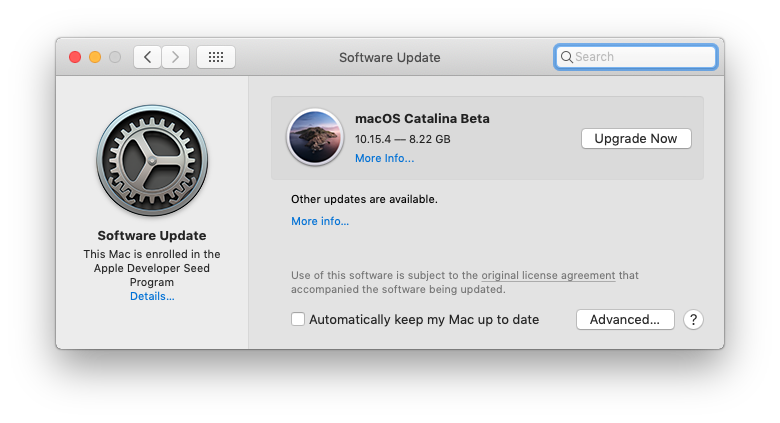

Right, apple through OTA delivers a full Catalina beta installer only from Mojave software update (and maybe HighSierra too) if the machine is enrolled in the dp beta program.
But example from 10.15.2 (I tested) the same procedure downloaded 4,66 gb that is an OTA 4b1 package, instead starting from 10.15.3 downloaded 2,93 gb.
I mean according to the osx installed apple from software update delivers dynamically a different package.
It is purely Mojave's magic, High Sierra on unsupported machine would not download full installers.
Infact, this should be an exclusive feature of Mojave's Software Update (with a beta enrollment), because I don't recall that during previous OSX was possible to download any DP beta full installer.

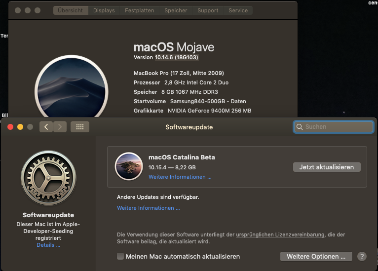

Very good - that looks like the right way forward for me getting 10.15.4b1 onto my Apple MBP5,2. Thanks!
I've installed Mojave 10.14.6s3 over the 10.15.4b1 on my external SSD. This was slightly foxed anyway, plagued by AMFI, and resisted all attempts to get .4b1 to boot. The last try was resetting nvram (and setting boot-args to -no_compat_check again), but no change.
(Good that I still have all the older USB installers on a disk, the whole dosdude et al success story!)
I observed that while booting Mojave, AMFI was still not quite silenced, complaining about the dyld cache, but caches were remade automatically, and Mojave came up.
This Mojave is good enough for its sole purpose of loading the full 10.15.4b1 installer. Did that and copied it from Applications to my internal SSD which has 10.15.3. I am subscribed to the developer program.
(Meanwhile I have Mojave on a surplus HDD to be prepared for future Catalina betas.)
I also tried to install the loaded 10.15.4b1 directly, without patcher's help, from the running Mojave. But I stopped it when the installation process said that the machine needed a firmware upgrade.
Then made a bootable USB installer from it with patcher 1.3.0. That worked, now trying to execute installation steps carefully to see if AMFI will eventually kick in.
