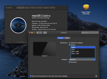

In my case it looks normal.
(by the way, is your screen background photo from the Harz?)

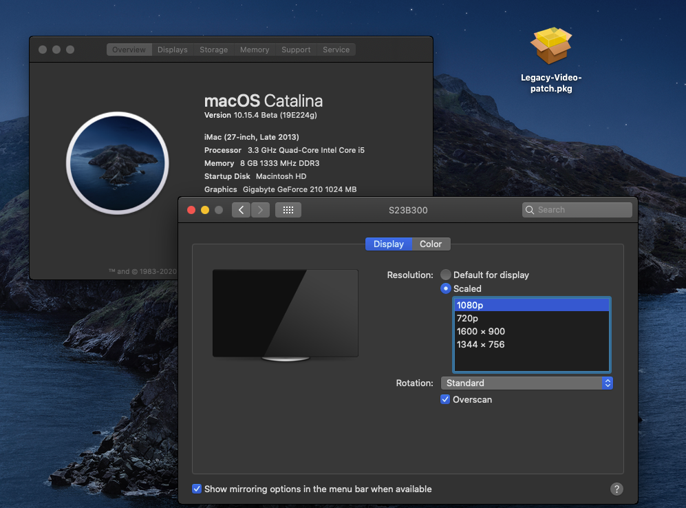

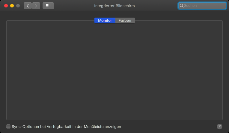

On two systems of mine (HD3000 and Nvidia 8800 GT based) the tab for monitor (screen) options is there, but without any content. Seems to be a widespread issue.

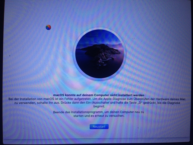

Hello everyone,
I am brand new here in this forum and this is my first post.
I have a MacBook 7.1 mid 2010 with 8GB RAM and original HDD with 250GB, formatted with APFS.
Thanks to Dosdude's Mojave Patcher, the MacBook with 10.14.6 works very well. However, if I install the security update, the MacBook becomes unusable.
I've tried a few times with the Catalina Patcher to install Catalina but it doesn't work.
With the patcher I created the USB installer and start the MacBook from this installer. Then I add a volume “Catalina” to the container and install Catalina.
Catalina is installed and after about 20 minutes the screen goes black and the loading bar appears again and reports 16 minutes. Up to here everything is normal in my opinion but now, after about 3 minutes, the installation stops and this window appears:
The machine is now blocked and I have to switch off and restart in Mojave.Now when I open Disk Utility, it is under the volume I created
Catalina one more thing with Catalina data with a size of 8.37 GB.
I would be happy if someone could help me

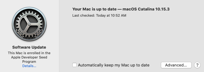

can someone just post a link to the .4 beta to google or mega please.
I am having a hell of a time getting the update to show up...
Reactions: Pinarek
I tried your installer, same issue...

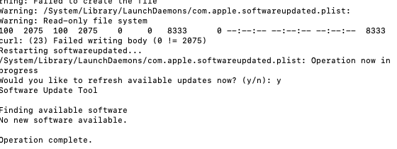

@Tim Thomason
I looked at your picture from an earlier post of yours again.
Do you also have write access to the partition where 10.15.3 is currently located?
In the picture there is an error with the write access.
On the 10.15.3 Catalina you have to do this:
sudo -s in terminal Pasword
mount -uw /
or this: File (see attachment) in Catalina Data Partition in Library/LaunchDaemon paste.
and you have ever write access.

that did the trick.. thank you

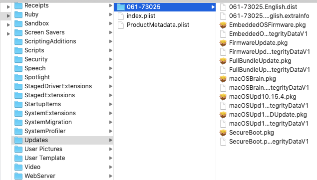

I have the .4 beta in the update prefs window, I clicked install. it went into the installer window w/ progress bar.
but it rebooted with 10.15.3 still on the hdd??
the installer is in then library/update folder( no wrapper) to use dosdude1 creator?

that's a big step forward, finally you could download the Upade now.
Now you have to adapt this .dist file ... please read here, in the thread above there is
exactly how you have to do it.

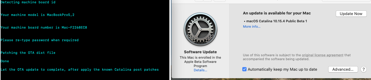

On MBP5,2 used the patch updater to reapply the night shift patch (version 3). After reboot the usual extra tab for night shift doesn't appear. Could be the issue you and Pinarek see, or the night shift patch. I'll try further when DP2 is there.
