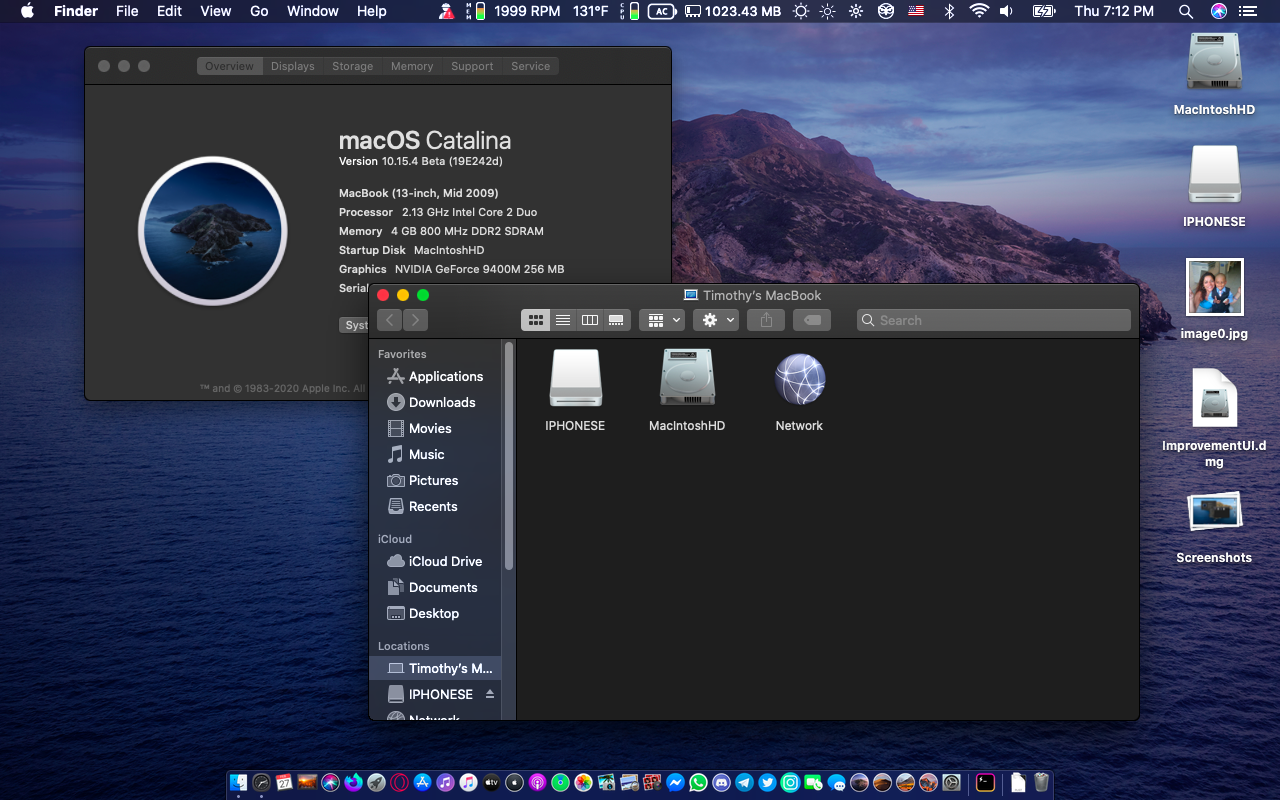

I don't care that some person doubts, I tell you Its 10.15.4 DP3 Build 19E242d
I have Install macOS with the Installer.app
EDIT ***** Show Picture

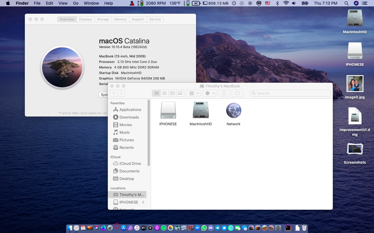

successfully installed 10.15.4 Dev Beta 3 on my mid 2009 MacBook 5,2 after doing a clean install of 10.15.3 I used the pinarek method swupatch after the update downloaded I used jackeluke's catalinaswuamfi fix patch4 once installed I did the post install patches except the platform compatibility patch once in my desktop I replaced the wrappers by Asentientbot rebooted then applied improvemetUI patch by fabioroberto all seem to work except the display preferences
I guess those who can't continue OTA update is only because are on non-apfs (apfs loader script) volumes.
I'm really curious about that, do you please upload the complete System Report on about this mac
thank you
View attachment 896505View attachment 896506
[automerge]1582861398[/automerge]
Well done, Display prefpane on unsupported mac seems to don't work more from 10.15.4 , if you need to change screen resolution you could use this app: https://apps.apple.com/us/app/easyres/id688211836?mt=12
I noticed your DDR2 SDRAM and NVidia gpu, so it's a non-apfs firmware machine, then to complete OTA I assume do you applied previously the APFS ROM patch ?

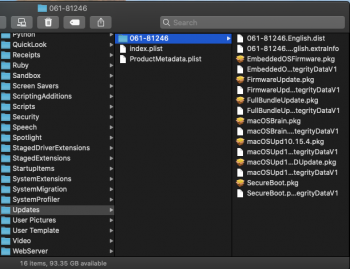

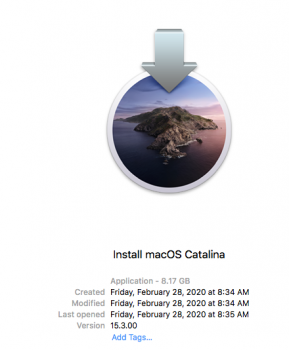

Question :
what makes dosdude1 installer download the installer. to the application folder and creates a installer usb for install from.
and the swupdate from apple puts the installer in the updates folder in the lib. folder ?

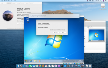

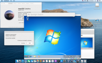

Hi, No problem here.

dosdude1 creates a installer
swupdate leaves the files unwrapped, so it cannot be used with disdude1 installer
Doddude's patcher only downloads the full installer which soon 10.15.4 final will be released which is about 8.7 GB where the swu patch only download the updates which about 2.96 GB

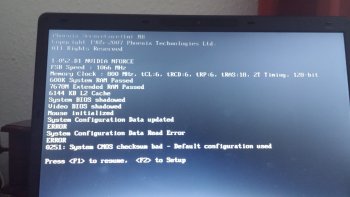

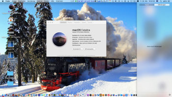

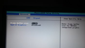

On my hackbook (Medion laptop built in 2009) aka MBP 5.2 also installed properly. Could only update from Catalina 10.15.3 Final to 10.15.4 DP3, everything else, from 10.15.4.DP2 and also from DP1 to DP3 failed because the option "Install from macOS xxx - Data" did not appear in the clover. Everything, except the setting in monitor, only "colors" appear, not the change of the screen resolution - but it is not so important, there are enough tools to change that.
Everything else ok, such as graphics acceleration and full transparency, WiFi etc. everything is fine.
Since the DP2 there has been a problem that the bios (Phoenix) always jumps back to standard (see screenshots). I need the options as seen in image2. Is not the same with Mojave 10.14.6 as in DP1. That left the BIOS settings as I saved it.
Thanks for replying and with the screenshots. I noticed you were on version 10.15.3 and I was on an older version so upgraded and tried again. Now working fine. When I ran CatalinaUI after enabling it and rebooting the application did not launch or launched and quit so I had to disable by using single user mode. After upgrading and running CatalinaUI it rebooted and the app started automatically showing an option to remove it. So something must have changed but not sure what. Anyway I'm very happy as Virtual Box is working fine now too. Thanks again.
