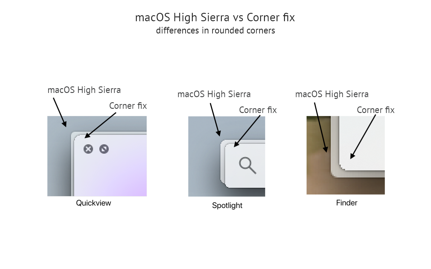

Hi everyone!
I release my cosmetic enhancement for the window (frame view) and popover corners that have been updated for the Metal.
The correction of the mask corners will not be perfectly rounded like the High Sierra. But, the windows and popovers will be shown correctly with the shadow. The visual experience will be much more pleasant.
(download link)
Details are described in the file Readme. (Here)
Below, a comparison between High Sierra, Catalina/Mojave (unsupported) and the fix.
I did my best. Apologize for not being better.
Hi everyone!
(download link)
This looks AMAZING and I can't wait to try it when I get home 😁
Fantastic work!

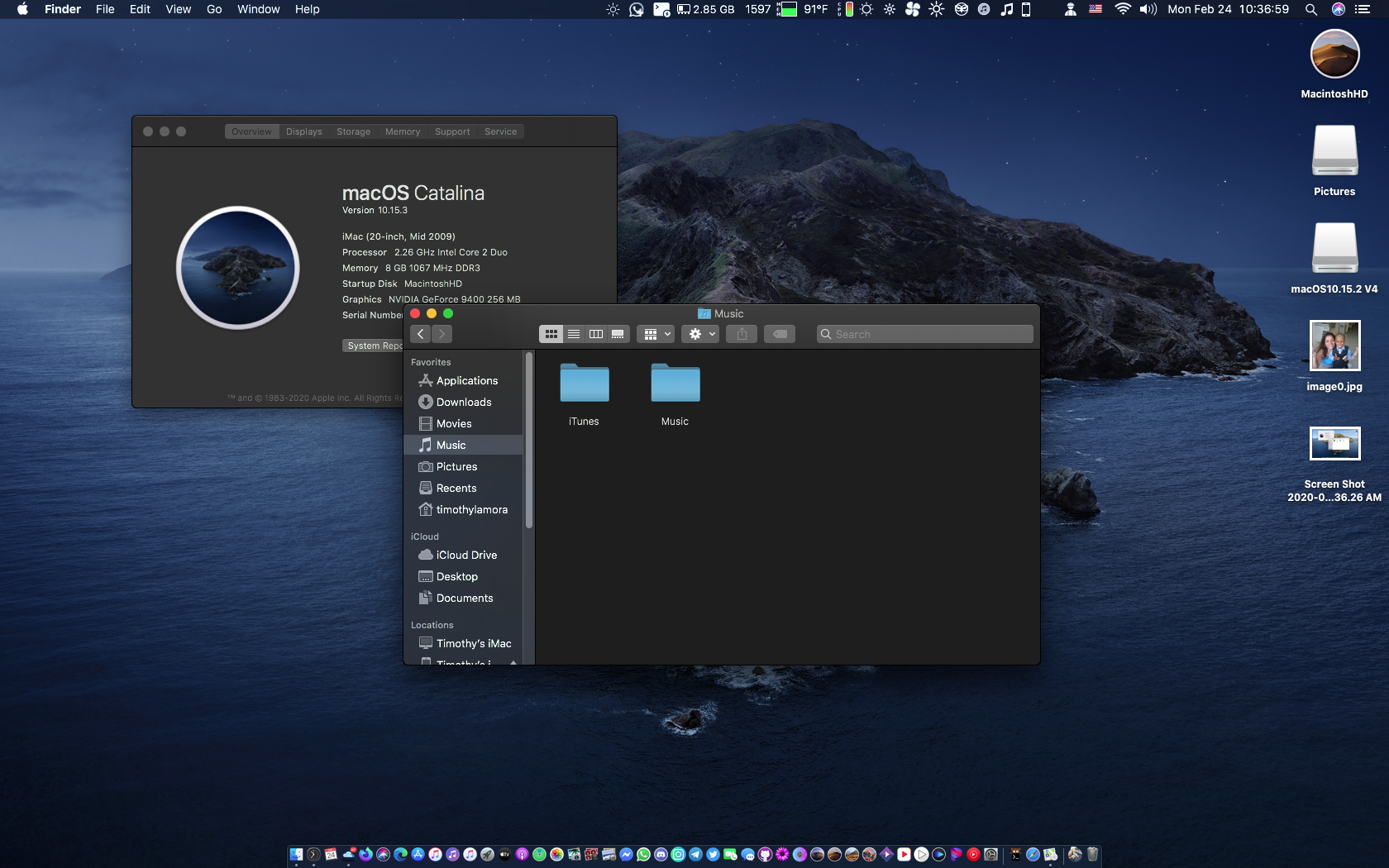

Hi everyone!
(download link)
looking awesome Thank you :)

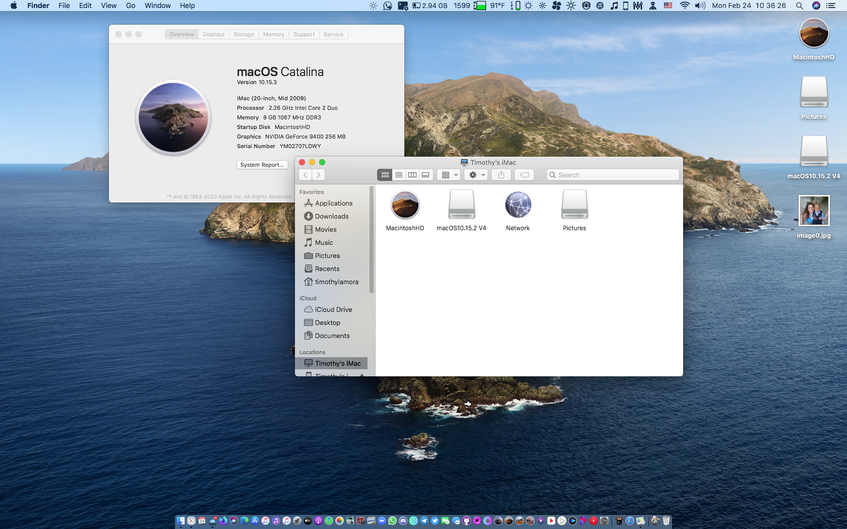

[automerge]1582569573[/automerge]

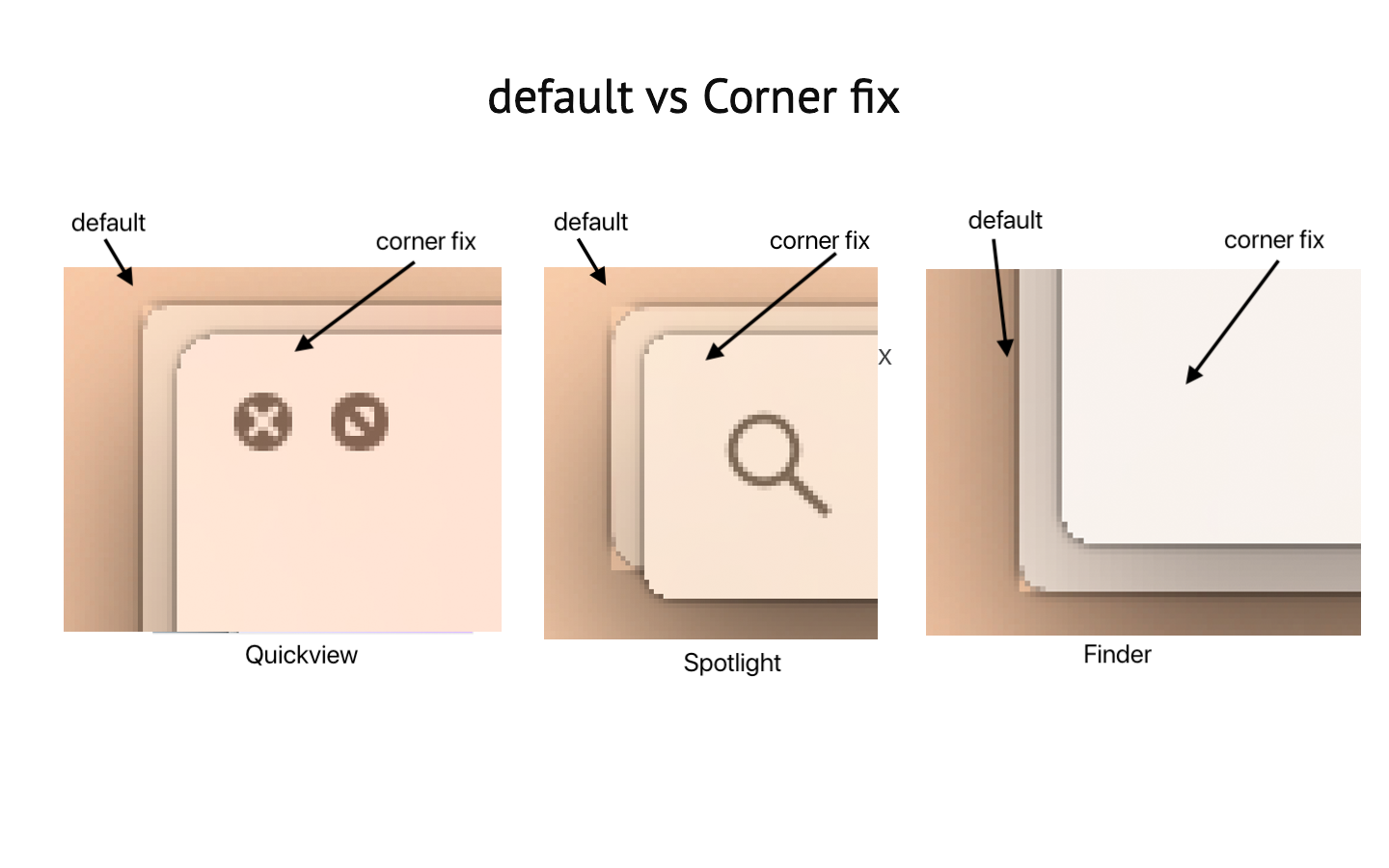

Hi everyone!
(download link)
You're a legend. I'm gonna try this right now.
UPD: Working flawlessly. Finally those annoying white corners in spotlight window are gone. Thank you.
