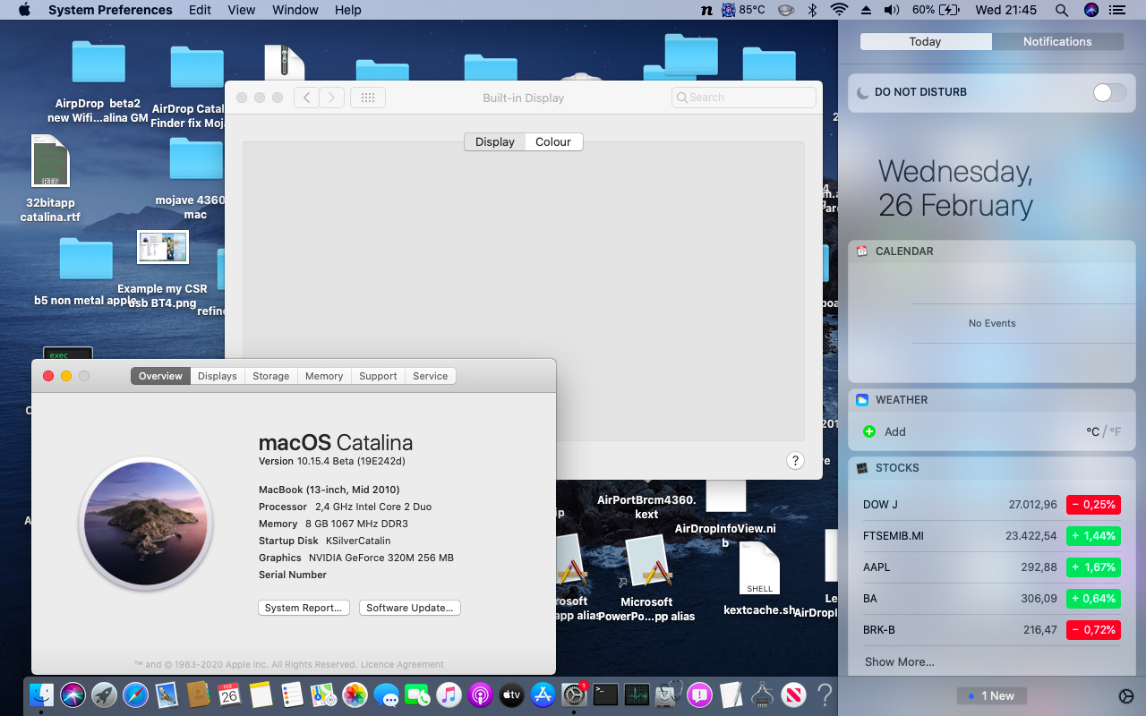

Just updated to 10.15.4 beta 3, using the Pinarek OTA dist method through my automated catalinaswufix4amfi script and the 4b1 ASentientBot wrappers (even if I guess also previous wrappers could work).
A tip, since my script sets the AMFI disabled either in nvram and preboot, if you do a PRAM reset, to keep the Preboot AMFI disabled you have to de-select from the Catalina post-install patches only this patch (it's the first in the patches list): Platform Check Patch
Because actually selecting that patch resets the com.apple.boot.plist "re-enabling" AMFI, that from 10.15.4 should be disabled to allow the new patched frameworks signatures.
Regardless of wrappers or Video Patch, applying the catalinaswufix4amfi, completing the OTA install, booting from usb post-patches only de-selecting that first patch in list (Platform Check Patch) everything else should work with no efforts.

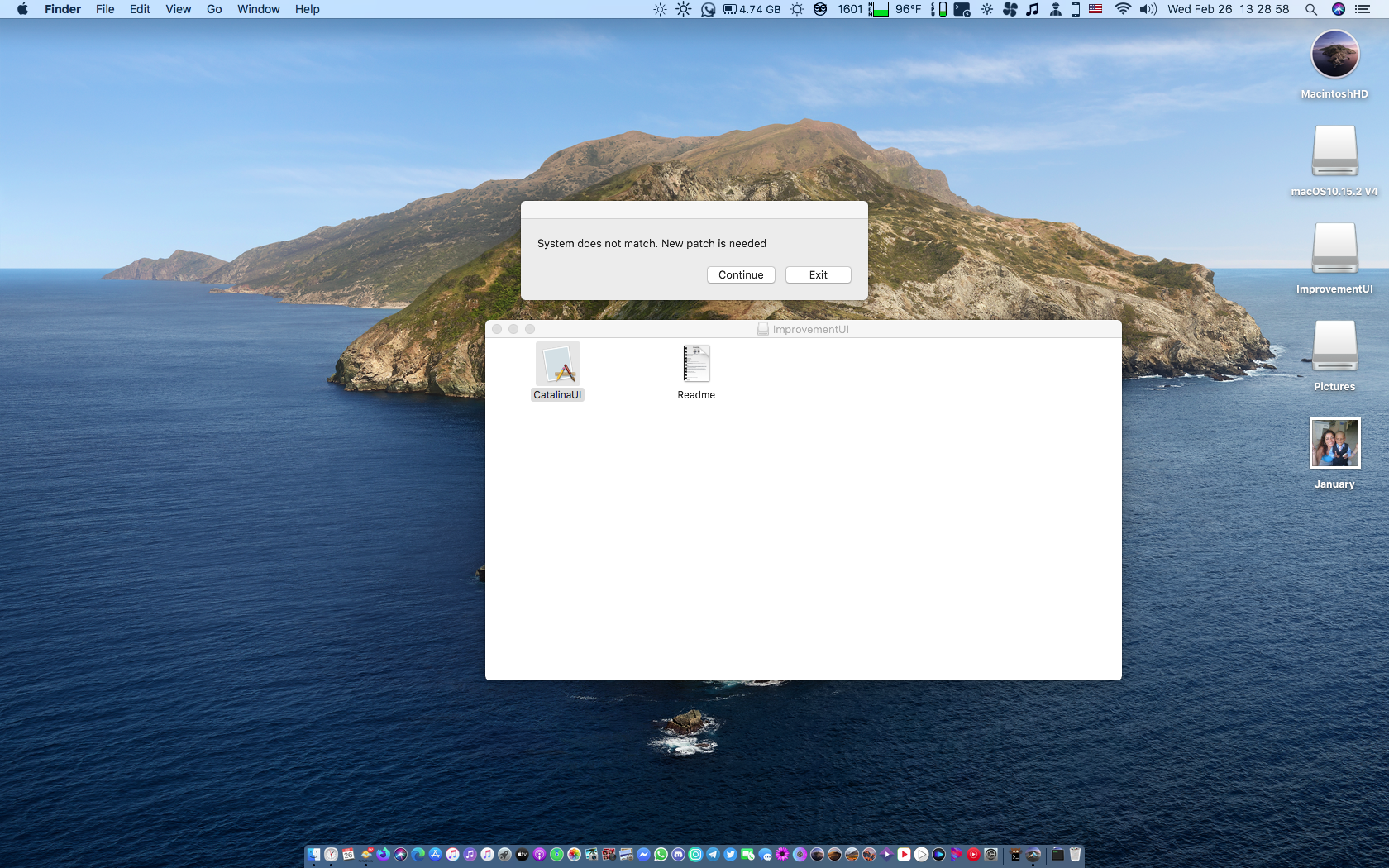

I had to reinstall macOS 10.15.3 but I accidentally deleted the improvementUI patch this is now what it says when you down load a new copy and if you click continue and select the transparent look then my progress bar gets stuck a quarter of the process so I had to reinstall 10.15.3 for second time today 3 time yesterday trying to get 10.15.4 Dev beta 2 to work uuuugggg I think this patch renable the AMFI as that why it says it doesn't match its the same app same macOS so I don't understand
[automerge]1582753001[/automerge]
So I might have to do a clean install to get the UI patch to work again and another 10-12 hours to download and reinstall my apps

I got it fixed this time when it said it didn't match and I picked continue installed a new patch this time it worked :)
I also used continue at that point.
I didn't see any interference between the catalina UI improvement and beta installation (still on PB1 which I repeated installing today), including with the new wrappers. All working fine.
Nice!
I think you installed 10.15.4 and used the patch, it generated the corresponding backup. When you reinstalled 10.15.3, it detected the backup of the other version. Just press Continue and the installation will run again.
I'm on a business trip. When I return, I will remove this warning to avoid confusion. I'm sorry for this.
If you want I send you the edited files to test one by one.

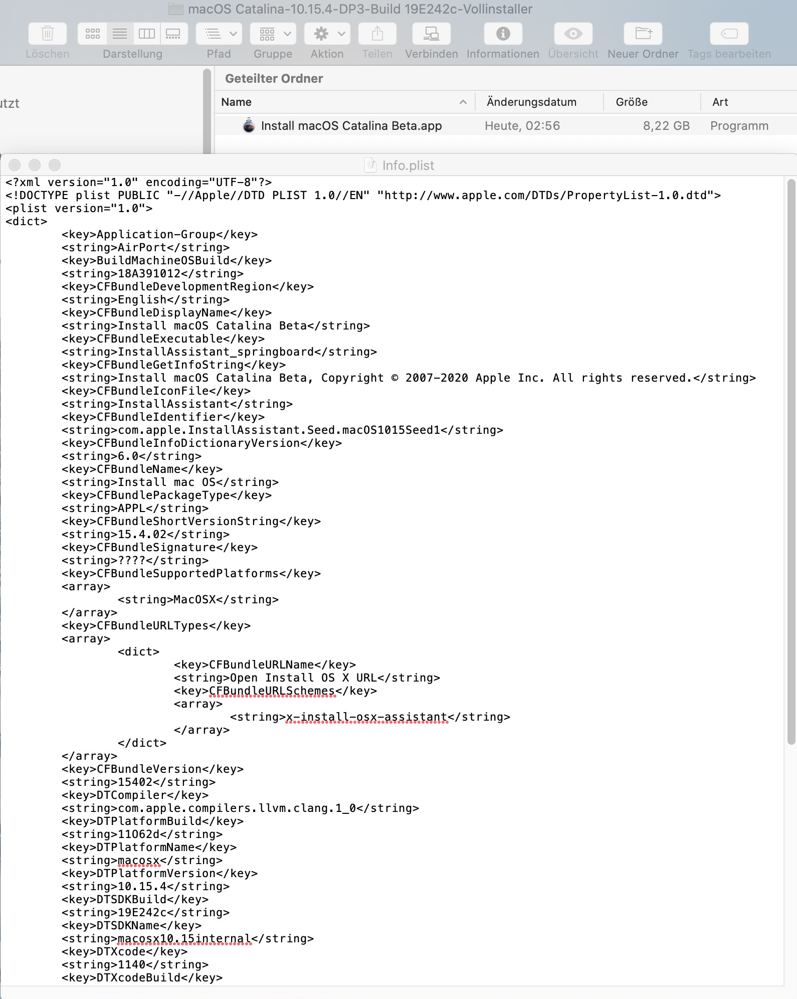

Although I didn't really want to write anything here about Hackintosh HERE,
but only a hint that may also interest the original Mac users.
If you download the offered update to Catalina with Mojave 10.14.6,
you get the 10.15.4 DP3 Build 19E242d as a full installer, see photos and info.plist !!

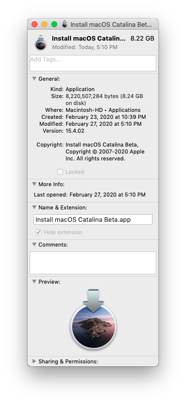

Thank you Pinarek - just loading it now to make a new bootable USB installer with patcher 1.3.0.
he @chris1111
you should not always look at this info, it is always the same inst. program ... important is the info.plist, how you can recognize the build version !!! but you should know that as the expert here. I know when others see this picture of you, they think it's the Final 10.15 Final or 10.15.2 Final for installation.
And therefore some people here doubt whether it really is the current Dev. Preview 10.15.4 DP3 Build 19E242c.
It is actually unusual for Apple to release a full installer, as is the case here now, in a fairly early beta, instead of just always having an update version with around 2.6 GB.
