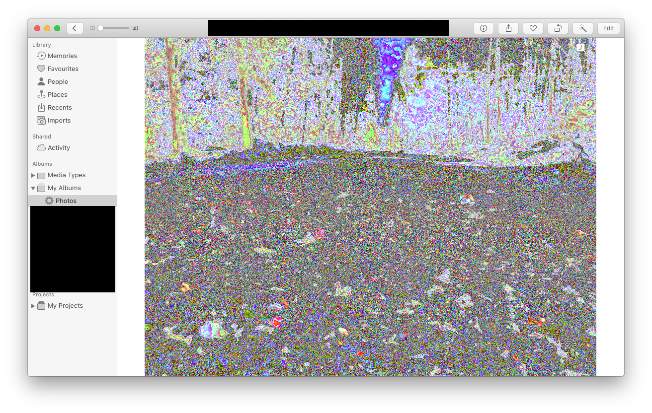

are you suffering photos doesn't show RAW files correctly. it is just like me, please if you found solution tell me,

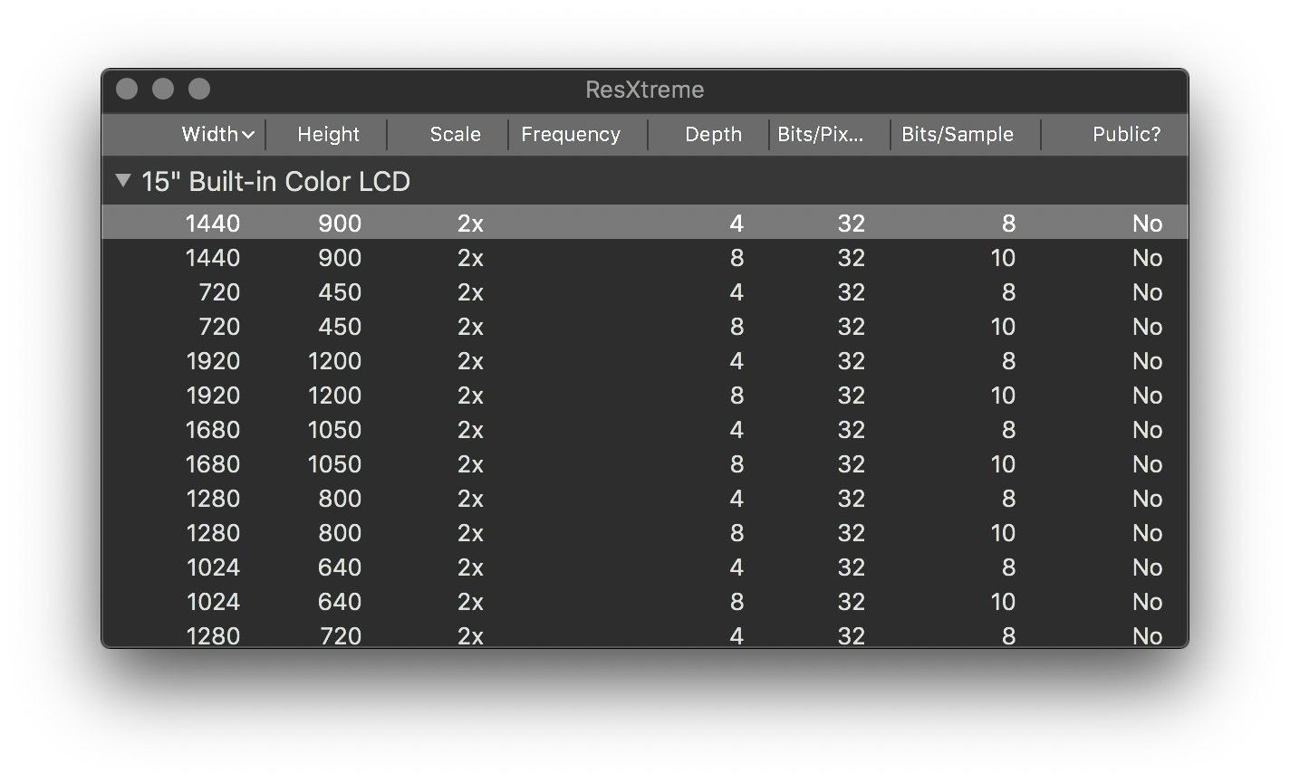

While I do not have any RAW files to test with I experienced those issues with jpg files. Following a tipp by @ASentientBot on reddit @Rastafabi led me to this tool, which I used to force the colordepth to be 8bit, rather than 10bit, which solved my issues.
Thanks for reminding us of this ResXtreme tool.
Also on MBP5,2 17", when purposely setting 10 bits/sample with ResXtreme, the display looked bad (wrong colours but still readable). Fine again after going back to the original 8 bits/sample.

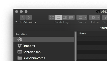

Good evening! I successfully brought my good old Mac Pro 3.1 to Catalina today. I cannot thank @dosdude1 often enough for this wonderful and very helpful option.
Unfortunately, one thing doesn't work: AirDrop! I'm using an installed Atheros card which previously worked regarding AirDrop in Mojave. I had seen in the thread that there is a fix for Broadcom cards. Does anyone know of a solution for Atheros cards? Thanks in advance for helpful tips ...

I have to add that there's just an AirDrop icon in the sidebar of a Finder window, without the word "AirDrop" next to it. What does/could it mean?
AirPort Extreme (0x168C, 0x8F)
Firmware-Version: Atheros 9280: 4.0.74.0-P2P

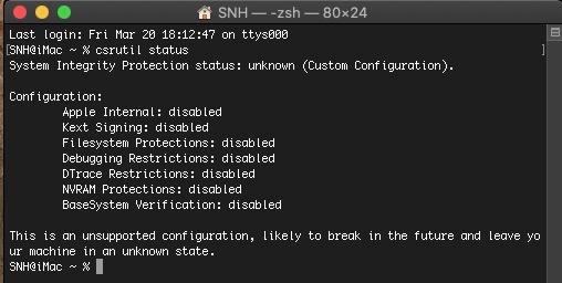

Hi everyone and again thanks for all you do here. I've usually had good luck with my 2009 early iMac. Lately, though I have had constant problems with apps freezing or not opening at all. Using 10.15.3. When they do work they are extremely slow. A couple days ago I started fresh with a new installation. Within hours, the same problems arose. I remembered in the past that the System Integrity Protection could be an issue. I checked and found the following messages in Terminal. I restarted from the USB drive, disabled SIP and restarted. I continued to get the same 2 messages. Thanks in advance for any advice. And BTW, is there a recovery disk in Catalina?
That is normal in the first screenshot that means SIP is disabled. How much memory is installed in your Mac you need at least 4GB to run Catalina decently
I have 8 GB. The confusing part is I have never had these type of issues before. Just popped up recently. Apps confirm no virus or malware issues.
[automerge]1584816636[/automerge]
Till Mojave apple allowed some kind of "AirDrop legacy" that worked also on Atheros wifi cards, from Catalina they merged all the continuity features with a kind of AirDrop enhanced, and only certain recent Broadcom Wifi cards patching the AirPort Brcm4360 Wifi driver can work.
