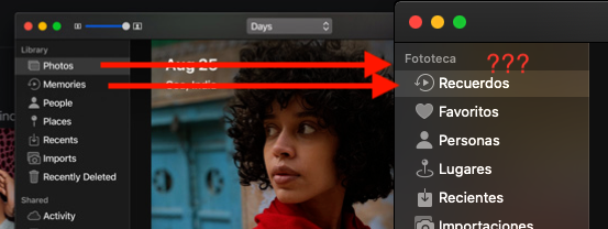

I create the USB with 1.3.5 and iMac Late 2009 27" work faster that before , in preference now can see display options (but not Night Swift, only in Notification Center ) but in Photos apps continue without can see "Photos inside Library" and 16:9 photos in full screen crash

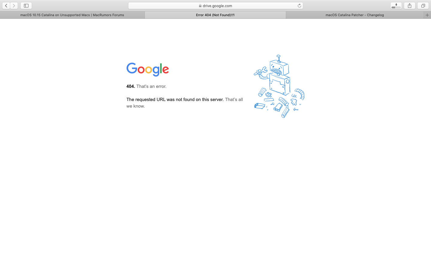

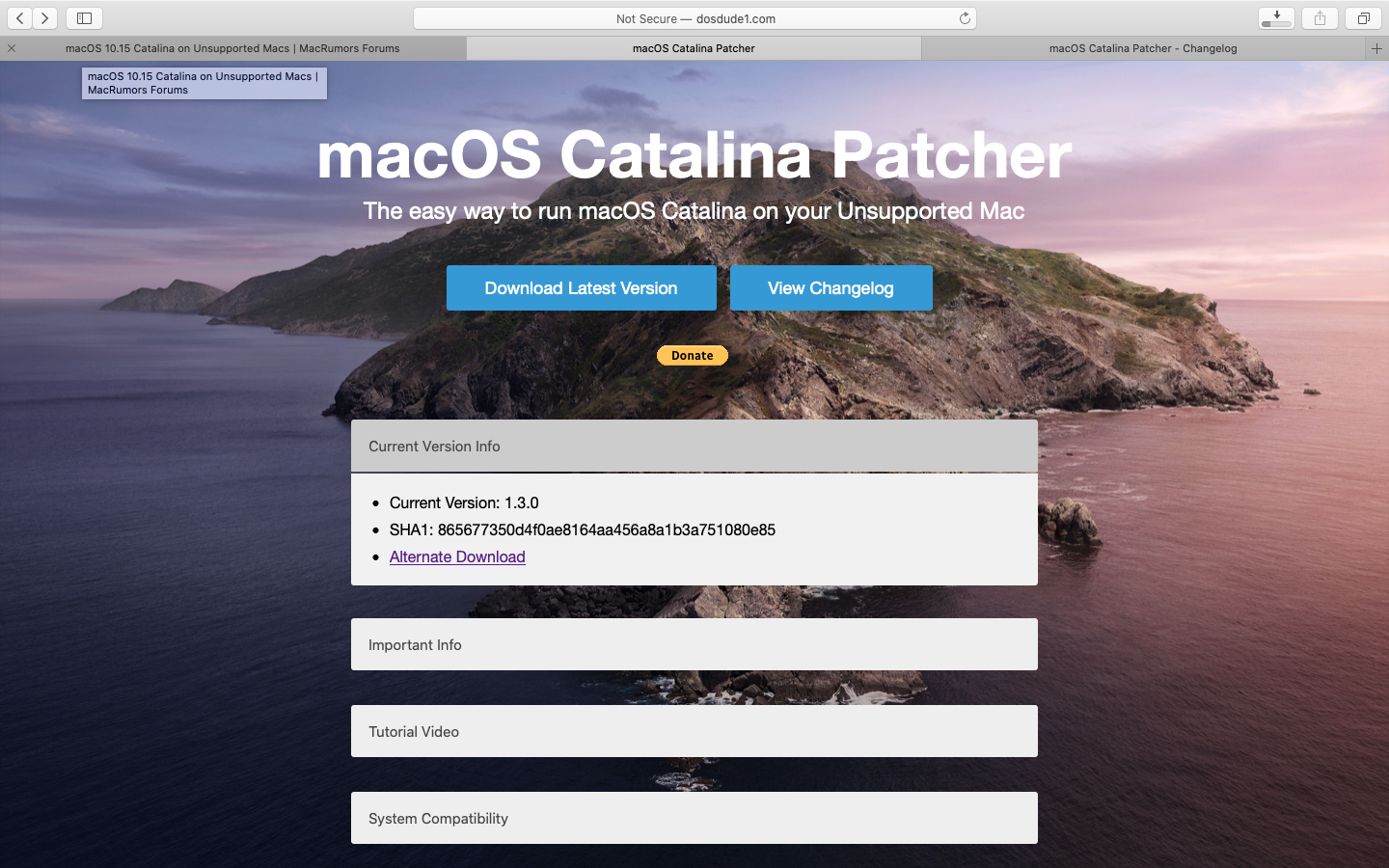

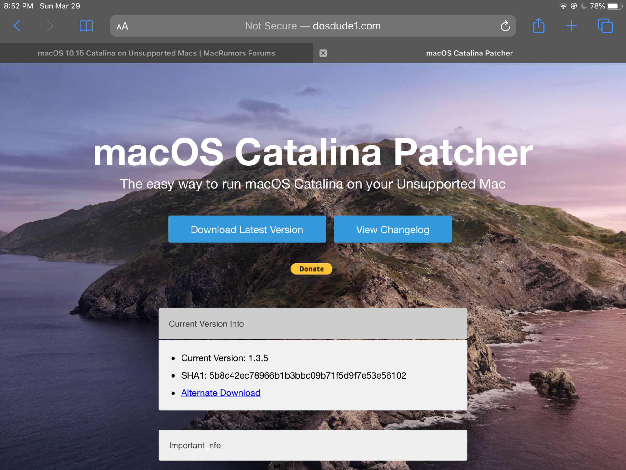

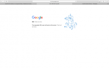

So are you saying that if you click the “Download Latest Version“ button, you can’t get v1.3.5 ?
Hi read this after my recent post regarding the hanging of install of 10.15.4 (on MBP 8,2 -15" 2011) with dosdude patcher downloading "latest version" that was done yesterday. In fact went to launch patcher that was downloaded and in effect the About indicated 1.30 instead of 1.35. Strange also went to "alternative download and got "404 error". I am redownloading "latest version" patcher to see if... will let you know.
UPDATE: Dosdude Patcher: Just downloaded "latest version" and again get ver. 1.30 and not 1.35. Any suggestions? thanks
