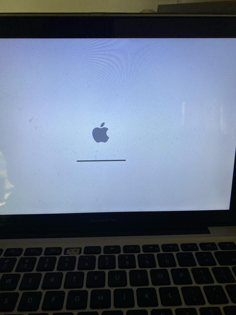

Tried updating to 15.4 but now my screen stuck on the apple screen for the last 3 hours 2010 MacBook Pro 13 inch
Any other way to get past this
Boot holding CMD+V in verbose mode, if you notice many AMFI strings, means that you need to disable SIP from a recovery environment, if your CMD+R doesn't work, then you should make from another mac an external USB Recovery using for example this tool: https://github.com/chris1111/Catalina-Recovery-HD-Partition
Once you boot from a recovery environment, open terminal type: csrutil disable ; reboot

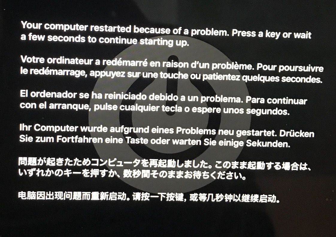

Bonsoir,
I have a problem !
I made a very clean install of 10.15.4 with @dosdude1 patcher (1.3.5.) on a freshly "nuked" and repartitioned SSD (MP 3,1 with a GTX 680 2Go full metal compatible).
Everything OK but after each standby, I have this screen :
In my csrutil status :
Configuration:
Apple Internal: enabled
Kext Signing: disabled
Filesystem Protections: disabled
Debugging Restrictions: disabled
DTrace Restrictions: disabled
NVRAM Protections: disabled
BaseSystem Verification: disabled
Any idea ?
Many thanks in advance,

sleep is broken in Catalina. Look here: https://forums.macrumors.com/threads/2011-imac-graphics-card-upgrade.1596614/
