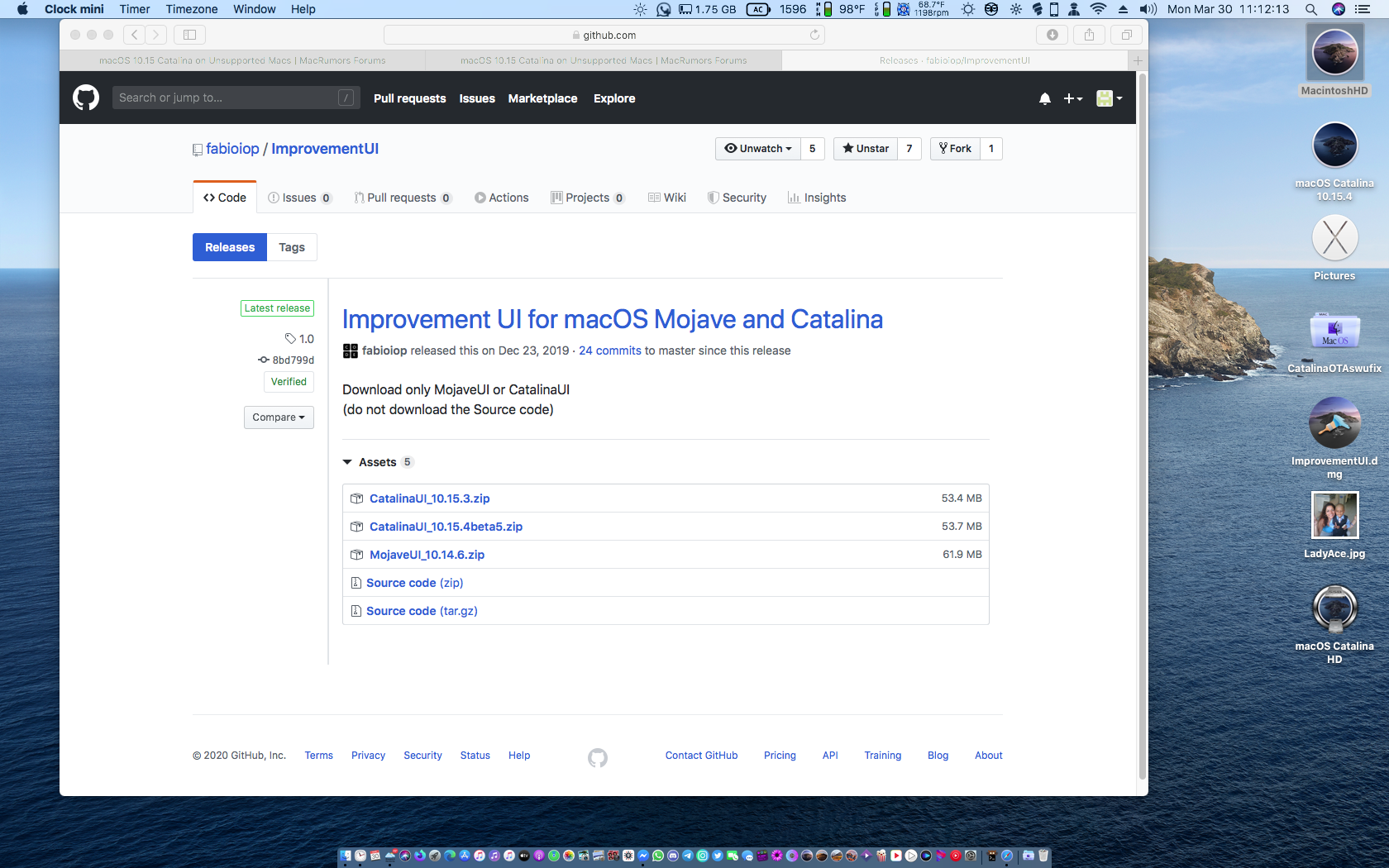

Unless this could be causing it I had to reinstall 10.15.4 beta5 of the UIimprovementView attachment 902367
Hi, TimothyR734, normal here. I'll update the fix to 10.15.4 in the next few days. ;)

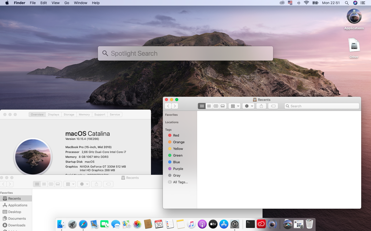

I have a problem on my Macbook White 2010. With Mojave there where no problems in the Photos App. But now in Catalina, der is noch Photos Button. Only Memories and the others.
How can i get back the Photos button?
In the screenshot you can see Photos is missing.
Rückblicke=memories

The Photos button is missing in Catalina on unsupported Macs. A search for "all photos" in this forum reveals a couple of workarounds. e.g. post #6,871.
