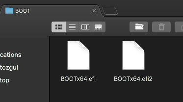

@jackluke I forgot to ask you this; why there is two BootX64.efi? am I need both of them?
You can remove the .efi2 , if you use any of my USBOpenCore setup I advise to use only my config.plist, I don't added Lilu kext or Broadcom Wifi patches because on some non-APFS firmware machines it might cause kernel panic, I'd add an Audio patch (also for macOS Recovery CMD+F5) but currently cannot get it working, my challenge is to keep stock all the Catalina (and Mojave) SLE kext.

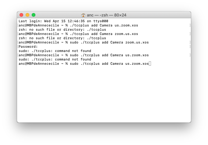

Thank you but the problem is still the same
Then you should try this manual method: https://github.com/jslegendre/tccplus/blob/master/README.md
In particular copy or install zoom.us.app in the Applications folder, then copy tccplus exec (tccplus.zip) in the Downloads folder, and open Catalina Terminal to add manually the Camera and Microphone permissions (copy/paste):
Code:
cd ~/Downloads/
./tccplus add Camera us.zoom.xos
./tccplus add Microphone us.zoom.xos
If this don't worked, then you are not using an administrator account.
Code:
cd ~/Downloads/
and if I use "sudo"?

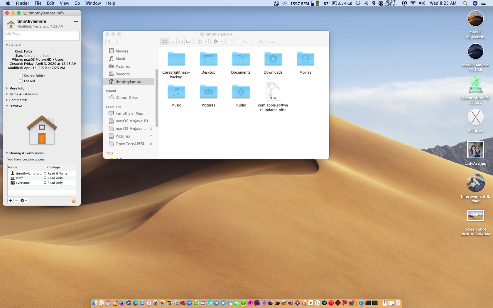

thank you sincerely for all your help but maybe I should format everything and reinstall Catalina.

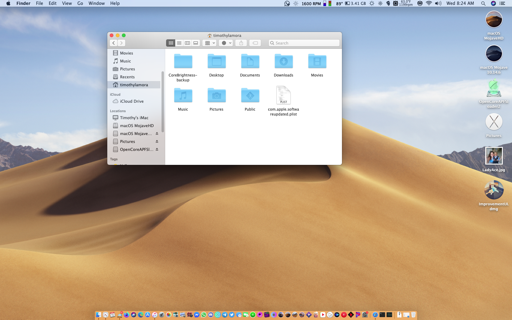

You could try this-open Finder-right click on your Home folder (highlighted in the bottom)picture-click get info -then unlock it-enter your password-then click on the clog wheel (action) then apply to all enclosed items. Also you can unzip the CatalinaAutomountWritiable and place it in /Library/LaunchDaemons folder -reboot

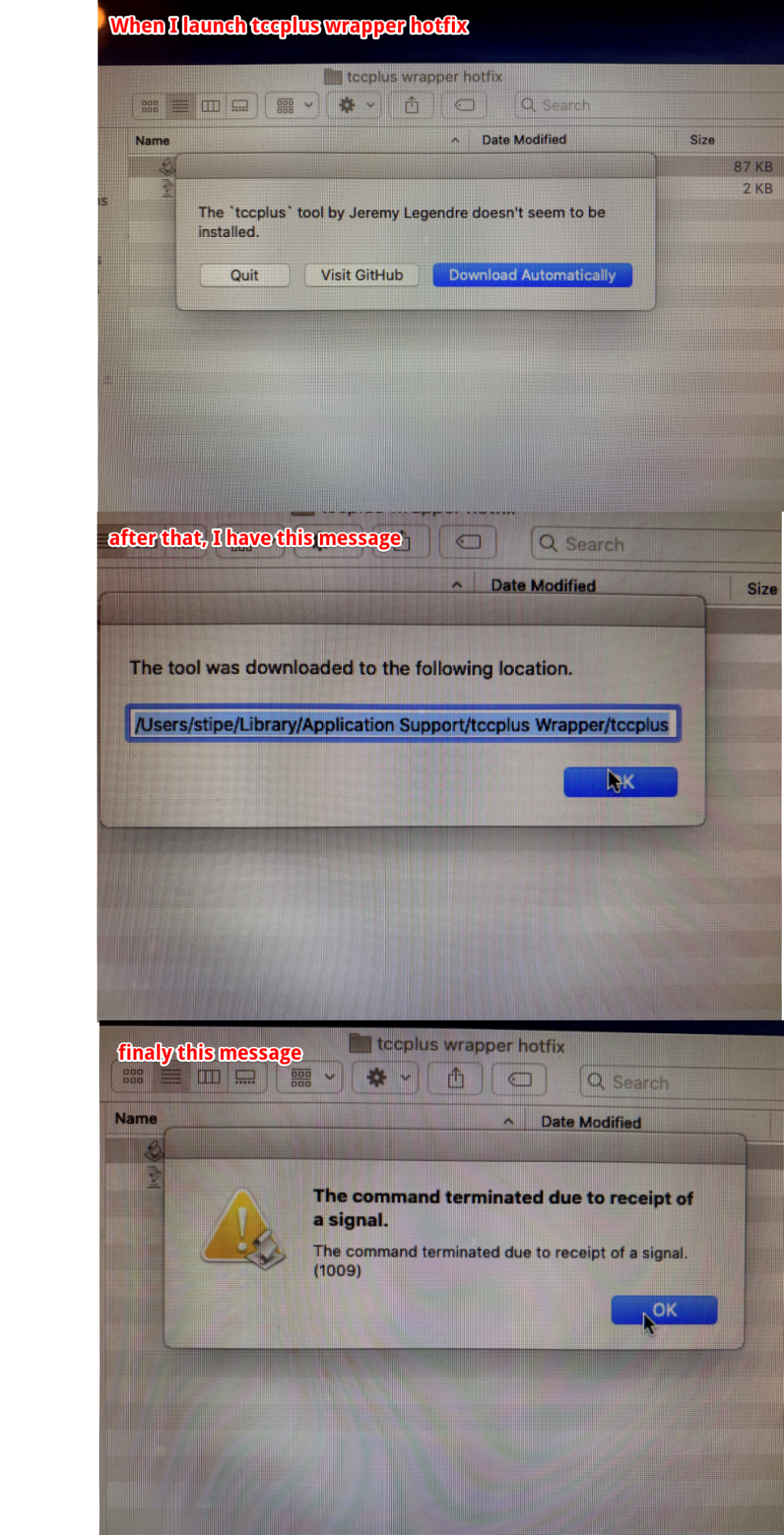

Hi ASentientBot, I just format my MacBook Pro several times and I still get an error message as I have reported on my previous posts. However, when I run your script for the first time I get the error below:
do you have any idea?

Did you try running sudo killall taskgated in the terminal it worked from me it wouldnt open on the first try but when the error report came up I tried opening the app again then closed the error report and the app opened
[automerge]1586964834[/automerge]
