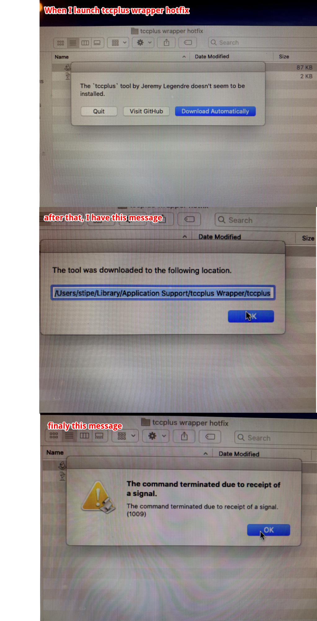

Hi ASentientBot, I just format my MacBook Pro several times and I still get an error message as I have reported on my previous posts. However, when I run your script for the first time I get the error below:
do you have any idea?
In my experience tccplus only crashes when you have AMFI enabled -- in which case, you you don't need it anyways.

Let me ask you this which version of Zoom do you have install I have 4.5.9 I know the latest version requires metal which our unsupported mac's lack
Imagine that I have not installed any Zoom verison, I only tested the opening of tccplus.
Thanks! :) How can I disabled AMFI?
Reactions: TimothyR734
Sorry, I was unclear. If you have AMFI enabled, you don't need tccplus since there should be no issues with giving permission to apps. In fact, tccplus seems to crash whenever AMFI is on (not sure why; I didn't write the tool, just the GUI wrapper). It sounds like this is the case with your machine -- leave it how it is. There should be no need to disable AMFI. Even if you're using a theming/injection platform like MacForge, you can disable Library Validation but leave AMFI on.
It's when AMFI is disabled, breaking the camera/microphone permissions preference, that tccplus is needed in the first place.
I hope that clears some things up. What are you trying to accomplish anyways?

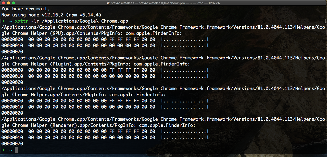

My Chrome Browser started to crash again today.
Maybe it was because of an update.
These are the results of the xattr -lr command before doing the clearing of the attributes.
After doing the clearing and the codesign everything works fine again.
For more information on this method search my previous posts!

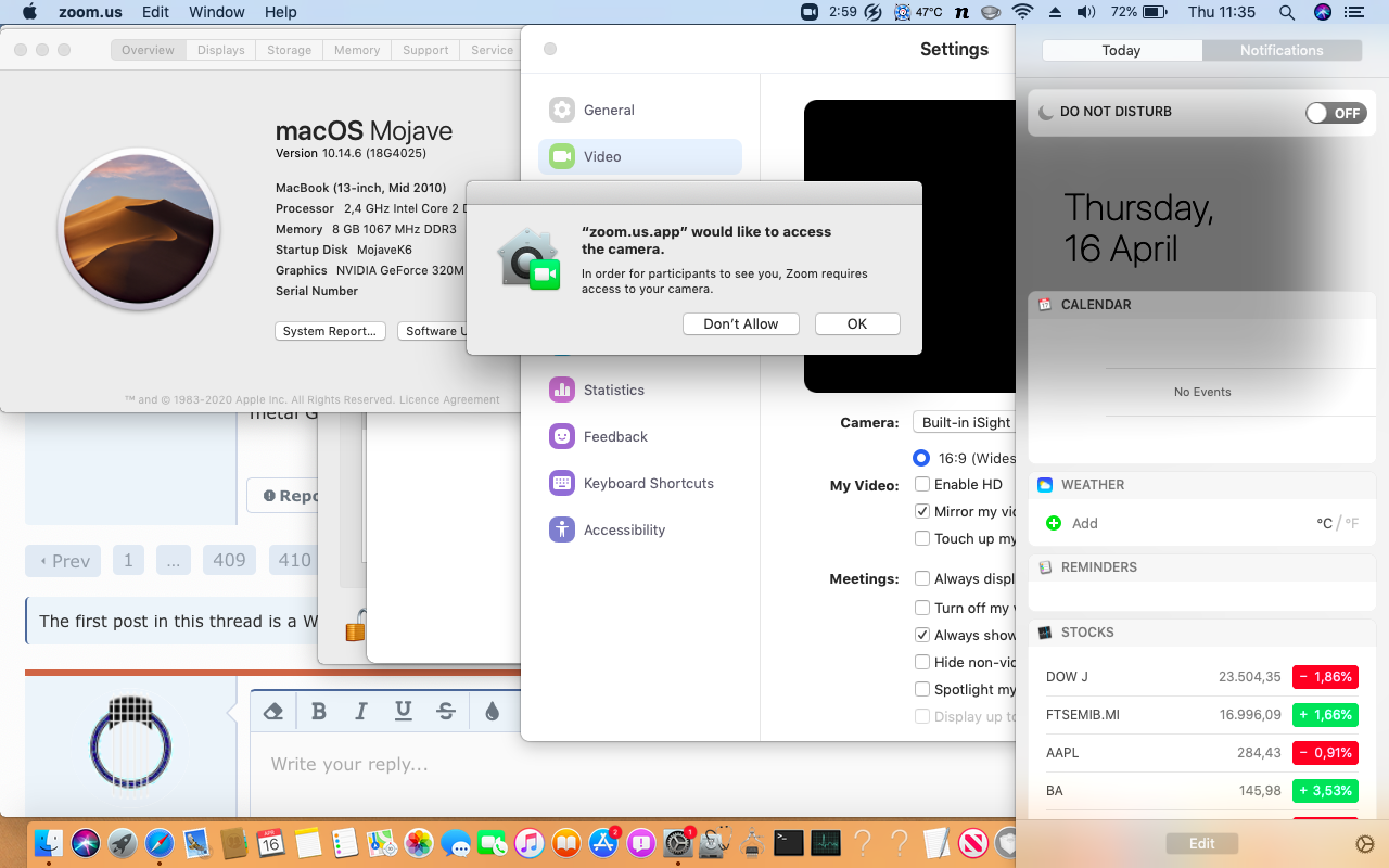

Okay! Indeed everything is clearer. However I still have a problem with the cam: macOS asks me to activate the cam and the microphone for Zoom client but when I start a meeting on Zoom I do not see any image, neither mine nor those of others. However others can see me and hear me and I hear them. The problem is only with the cam. If I start a recording during the meeting I can see myself on the video ... weird
ps: I have 10.15.4

A guy some pages before, posted a pkg that works.
I am talking about v4.5.9 (5757.1110)

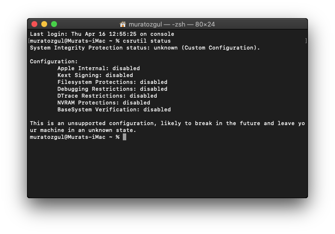

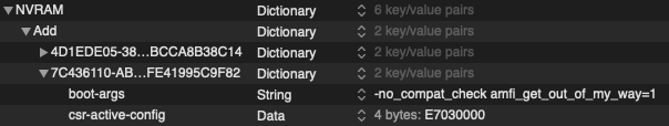

But my csr fully disabled with this;
am I need any of these?

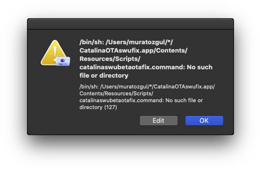

@jackluke I am getting this;
If you remove opencore you should apply those patches, about OTA swu fix, I haven't used relative paths, so you should run the app from Downloads folder or from Desktop, without any subfolder (and without renaming the app).

For SIP fully disabled from opencore if you use an xcode plist editor you should set this value for csr active config: 4 bytes: 77000000
as you written E70300000 I guess is wrong.
But SIP fully disabled method from opencore is more effective if you remove the SIPManager.kext from /Library/Extensions/ and use a stock Catalina Preboot boot.efi .
This is the output when SIP is fully correctly disabled:
Code:
csrutil status
System Integrity Protection status: disabled.
But also as unknown status, it should work anyway.

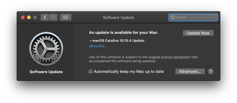

is this just for beta update? If I disabled beta enroll will it find the regular update?
is this just for beta update? If I disabled beta enroll it will find the regular update?
Exactly, just Restore defaults from Catalina Software Update prefpane (wait a couple of minutes to let update to show), but when you start downloading the OTA update, apply the OTA update fix.
On non-APFS firmware machine when the OTA is downloaded after restart you should use opencore to select the "macOS Installer" to continue the OTA installer (Catalina circle logo).
APFS firmware machine instead can continue OTA update also without opencore.

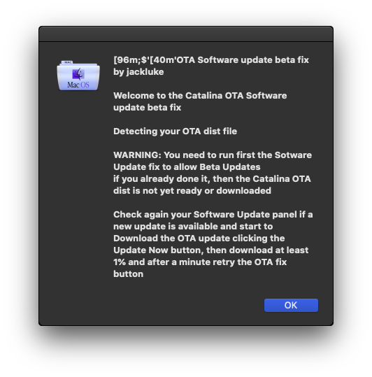

I disabled enroll. Then search a new update and find 10.15.4 start it. Open your app again and click to OTA fix; But download continue btw...

Close the app, and retry OTA update fix when OTA downloading is at 10% , example if your download package is 3 GB, download at least 300 MB before reapplying the fix.
Ok. BTW I am on the OC. (Just like you said I set timeout 20sec etc. Here is the weird thing. Its already finished the download. I click to Update Now but I cant see the MacOS installer on the bootpicker! Every restart it shows the update but never install it.

Edit: I think I handle it. Ok. Sure its work now. 👍
The OTA update fix (based on Pinarek .dist editing method) is required on unsupported Catalina mac, otherwise the OTA installer will refuse to install the update, and the only way to re-patch the OTA packages is to remove the downloaded folders from Catalina /Library/Updates/ (and probably delete also the "macOS Install Data" folder on the Catalina Data Volume) , so re-downloading again the OTA update and patch the .dist when downloading is at 3% or before restart or Update Now button.
