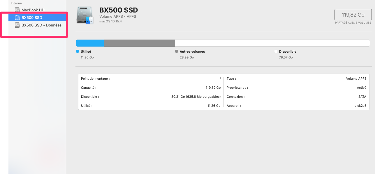

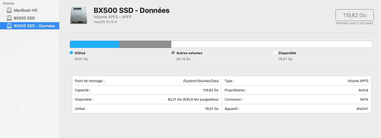

Et merci du conseil, je pense que j'ai bien formaté le disque, par contre saurais tu pourquoi j'ai désormais deux volumes ?

Depuis Catalina 10.15, Apple :apple: a mis le système d'exploitation sur un volume en lecture seule, tout en conservant vos données sur un volume séparé – cela a fait patcher le système plus difficile.

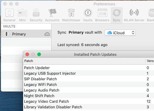

I think the validation patch also breaks some apps such as 1Password. Cause 1Password iCloud Sync doesn't work anymore. I am not sure is this a Legacy iMac issue or for everyone?

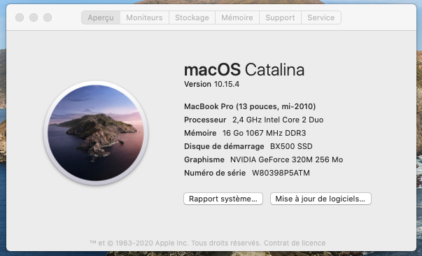

Hi everyone, first i’d like to thanks @dosdude1 @ASentientBot @jackluke @parrotgeek1 @Rastafabi @oliveira131and every person who contributed to this amazing work !!!
I’ve done the Catalina update (the latest) on my MacBook Pro 7,1 mid-2010 and upgrade it with 2x 8Go RAM and a new BX500 Crucial SSD (in France, it cost me about 130 euros) and… IT WORKS LIKE A CHARM. I’ve the feeling that I’ve got a brand new computer for a small amount of money.
However, I still got a minor issue : Siri doesn’t work. It won’t open at all, from the taskbar or from the dock app.

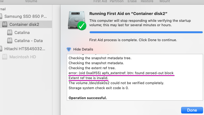

I installed Catalina two weeks ago with dosdude. Today I check my disk with 'disk Utility.app' and get this.
What does it mean?
I sync through 1password.com so my vault is available on any OS/Platforms. I don't see the benefit of using iCloud Sync.
