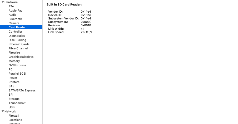

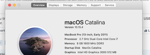

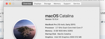

Hey Guys. On my early 2011 Macbook running the patched Catalina, my SD Card reader does not seem to be reading anymore, used to work on High Sierra but not anymore, also although Airdrop shows on my side bar in Finder, it does not work. I have a late 2012 running Catalina as well and it does not detect each other, both machines are set to discoverable for everyone.

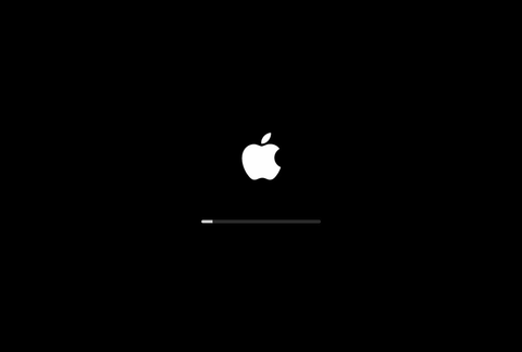

After you apply the OTA update fix, these are the four apple Catalina OTA update automatic phases:
1) apple logo short loading bar followed by auto reboot OTA packages preparing the "APFS macOS Installer" temporary volume (it may take up to 10 minutes, but on average about 5 minutes)
2) apple logo long loading bar followed by Catalina logo installing (OTA pre-scripts verifying on your APFS volume) (it may take up to 15 minutes, but on average about 10 minutes)
3) Catalina circle logo with installing progress bar (OTA stage2 installation on your APFS volume) (it may take up to 60 minutes, but on average about 45 minutes)
4) apple logo full loading bar OTA post-scripts followed by direct boot to Catalina or a bootloop (because post-install patches are required) (it may take up to 15 minutes, but on average about 10 minutes)

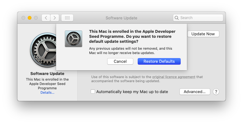

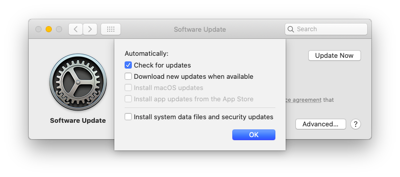

To receive only non-beta updates after the "Software Update fix", simply from Software Update prefpane click "Details" and "Restore Defaults" (OTA update fix will still continue work correctly):
Moreover I'd advise to set the "Advanced" menu this way, in order to have more control on how updates are downloaded and installed (to give extended time to make a backup or to build a new USB Catalina Patcher for example):
Example downloading a non-beta update (from a beta updated machine):
