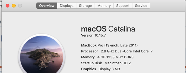

After Installed Catalina i have a trouble
1. Wifi Can't turn on
2. Sound
3. Graphic in about just display 3mb not intel as usual
3. Office 2011 not support
anyone can help me?
2. Sound
anyone can help me?
Given where you posted, I am going to assume that you have a USB with DosDude's MAGIC! ALCHEMY! Look under applications and folder within a folder... look for the post install utility. With a little bit of luck the utility will run, reboot, and all your troubles will go away. From my point of view, stoping the auto switch to low performance video card helped. Good Luck!

fauzan
macrumors newbie
Oct 13, 2020
2
3
thanks you, its work all . but stil i didnt have office

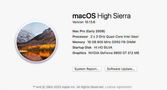

I've been trying to get my 3,1 to Catalina using the dosdude patcher. According to his website, I should be able to do it and yet I can't seem to get a stable install. I've only gotten one install through 100% (through setup all the way to a desktop screen) but it crashes extremely frequently. I have one ssd mounted on a PCIe and another installed in a regular HD slot. For the other 49 failed installs of catalina, they fail either during the install process or install almost completely ("about a minute left") and then crash. However, the volumes are recognized as startup disks with 10.15. If I choose it as a startup disk or run the post-installs and do the same, I'll see the APFS fix and then the computer crashes and turns off. Any idea what could be the reason why? Or did you do anything differently to get yours to work? Really appreciate any help you can give.
Same experience here and at point of selling MP3,1 as a result.
Are you installing Cat to SSD in regular HDD slot or to PCIe card?
Have you tried flashing 3,1 bootrom to support both native APFS annd NVMe (assuming SSD on PCIe is NVMe)?
Also, what RAM configuration gives 18 GB?
Gave my 3,1 with a HighPoint 7100 PCIe card with NVMe Samsung SSD a last chance and it did install OK.
Did NOT use APFS booter patch because this 3,1 has APFS and NVMe bootrom modifications and also set Autopatching to off when creating the USB installer with the 1.4.4 Patcher.
After the install and reboot, used the Option key to get to the patch options and manually patched with the video legacy patch and AMD SSL patches off. Also set the WiFi Broadcom patches to both off because have Wifi/BT 4.0 LE card installed. Rebooted with cache rebuild option checked.
So it is possible.
