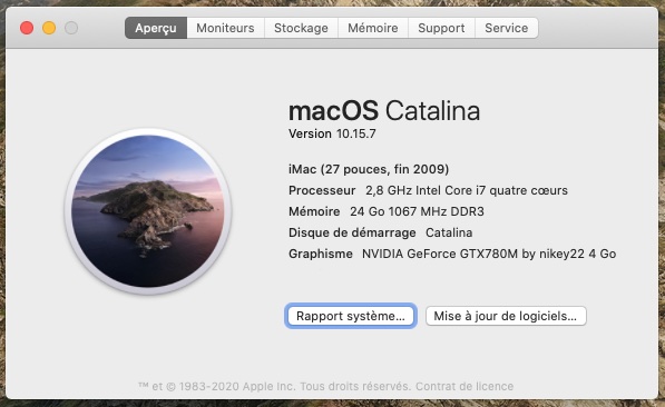

Hello,
My iMac late 2009 (GPU : Nvidia GTX780M (@Nick22 flashed) METAL Support) works well under Mojave.
I want to switch to Catalina, and i do not find how to do not install "Legacy video card patch" dosdude1's patcher Catalina.
I tried several things:
1 - Uncheck "Legacy video card patch" in the post install tool at the end of Catalina installation (by holding down the option key ).
2 - I used @Ausdauersportler 's method modifying the "macmodels.plist" file of the Patcher Catalina.
With these 2 methods "Legacy video card patch" is always installed.
What i'm doing wrong?

Hello,
Reactions: TimothyR734
Thank you very much for your help @Ausdauersportler and @nekton1.
Catalina works
great now on my iMac.

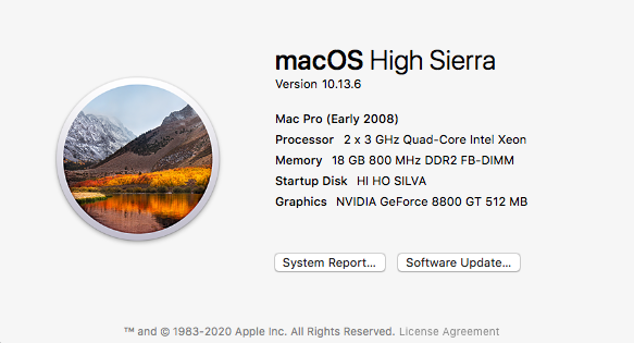

So I have a 2008 Mac Pro 4.1 500gb ssd , running high Sierra , I tried the Catalina update a while back but ran into an audio problem, I want to update so I can update logic x to the latest version, I use a focus rite Safire pro 24 FireWire audio unit, everything is good apart from the audio through the Safire which is glitchy really glitchy, built in audio is fine, I’m just wondering if anyone else has had the problem? I’ve done a clean install on both Mojave and Catalina and it’s the same. I’ve tried loads of different patch options but still get the same result
any help appreciated
Rob
