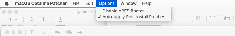

- Boot pressing alt --> ok i see my efi boot from my USB key created by Dosdude1
- Check the "Disable APFS booter" when making the USB --> this, i am not understand ? where ? when at the creation of bootable key ?
last question : what is exactly the process of "APFS Rom Patcher". May i see a progression bar or something elses ? because me only what i explain in message up #12,621

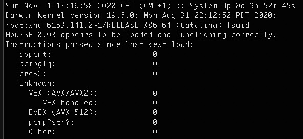

MouSSE comes with an auxiliary command-line program called moussestats. Depending on how MouSSE was installed, it might already be in your path, or you might need to find it on the installation media you used. In any case, please run moussestats from a shell prompt (does not need to be sudo), and post the results. Output will look something like this:
Code:
Sun Nov  1 10:54:32 2020 EST (GMT-5) :: System Up 16d 7h 21m 05s
Darwin Kernel Version 19.6.0: Mon Aug 31 22:12:52 PDT 2020;
root:xnu-6153.141.2~1/RELEASE_X86_64 (Catalina) !suid
MouSSE 0.95 appears to be loaded and functioning correctly.
Instructions parsed since last kext load:
   popcnt:                   6987
   pcmpgtq:                   423
   crc32:                      15
   Unknown:
     VEX (AVX/AVX2):          871
     EVEX (AVX-512):            0
     pcmp?str?:                 3
     Other:                   192
Also, as @joevt correctly points out, MouSSE does not "advertise" SSE4.2, meaning it does not hook the CPUID instruction or alter the MacOS flags indicating SSE4.2 support. Programs are expected to check for SSE4.2 support before using SSE4.2 instructions, but a surprising number (including the MacOS AMD driver) do not - they simply use the instructions and cause a fault or panic when there's a problem. If your Adobe software is testing for SSE4.2 as it should, MouSSE won't help you. However, if they are instead trapping faulty instructions and letting you know there's a failure, there's at least a chance MouSSE will be of some use.
Please post the moussestats output so we can catch a glimpse of what's going on "under the hood."

I just run moussestats in Terminal and that's the result :

That output suggests that the Adobe software is checking for the existence of SSE4.2 before trying to execute any instructions, which is the correct thing to do. Unfortunately, the current version of MouSSE won't help you here. A future version will likely "advertise" SSE4.2 support, but that version won't be available for some time (weeks/months/maybe never).
It sucks that our old machines are slowly becoming obsolete, but at least it's for a valid technical reason, and not Apple blacklisting old computers just to encourage the purchase of new computers. Broader use of AVX will make the MP4,1/5,1 troublesome, and broader use of AVX2/AVX512 will cause MP6,1 users heartburn. It's just a matter of time.

i did it finally… works !
i made a new bootable key with an old hard drive disk and finally works and finalize installation
Now i have trouble with the display port of my principale screen, i've try with DVI-Dcable and work fine :)
There is a bug with Display port ?
I´m glad it worked. With certain cards, GTX 680, for example, the display port does not work. It worked in Mojave, but not in Catalina. I´m using now Atlona AT-DP400 for my Led Cinema Display.
