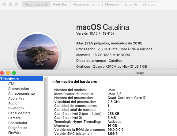

I can also confirm it works on iMac 11,2 upgraded with Quadro metal card
A couple of notes on the install process:
- I had to boot on Catalina Loader in order for stage 2 (OTA pre scripts) to work, and later chose the "Install Macos" partition, otherwise I got forbidden symbol.
- Have to install dosdude post install patches right after stage 3 reboots, or the systems gets unbootable (boot loop) on stage 4.
About this install, today I noticed it wiped my Windows UEFI boot from the EFI partition, making my Windows 10 unbootable (It doesn't show on the boot picker). I can't be 100% sure this install was the culprit, but I can't think of something else I've done that could delete the EFI windows folder.
Anyway, I'll take a closer look on next OS upgrade to confirm this.
If someone happens suffer the same missing EFI windows boot, here is a quick and easy fix that worked for me.

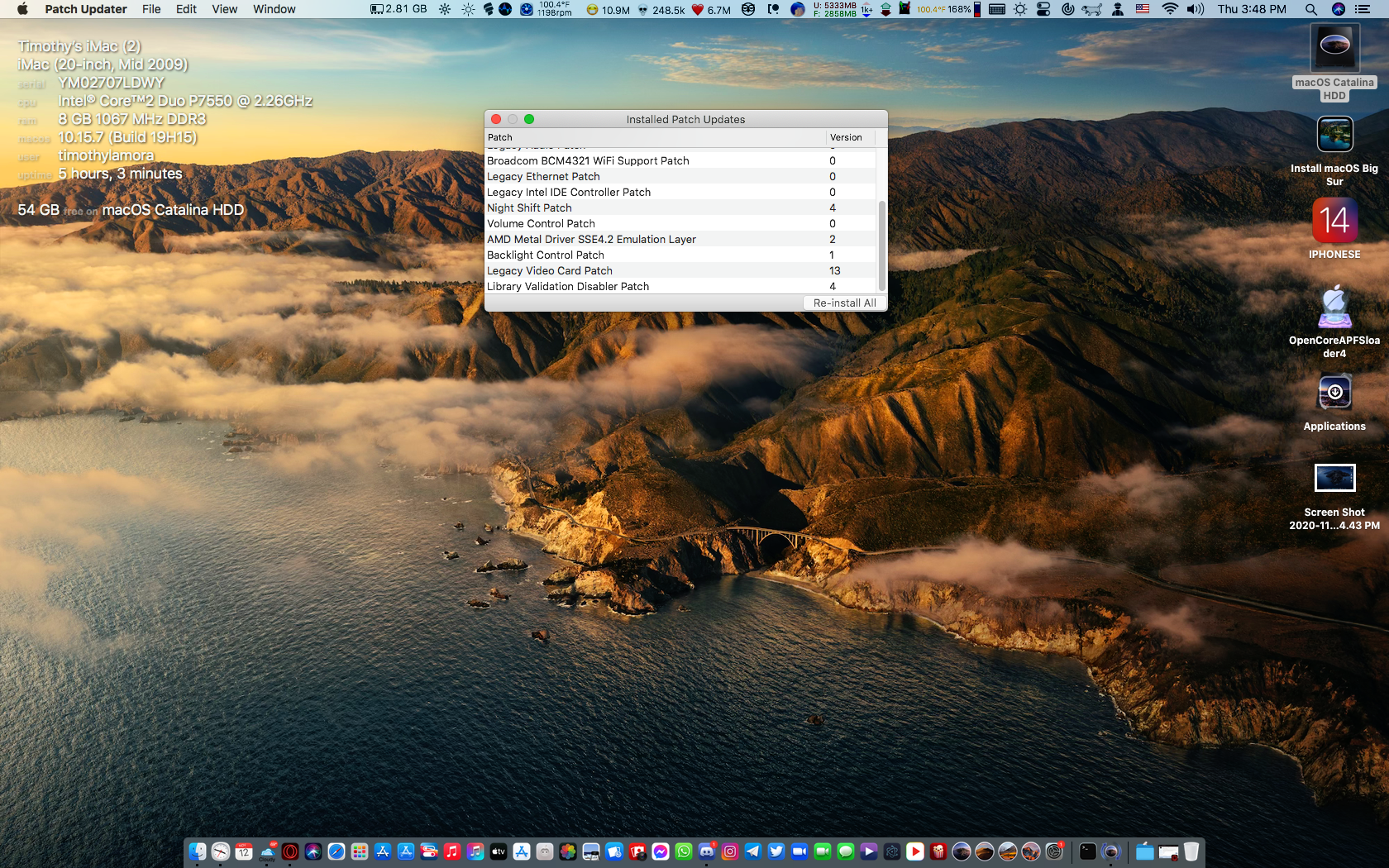

You can check the patch updater in /Applications/Utilities folder make sure you have the Library Validation disabler patch installed. 2 when you open etc an app like Microsoft Word and error message pops up do not close the error message close the app and re-open the app then once the app is open close the error message. # check your nvram-p settings you might meed nvram boot-args="-no-compat-check amfi_get_out_of_way=1"
Reactions: Sorsiwel and K two

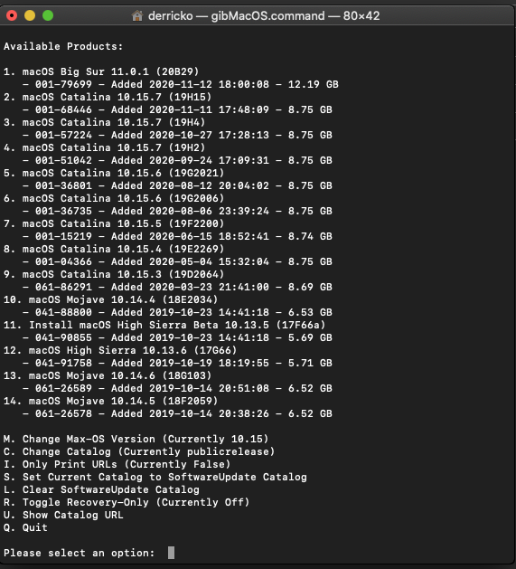

I'd bet its the old version. I'm still downloading the Catalina installer 15.7.02 which is exactly the same as the September 30th version, the last time this got touched on Apple's servers. The file size is the same too. It looks like updates will happen through software update until someone at Apple finally gets around to making a full download version.
I just launched gibMacOS-master and it shows that 10.15.7 (19H15) was added on 11/11/20.

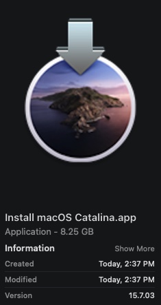

Full Catalina 10.15.7, build 19H15, installer 15.7.03 is now up. Just downloaded it using-
gibMacOS-Master folder on GitHub
Worked for me as well. Only thing I noticed that Apple didn't ask things like "do you want to send error reports and anonymous data" when the system boots up for the first time after the installation has finished. Had to reapply the patches manually from the patchupdater and amfi get out of my way. Now everything seems to work fine. No probs with iCloud or anything else.

Can also confirm https://github.com/corpnewt/gibMacOS worked perfect to build the H15 installer. Took about an hour to D/L the components and assemble the latest full installer into the ƒ. Made the USB patcher w/ v.1.4.4 successfully.

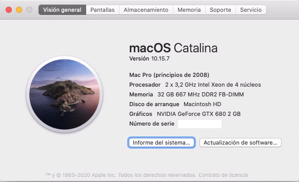

Hi all,
just guessing if there is someone running Catalina on a Mac Pro 3,1
I'm at the end of the road with Mojave, due the newest Final Cut updates are made for Catalina 10.15.6+ and this is my main app.
Would you tell me about it, please?
Do you recommend Catalina on Mac Pro 3,1?
Thank you all
If you need it, sure. Runs as smooth as Mojave in my Mac pro 3.1. One thing you must know: some graphics cards lose the Displayport out in Catalina.
Thanks for answering.
I have installed a NVIDIA GeForce GTX 680 2 GB. Will work?
Not at all, if you want to use the displayport. I had to install a DVI to displayport adapter for keep using my Led Cinema Display.

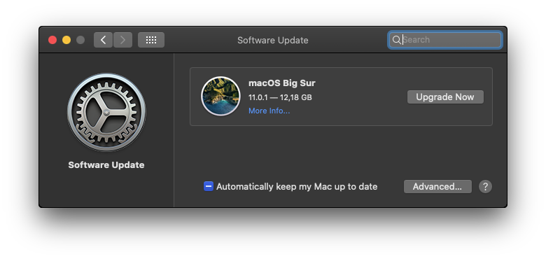

Is it okay to change the the device identification id on Catalina to trick my MacBook Pro 7,1 into a something like a 9,1. My mine reason for this is so the Big Sur update notification goes away.
Reactions: TimothyR734
I still want it to load the Kexts for everything related to that machine. So I have graphics acceleration and sound and everything else. If not is there an other way.
Okay, so I downloaded H15, how does one build an installer? I've never done that before.
Never Mind again... I figured it out...
Thanks for your help TomothyR734. I did everything you suggest. The problem persists but it looks like it is less frequent than before. And only Chrome and Microsoft Office apps crash (once in a session). So it's not a big deal. The other 3rd party apps I have (like Matlab 2020, Maple 2020, Firefox, Texstudio, ...) work like a charm. Kind regards.
For me this is the command that has helped. No crashes at all anymore:
sudo nvram boot-args=amfi_get_out_of_my_way=0x1
