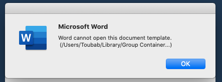

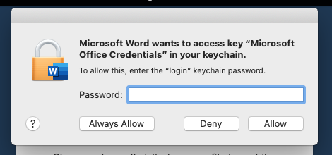

MS Office 2019 issues on a MacBook Pro 13" late 2011 with OS X 15.7 (installed through Catalina Patcher)
After re-installing MS Office two times already I'm running constantly in an issue with MS Office, that is just annoying. Whenever I start an Office app - mostly Word, PP or Excel - I am being asked to enter my password, e.g. "microsoft Word wants to access key "Microsoft Office Credentials" in your keychain." I enter my password, hit 'always allow' but I'm being constantly asked again the next time I'm going to open Word or any other Office app.
After this, I get the information: "Word can not open this document template. (Users/myusername/Library/Grup Container...)" which I can confirm with OK.

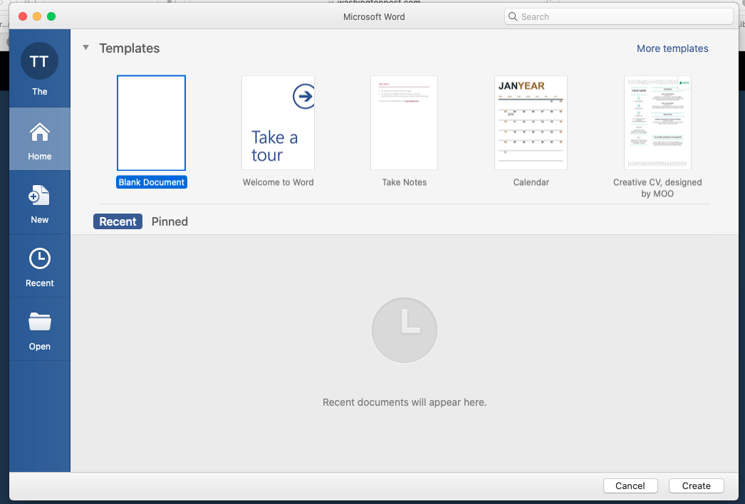

Being then in the Word menu there are no recent documents shown - nothing. It just says "Recent documents will appear here."
The same goes for all other MS Office apps. I'm running the latest version (Word 16.43 (20110804) and I use a volume license from my company.
Any help would be highly appreciated since the issue has most probably something to do with the patcher or 10.15.7. However, I couldn't find anything via google. :/

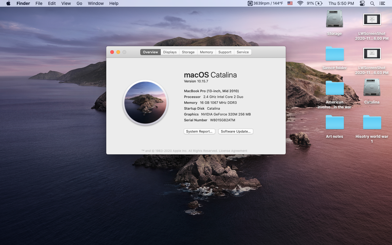

Oh and they said it couldn't take 16gb of ram it does. 512 GB SSD and 16gb of ram runs just as well compared to a 2012 that got Catalina as the last update. Even though the graphics card is a NVIDIA 320m and the core two duo. The core two duo is actually not as bad as people make it seem to be.
Reactions: TimothyR734
I can play most 1080p videos on it. I would say that if you want the best performance as far as video use Vlc player. Firefox usually runs a bit better than safari but the nvidia 320m is good enought compared to a Intel hd 3000 that came out a year after the NVIDIA 320m did. Performance is better in some areas compared to some Intel HD cards.
