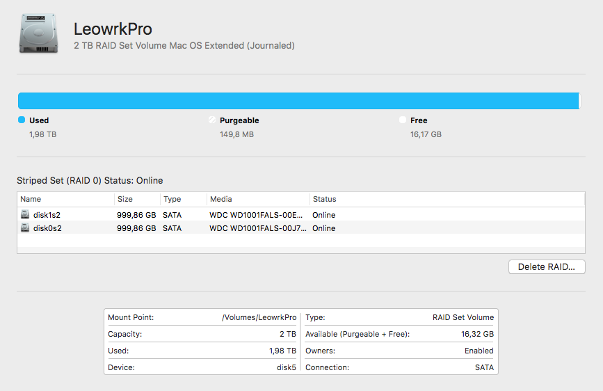

Hi guys! I have a MacPro3,1 machine with Sierra 10.12.6 installed on a SSD and a software RAID 0 (for data only) with two WD Black drives created with Disk utility long ago (in Snow Leopard IIRC). Works fine till this day.
If I upgrade my SSD to Catalina will this RAID still work? Do I risk an array breakdown or data loss (I do have a backup). Thanks! :)
View attachment 1692266View attachment 1692267
Software RAID disk information is stored in the disk partitions used for the RAID, not in the OS, so it will continue to work when using newer (or even older) macOS versions. All you have to do is make sure all partitions used in the RAID are connected. If one of the partitions is not connected, it will not mount.

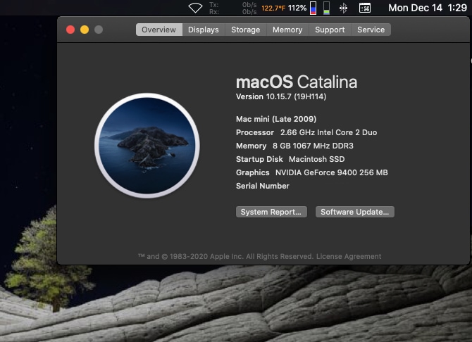

Updated my MBP5,2 to 10.15.7 (build 19H15, version 15.7.03).
MDS for download, make full installer app from it, use @dosdude1 's patcher 1.4.4 to make a bootable USB installer.
Install with it over 19H2. Apply patch updater for Library Validation Disabler Patch as proposed, and for re-installing Night Shift Patch.
Catalina 19H15 running as smoothly as 19H2. Thanks dosdude for the excellent and lasting results of your work.

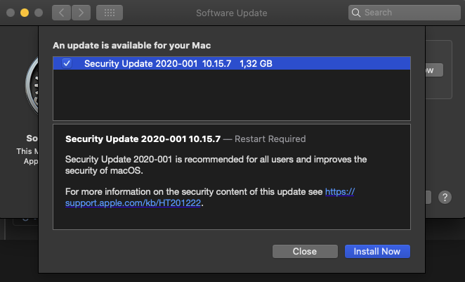

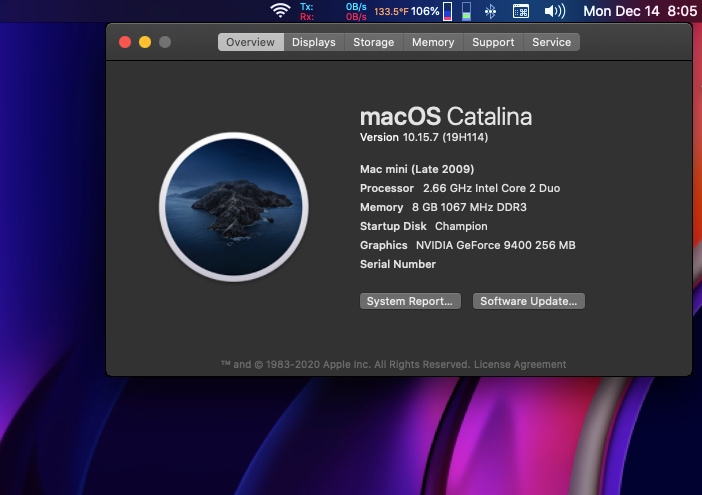

On MBP5,2, updated 10.15.7 supplemental (19H15) with the security update (19H114).
Updated OTA with jackluke's CatalinaOTAswufix.app:
- first SoftwareUpdateFix to see the update under SystemSettings->Software Update
- then while loading, OTA update fix; start installation when loading finished
Let installation complete, then boot USB bootable installer made previously with dosdude1's patcher 1.4.4 from 19H15, to apply the post-install patches proposed for MBP5,2.
Running smoothly.
Thanks to jackluke and dosdude1!

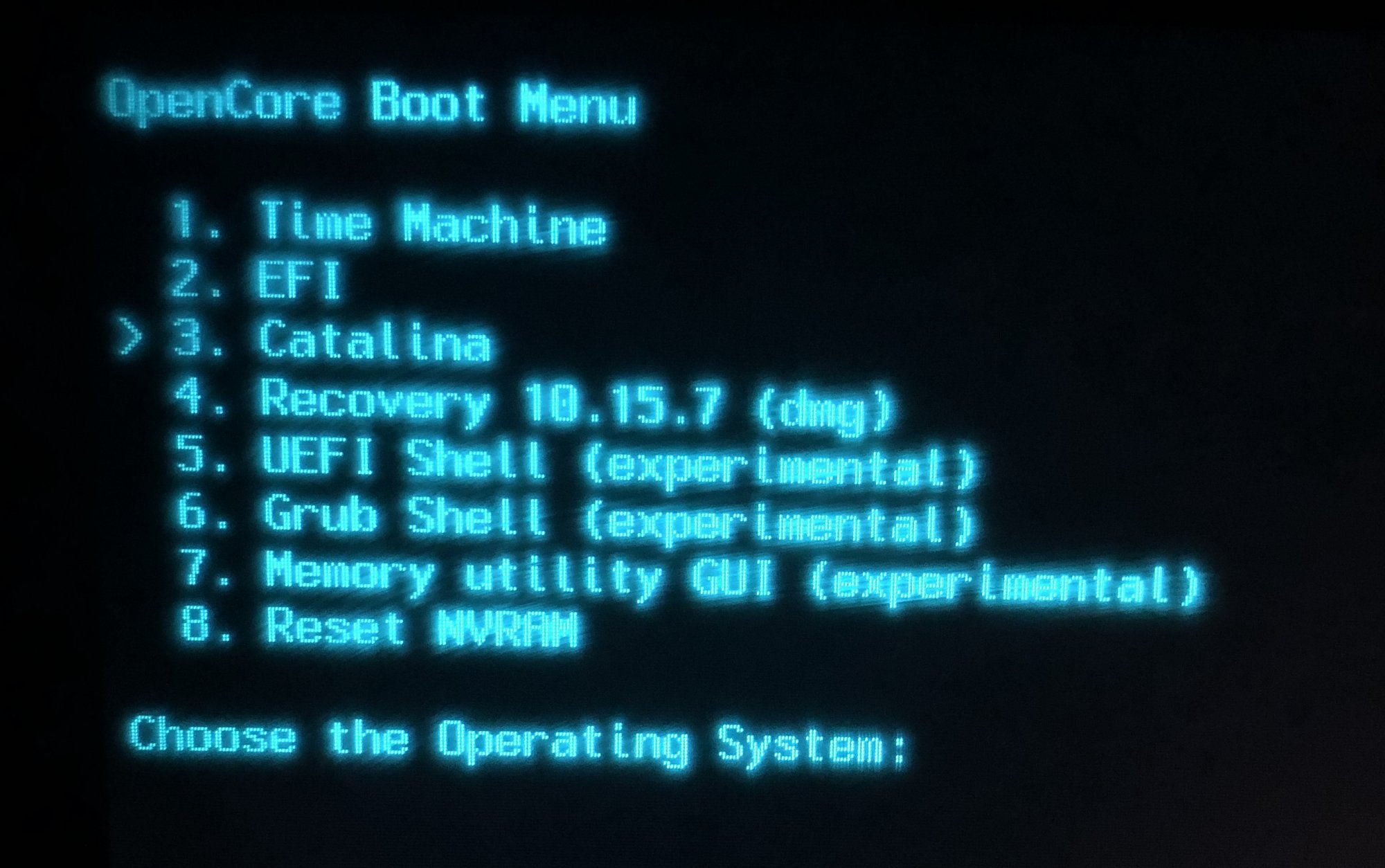

Additional step - Since this Mini3,1 is "barefoot" (unpatched ROM) had to employ @jackluke's OpenCoreAPFSloader3 booted from USB to see the second part of the Security Update to complete the installation. Works perfectly.
Can’t see the second stage even with OpenCoreAPFSloader. I don’t get it why?
Here is my process which part am I doing wrong;
First click SoftwareUpdateFix then
Open SystemSettings->Software Update and start downloading the Security Update
Approximately after 600MB Download click to OTA update fix;
When finish the download click restart
After chime press Option key choosing open core bootloader but no second stage there. So which part is wrong? Thank you.

Only OpenCoreAPFSloader3 can see the installer. Other versions lack necessary support. Here's the other Mini3,1 completed.
The installer second-stage was item C on the list. YMMV
Are you mentioning this version, right?
Reactions: K two
OpenCoreAPFSloader3 dated Nov.6, yes, sir.

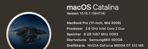

@telepati I managed to install the 19H114 update in my macbook pro 4,1 in an hybrid and strange manner :D
Here what worked for me:
1. Prepared a usb bootable with Opencoreloader v3
2. Downloaded the update from software update (do not restart), download it all
3. Show package content of the CatalinaOTAswufix.app
4. Navigated to Contents/Resources/Script and opened file catalinaswuOTAfix.command with textedit to see commands
5. Opened a terminal and issued the following commands (manually), I don't know if all of these are mandatory, but I'm describing exactly what I did (SIP disabled):
Code:
sudo mount -uw /
killall Finder
sudo nvram boot-args="-no_compat_check amfi_get_out_of_my_way=1"
diskutil mount Preboot
sudo perl -i -pe 's/>-no_compat_check/>amfi_get_out_of_my_way=1 -no_compat_check/' /Volumes/Preboot/*/Library/Preferences/SystemConfiguration/com.apple.Boot.plist
sudo defaults write /Library/Preferences/com.apple.security.libraryvalidation.plist DisableLibraryValidation -bool true
sudo defaults read /Library/Preferences/com.apple.security.libraryvalidation.plist
Macmid="$(sysctl -n hw.model)"
Macmidswap='s/\'${Macmid}'/MacExample7,0/'
Boardid="$(ioreg -l | grep "board-id" | awk -F\" '{print $4}')"
Boardidswap='s/Mac-9AE82516C7C6B903/\'${Boardid}'/'
OTAdist="$(ls -l /Library/Updates/*-*/*-*.dist)"
OTAinstallcheck='s/var\sboardIds/return\ttrue;\tvar\tboardIds/'
sudo perl -i -pe ${OTAinstallcheck} /Library/Updates/*-*/*-*.dist
6. Restarted the os with the bootable usb with opencoreloader inserted, pressed option and booted from the usb into opencore (you will notice now "macos installer" in the list, next to the opencoreloader, but if you click on it --> prohibited symbol)
7. Chose from opencore picker "macos installer"
8. Installed the update
9. 1st reboot: booted again into opencoreloader and chose my hd to complete the installation: it booted to my desktop without dosdude patch
10. Rebooted, patched with dosdude as usual and chose macintosh-hd as startup disk from dosdude usb
....I don't know why the CatalinaOTAswufix failed to patch....
This time, looking at the script, it didn't enter the loop to execute all the above commands.
The if condition, which seems false this time, is:
if [ -e /Library/Updates/*-*/*-*.dist ]
Reactions: telepati and K two
