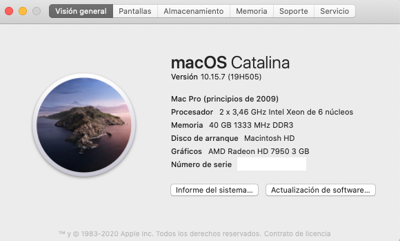

Wow all Security update run fine with this method on my MacPro 3.1 now i've 19H505....Merry Xmas

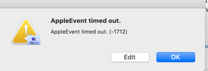

Good evening and merry Xmas to all. Having time to spend on it, I tried to update my old 2008 iMac (8,1) form macOS 10.15.6 (19G73) to macOS 10.15.7 with newly downloaded patcher and Installer. Everything seems to work normally, but after reboot I'm again on macOS 10.15.6. I tried to update in both ways: booting form internal drive and launching installer or booting with USB flash drive, but in both case Install seems to went well but with no results. Did anyone other have the same issue? Is there some workaround to update the computer?
How did you get 19H505? Are you running developer beta updates?
Updated again in the beta channel. 19H505 installed like a charm...

It seems homebrew compiles packages on newer hardware. youtube-dl with python 3.9 from homebrew crashes on illegal hardware instruction. You have to use the official python.org build instead. (Also don't forget to run `Install Certificates.command`)
