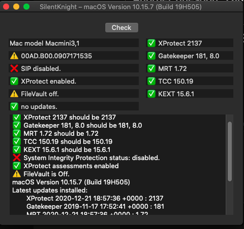

No Recovery Mode. USB patcher the only option. NVRAM reset does not re-enable SIP. SilentKnight accurately reports SIP status, FWIW

Just triple-bonged this Mini3,1 w/NVRAM reset and SIP is still disabled. Reset NVRAM w/OpenCoreAPFSloader3, same result.
