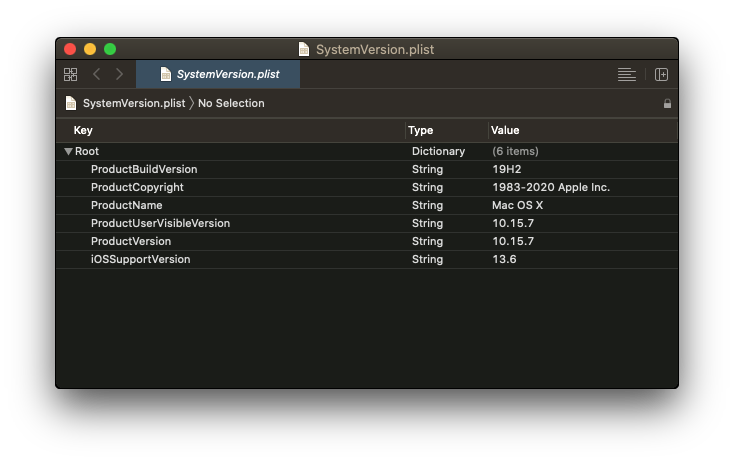

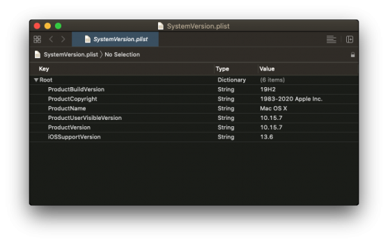

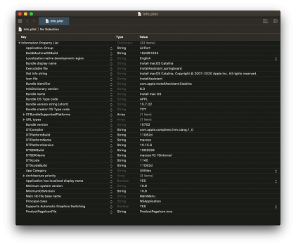

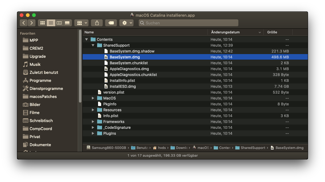

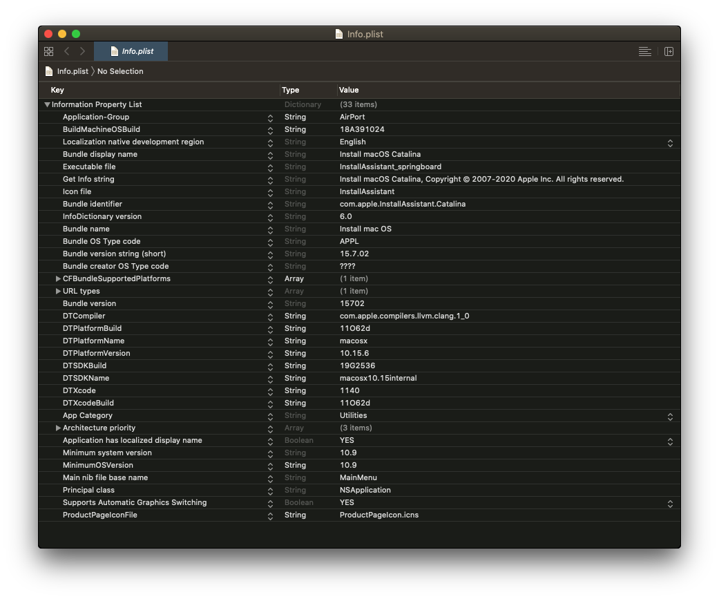

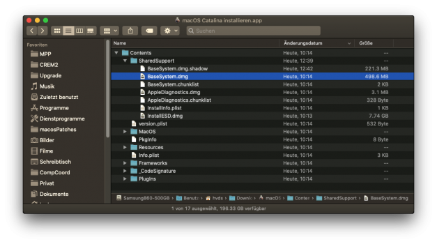

(according to post 1; is there a way to see the build number from the downloaded installer app without installing? I see the build number of the system used to build the installer, in DTSDKBuild).
EDIT: sorry for the noise, found this via Google -
- locate BaseSystem.dmg in the installer app's Contents/SharedSupport and open with double click
- look at macOS Base System/System/Library/CoreServices/SystemVersion.plist
I put this here for my future reference.
Unless there is an easier way...

Just checked, patcher 1.4.4 downloads installer version 15.7.02 which is 19H2

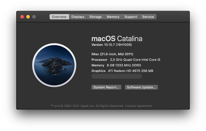

First, I would like to thank @dosdude1 and @jackluke for their incredible work and continuous support helping running a newer system on unsupported hardware.
I have a mid-2011 iMac (imac12,1) with a Radeon HD 4670 (it is enough for not having graphics glitches and transparency works) running 19H2, minus AirDrop (Atheros WiFi) and other stuff that relies on Bluetooth BLE. Even Apple TV video was working somewhat. I also applied @highvoltage12v fixes for QuickSync/SandyBridge (maybe it helped with Apple TV, I am not sure). Then I tried to use CatalinaOTAswufix and it seemed to have applied the latest Security Update (2021-02-03 / 19H1009), but then entered boot loops even after re-applying Catalina Patcher post install patches. I could load Catalina in Safe Mode tho, so I re-applied QuickSync/SandyBridge fixes and I could boot back in normal mode. Patch Updater did its magic and I also used SilentKnight to update MRT. Maybe this helps someone else with trouble updating.
Thanks a lot again. Regards.

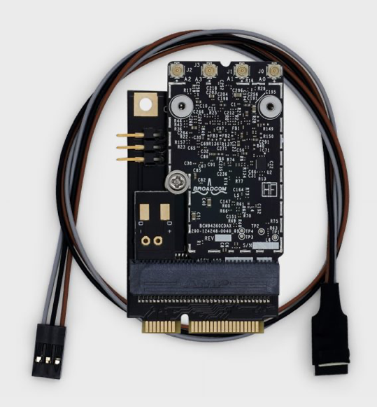

Has anyone with a Late 2009 iMac 27 w/ i7 successfully upgraded the WiFi card from G to AC?
I've found an upgrade kit online, but at $159 it seems rather pricy for what it is.

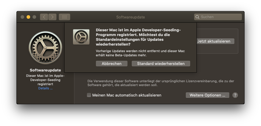

According to jackluke #10,268 :
disabling beta settings in the softwareupdate prefpane should then show the public-release updates only.

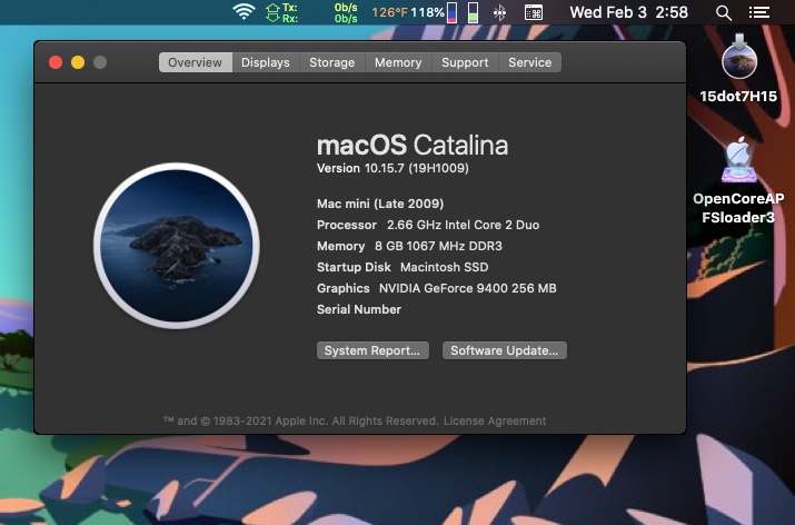

MBP5,2 is now also on beta security update 2021-002 (19H1009), on external SSD.
Used CatalinaOTAswufix to find and patch the update, OC4b to boot macOS installer (needed for installation on USB target for legacy USB machine), Patcher 1.4.4 for post-install patches with forced cache rebuild. Then in Catalina Patch Updater to redo Library Validation Disabler and Night Shift patches, and SilentKnight for MDT, Gatekeeper, XProtect updates.
Thanks to you dosdude1 and jackluke, and the continued support provided by your tools, my MBP5,2 is running very well with Catalina. No need for a better machine for 1-2 more years.

Mini3,1 upped to 19H1009 from 19H512 w/CatalinaOTAswufix a few days ago at #13,556 and concur w/@zfrogman's assessment. So far, absolutely no issues. Security Betas have been very solid. This may be the best Catalina V, yet. YMMV
