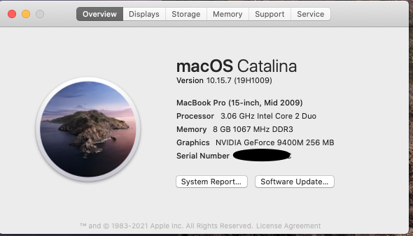

Successfully updated my MBP mid 2009 5,3 to 19H1009
I had to use the CatalinaOTAswufix and USBOpenCoreAPFSloader3 as it wouldn't update without the USB, then did the dosdude1 patches and all is good
Thanks to dosdude1, jackluke and K two for your apps and advice Screen Shot 2021-02-07 at 11.06.20 AM.png

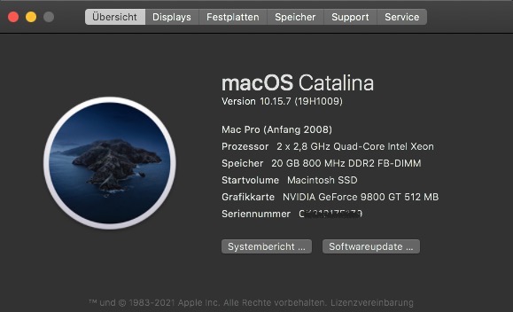

Unfortunately, the OTA SW Update Fix is not working for me. I've did both software update and OTA patches. The update 2021-001 is offered after performing the patch, but it does not install properly. It downloads, then reboots and installs it for 10 minutes, but after that the version is still at 19H2 and the update is still offered and available for installation. I tried it now multiple times and also deleted everything in /Library/Updates, but still same result.
Has anyone some hints for me?
If you end up with the same build as before (19H2) you missed the 2nd stage installer phase.
Re-do everything but hold ALT key during reboot - and select the "Installer" drive instead of your primary boot volume.
Then let the 2nd stage do its deed.
Worked for me flawlessly.
Edit: I assume that your machine is already ROM-patched for APFS? Otherwise it´s a bit more tricky to select the right boot volume.
Reactions: K two
Yes it is
Thanks, and from what build did you update this to? (Asking because I tried from 19H512 and screwed up completely, instable and crashing Finder afterwards).
Edit: Did it again starting from 19H2 and this time it worked as intended. So either a one-shot mishap when I did the 2021-002 update starting with 19H512 or (unlikely) there could be some problem with that update combination.
