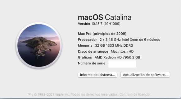

Reactions: K two

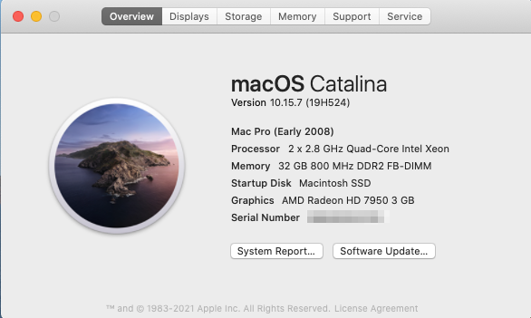

Successfully updated my MP3,1 to 19H524 just a few moments ago. Took about 20 minutes, including running post-install patches.
Reactions: K two

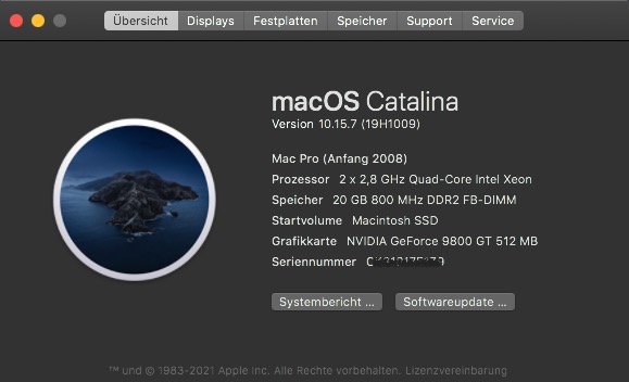

H524? on the release channel? Had H525 for awhile, now H1009 on Beta channel which runs flawlessly, btw.
Yes, release channel. According to Apple, H524 for Catalina was just released as a supplementary update yesterday (9 Feb). Not running Dev at the moment.
Reactions: K two
