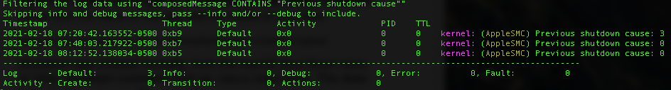

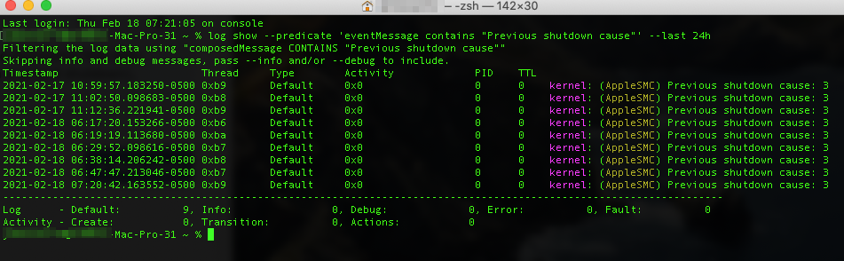

Running DosDude's patched 10.15.7 19H524 on my MP3,1 and discovered that after every normal reboot, shutdown cause code shows as 3 (which is a hard shutdown), rather than 5. Anyone else seeing this?
This is weird. After resetting SMC, rebooting or shutting down now returns a code of 0 instead of 5. Something strange is going on...
Can anyone else with an MP3,1 see if they're getting similar results? I'm wondering if there's an actual issue with hardware, or if the patched OS is just misreporting the shutdown cause?

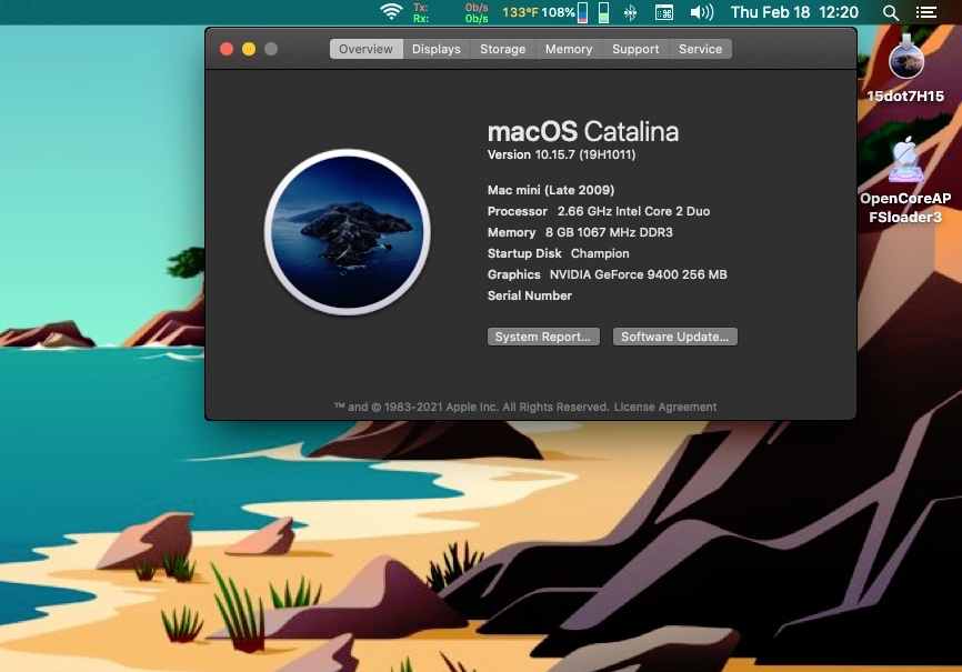

How does 19H1011 run?
My observations so far, still testing, compared to 19H15
+overall snappier
+ loading faster after restart
+nasty bug from 19H15, where applications wouldn't open or need several attempts to open, is gone!
+had to re-install Lulu, System Extension was being blocked by MacOS, running smoothly after re-install
--Time Machine stopped working, can't get it to run. Really nasty!!!
+overall snappier
MRT was 1.62 had to update to 1.73. The Library Validation Patch wanted to update. Now, no issues whatsoever. Lower overhead than 19H524, as well. Video smooth at full resolution.
To get TM working, try running Onyx/Maintenance, the default settings are fine. After the app restarts , restart, again.
