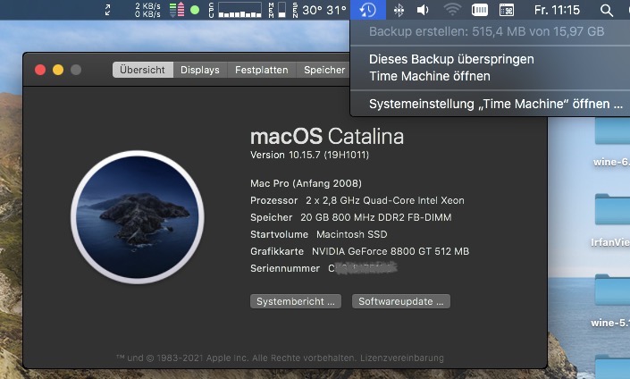

I did as per your advice, unfortunately Onyx Maintenance didn't solve the TM problem.
Would you know, what can try next? Apple support docs are dry.
Reactions: K two

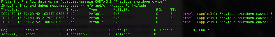

This is weird. After resetting SMC, rebooting or shutting down now returns a code of 0 instead of 5. Something strange is going on...
Can anyone else with an MP3,1 see if they're getting similar results? I'm wondering if there's an actual issue with hardware, or if the patched OS is just misreporting the shutdown cause?
Can anyone with an MP3,1 please enter log show --predicate 'eventMessage contains "Previous shutdown cause"' --last 24h in terminal and let me know what is reported as far as shutdown cause?

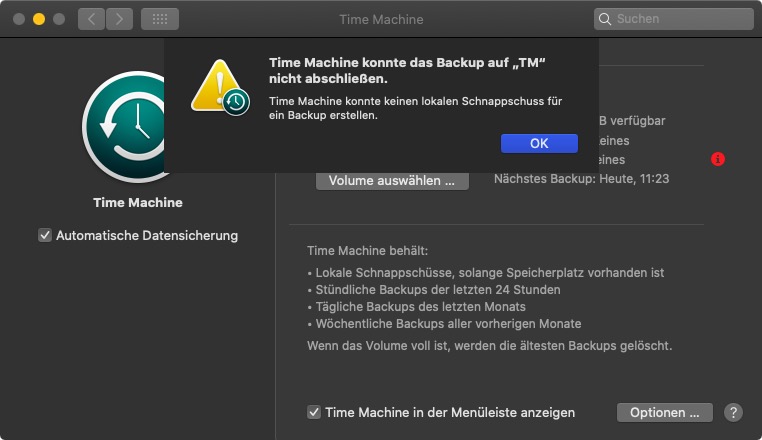

Steps I took so far unsuccessfully:
--reformatted the external USB
--tried other external USB HD of different brand
--tried spare USB HD of identical brand
--Onyx/Maintenance
--TM System Prefs On/Off including restarts
--resetting SMC(PRAM)
This error message is what I get, see screenshot, translated: Time Machine couldn't make a local snapshot for a backup
Maybe a terminal command will do the trick?
Your help is highly appreciated K Two!

How much free space do you have on your start volume?
Might not be enough to prepare for the local snapshot.
Also related: Turn off the local snapshots or delete them altogether...
See here.

Hi Larsvonhier, my SSD has 128GB, used: 68GB, free: 38GB
Onyx and Terminal (via tmutil listlocalsnapshots /) show an existing snapshot, and in Onyx I can make local snapshots, which are then congruent with the listing from Terminal.
The mentioned program from the Apple Support discussion suggested, Time Machine Editor, does not have any effect.
What can be done to resolve the TM problem, if you have any suggestions, I'd be glad to implement.
