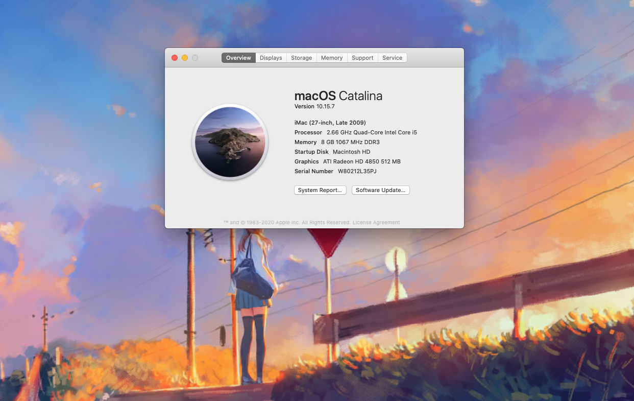

I'm posting this from a 2009 iMac and seriously, it's great. This is the 11,1 model but it has the ATI 4850 graphics, and I didn't realize at first I could install it on this machine because of the dire warnings for ATI 5x/6x owners. The 4850 being even older, I figured it wouldn't support acceleration either. So I've been pleasantly surprised. I've seen absolutely no performance hit vs High Sierra on the same hardware.
Anyways screenshot for bragging rights. If this remains a stable system in a couple of weeks I might patch my writing laptop too (it needs to not break, the iMac is more a convenient extra machine we have, it's allowed to break).
Kudos to dosdude1 and crew!

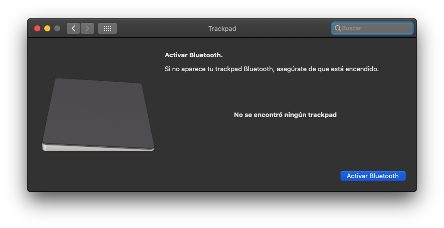

Hi, thanks so much for the great job creating the install patch, the catalinaotasufix and the USBCoreOpenAPFSloader.
I just updated my macbook 5.1 to Catalina 10.15.7, I had a problem with an infinite reboot loop but it was solved by clicking on the rebuild cache option that appears after installing the post-install patches of dosdude1.
Everything works perfectly in this update so far except the trackpad, it is not recognized in the preferences panel. I saw that there was a trackpadmb52.prefpane.zip file by @TimothyR734 , I would like to know if that same file could work for my macbook 5.1 or if a modification is necessary.
Thanks for help.
Reactions: K two
Thanks for help.
Has a SMC reset been performed? The trackpad is on the USB bus.

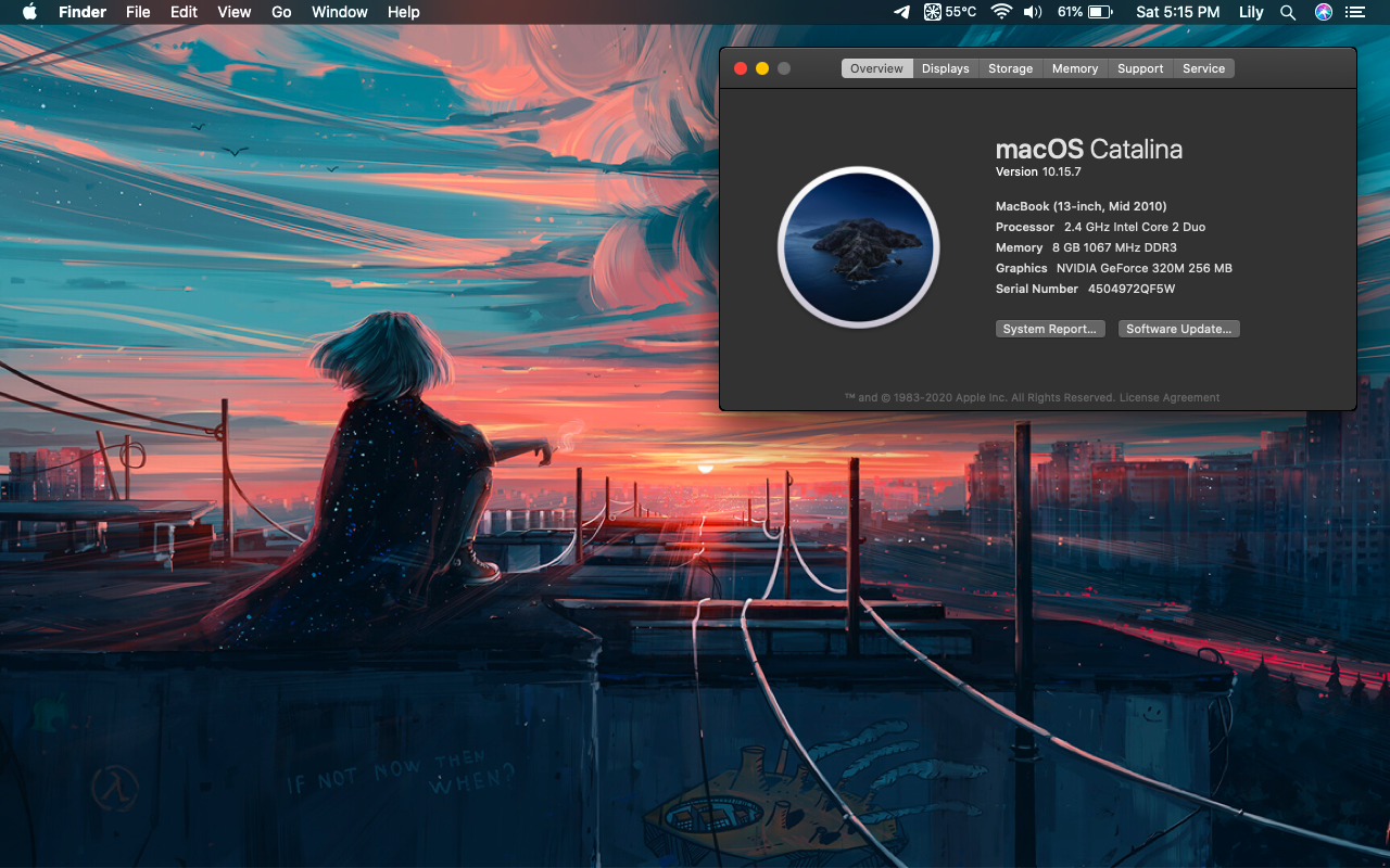

Heck with it, did the laptop this morning. No regrets. So far, AirDrop crashes Finder when you select it, and iMovie 10.x won't run. Nothing show-stopping for a writing computer.
