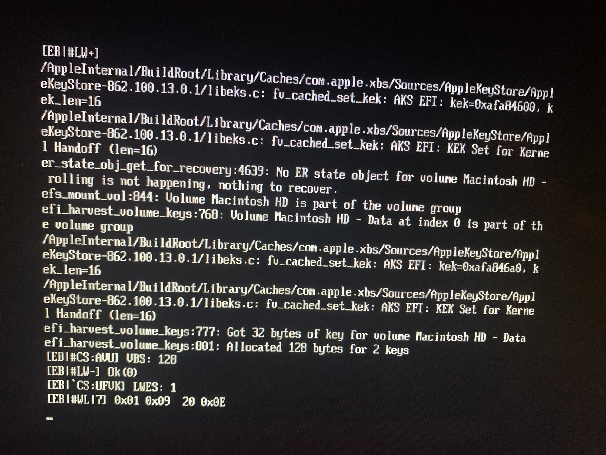

After installing Catalina on my late 2008 MacBook Pro, I’m stuck on the screen below. This happens after selecting my user and entering my password. I installed Catalina over an existing install of High Sierra. What do I do from here?

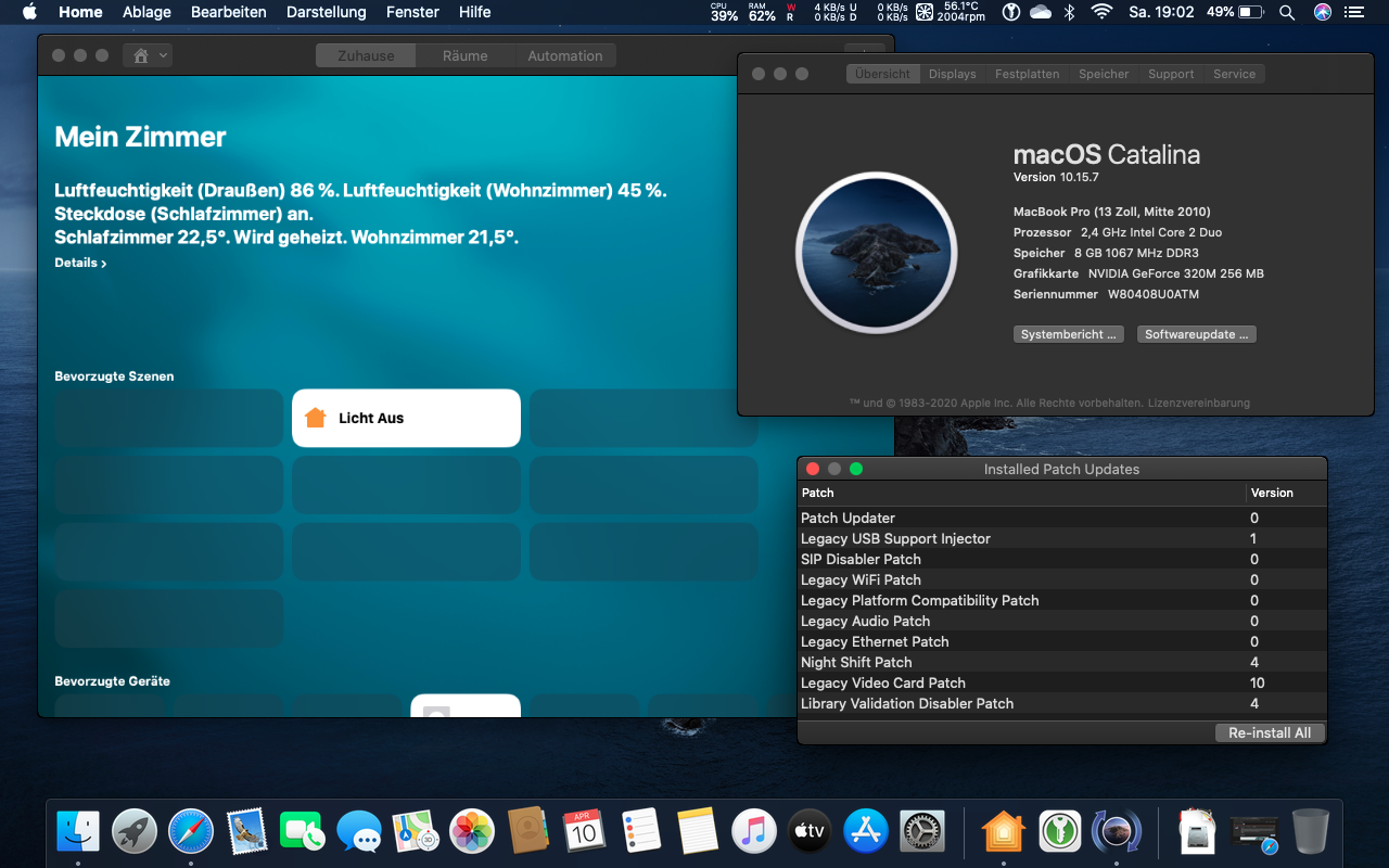

Hey guys,
I was checking out the Home Application a few hours ago and there seems to be some issues with showing the stuff. As long as the Devices/Scenes are turned on, everything seems to work properly. But if a device is turned off, I only see a shadow of where the button should be. Anyone ever noticed or had that issue? A workaround to fix that? For me it seems to be a graphical issue. I have attached a screenshot below.

Hey guys,

Same here. In a Macbook Pro 17 2011. I think its because of the integrated GPu.

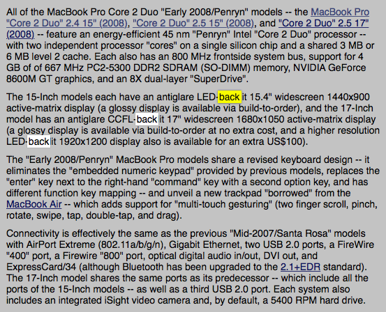

Interesting. Because all machines I encountered divided into CCFL backlight for matte screen and LED backlight for glossy ones. The CCFL cannot be controlled by F1/F2 keys out of the box and not even with latest dosdude1 patches. There was some additional pre-release patch from dosdude1 that could be applied (he made it available for testing during early 10.15 or even late 10.14 days). Then somehow lost interest in the patch, despite feedback from me and others that it still worked a long time. Only recently (10.15.4 I´d recall) it semi-broke and was only usable when no external screen (via DVI) was attached. Otherwise you´d encounter a login-crash-login-loop until the external screen was detached.
I didn’t know of a distinction between matte and glossy, one having CCFL backlight and others LED. I thought that all early 2008 models got the LED-backlight treatment. Ahh, now I remember that there was a special dosdude-patch for the 17inch model which had problems ’cause of its CCFL backlight.
Just looked here https://everymac.com/systems/apple/...-pro-core-2-duo-early-2008-penryn-models.html
Partial screenshot of that page:
It´s not because of the integrated GPU, but because of the GPU that´s integrated. (Small pun for non-mother tongue speakers).
In detail: On machines with non-metal capable GPUs (intergrated or discrete) we have to rely on the OpenGL framework patches to make the GUI shine as well as possible. Some apps rely on the metal framework and have not been patched (like Zoom i.e.) to run on OpenGL as well. In some cases you´ll crash the app, sometimes rendering is missing stuff (home app, newer iMovie etc.), sometimes color schemes are amiss (maps renders satellite images too dark).
As long as we do not get the previous apps running on current macOS or just use the old ones (iMovie) or someone finds a patch to the apps or the frameworks they rely on, we have to live with that. Only in Mac Pro and some iMacs there is the solution to swap the GPU card with a metal capable one. All others might find fun in attaching an eGPU for metal - with varying results when mixed in operation with the internal MacBook GPU.

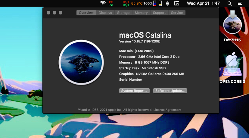

I updated yesterday as well. Went the same way as the previous post I made. It froze part way and had to shut down, then did patches, updates as well and all is good
