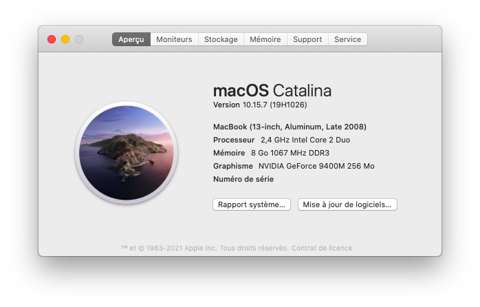

Hello to all,

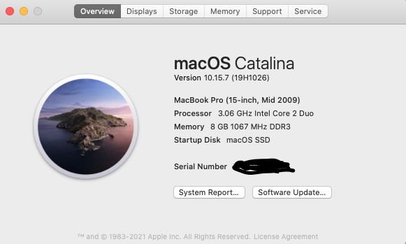

Reporting successful installation of latest (beta developer ?) supplement resulting in:
System Version: macOS 10.15.7 (19H1026)
Used method as described in post #13,956 on this page (see above)
I did experience a freeze after last reboot in the install process, however, resolved this by shutting down MacBook Pro by pressing (and holding) power button, then rebooting into the USB stick with dosdudes1's patcher, applying patches, rebuilding caches and restarting. Note, that it took several attempts before patches took hold. On few reboots patches were not active; I had to activate patcher updater (in utilities folder) before successfully patching, then rebooting the system.
All functions seem available.
I updated successfully as well to 19H1026. I also used Silentknight to update files needed as K two pointed out
And I also experienced a freeze after last reboot into the install process as well. And same I shut down, and ran dosdudes1's patcher, applied patches and rebuild caches.
After that no issues.

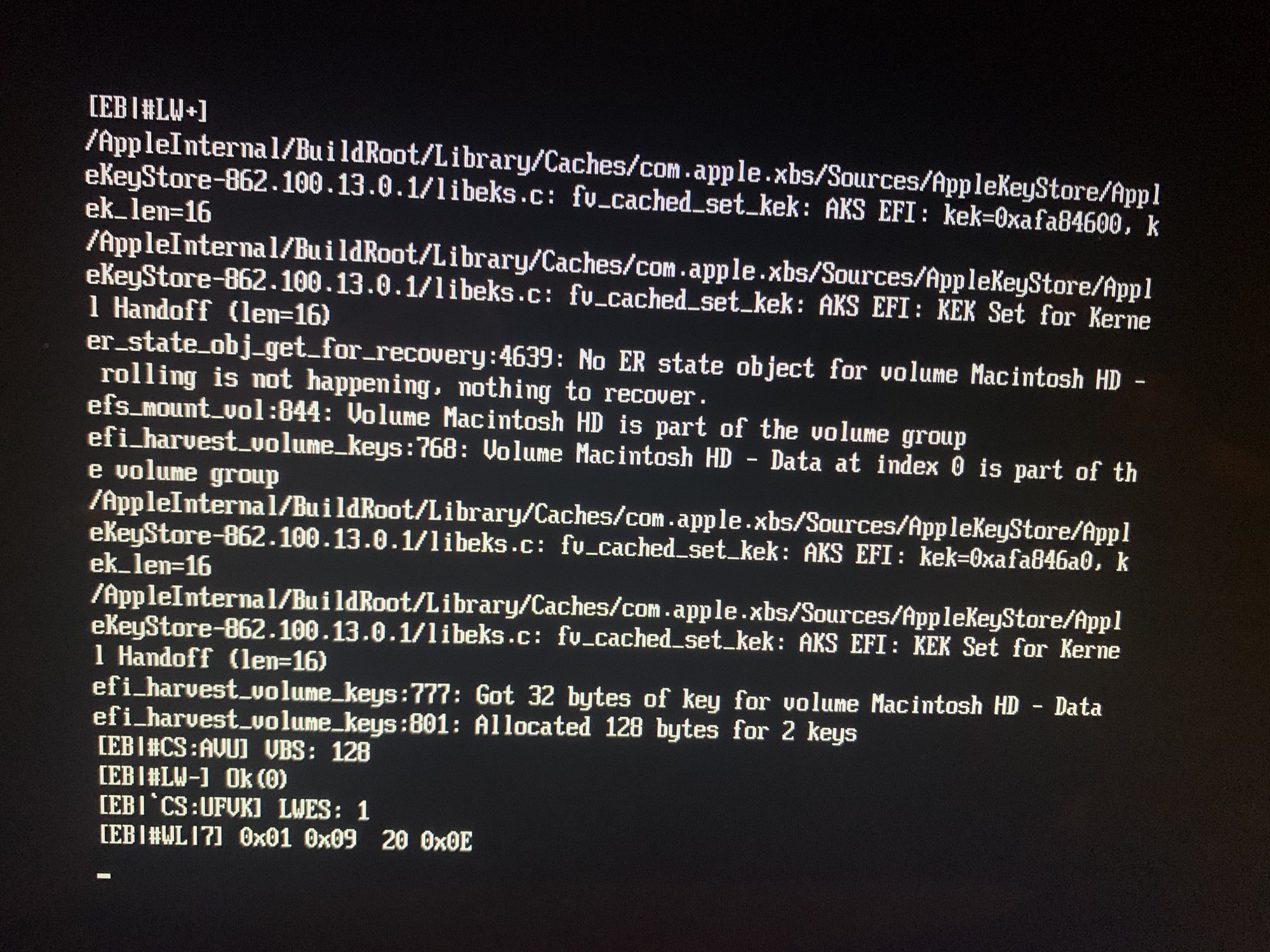

After installing Catalina on my late 2008 MacBook Pro, I’m stuck on the screen below. This happens after selecting my user and entering my password. I installed Catalina over an existing install of High Sierra. What do I do from here?
