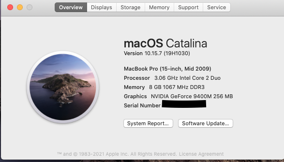

MBP8,1 (Early 2011) updated to 19H1030 using the methods described in post #13,956.
I also re-applied JackLuke's airdrop and continuity fixes after the update, and am still rocking handoff and continuity features on this 10 year old tank!
❤️❤️Upgradable MacBooks live forever❤️❤️

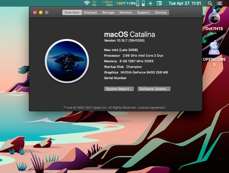

Very smooth update w/CatalinaOTAswufix.app, boot OPENCORE3b1 to see MacOS installer, re-install recommended v.1.4.4 patch set, Force Rebuild Caches, restart, temporarily opt-out of Beta updates to avoid the dreaded SU 2021-003 Beta, update MRT to 1.77 w/SilentKnight, update Validation Patch via Patch Updater, restart. Like a new Mac, now. ?

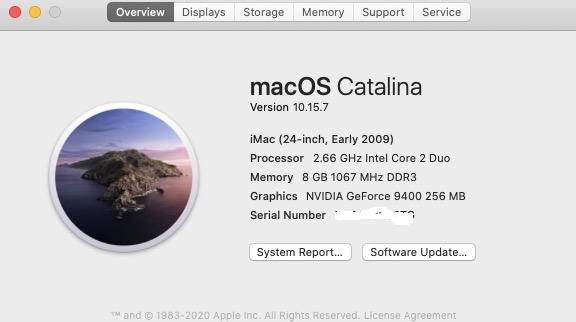

Hi all and thanks for all you do. I have been successful with updates (I think) but do not always get a system version number. Does anyone have any ideas why that is? Thanks.
